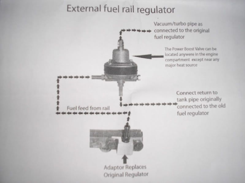

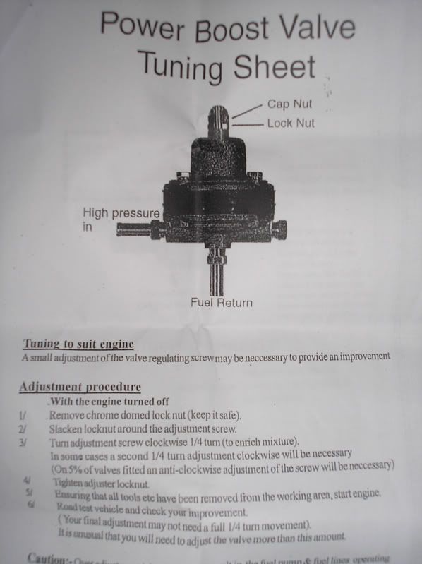

Glanza_Ragger Posted November 18, 2006 Posted November 18, 2006 as in an FSE fuel pressure reg? if thats what you mean ill post some pictures of my instructions up Quote
paul w Posted November 18, 2006 Author Posted November 18, 2006 Yeah thats it guys,pics would be good,would let me see if i got all the bits! cheers Quote
Glanza_Ragger Posted November 18, 2006 Posted November 18, 2006 give me a sec, ill snap some for ya Quote

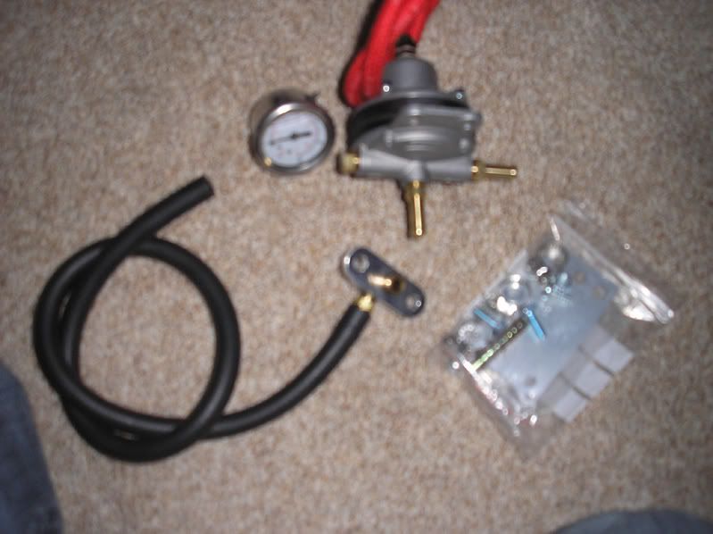

Glanza_Ragger Posted November 18, 2006 Posted November 18, 2006 excuse the shite pictures lol. my batterys in my camera are dead lol..you should have, the fuel regulator a gauge (depending if you purchased one or not obv)2 fuel pressure lines6 small jubilee'smounting plate + boltsand the toyota fuel rail adaptormight have missed something outta there, but yeah.any good ? Quote
paul w Posted November 18, 2006 Author Posted November 18, 2006 Thats the badger! Cheers bud,did that fuel rail adapter come in the box? If it did i aint got one in mine! Quote

Glanza_Ragger Posted November 18, 2006 Posted November 18, 2006 £85 off of dave burwash. picked it up today, along with ordering my fuel pump which will arrive wednesday as the company let him down for having it for me today. bit of an ass as i was going to slap them both on tomorrow, but whats another week without the car when ive been without it for a good 3 months now ..and my pills arent making up for the fun of driving my starbo and yeah paul, the fuel rail adaptor should come with the kit, if its a toyota specific kit. it may be a universal one you have purchased, which wont include one.you can find them on ebay though, or try phoning either dave up, or sumo power failing that.should be about a fiver for the adaptor. Quote
