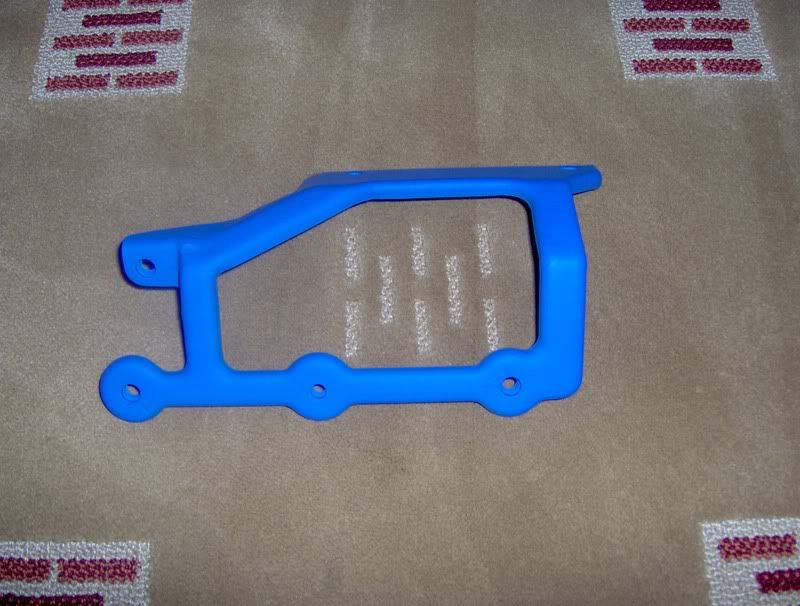

jon5698 Posted January 7, 2007 Author Posted January 7, 2007 Here is the rocker cover, broken bit and the intercooler mounting plate. Quote
Sparky Posted January 7, 2007 Posted January 7, 2007 I like that colour..... what is it?? woud look even better laquered!!! kinda reminds me of the colour i sparyed my BMX years ago Quote
jon5698 Posted January 7, 2007 Author Posted January 7, 2007 Its plasti-kote industrial hot paint HP-16 blue from halfords. It would have made a lot of difference for only about £15 thats including the new seals from toyota, if i didn't have to buy a new rocker lol Its plasti-kote industrial hot paint HP-16 blue from halfords. It would have made a lot of difference for only about £15 thats including the new seals from toyota, if i didn't have to buy a new rocker lol i don't know what the finished colour will look like because i have not baked it yet, my mam won't let me use the oven so will have to wait till she goes out Quote
Nanglebadger Posted January 7, 2007 Posted January 7, 2007 Damn thats nice!!!!!!!! I agree, laqured that would be sexual!Phil. Quote
