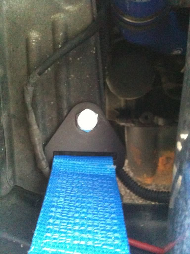

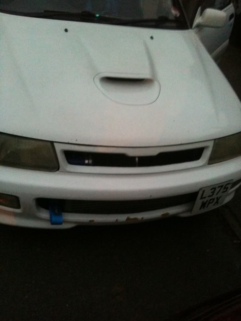

thats just left of my intercooler dude all i did was find annut
n bolt that fitted the strap , the hole was alredy drilled in the part of my car i connected it to :lol:
@naz and Lew :- I hope you both know the 1st time you try and pull the car on that pint its going to crumple out and potentially distort the slam panel ?
If your on track and you go into gravel no doubt youve both heard how easy it is to get stuck and dig in and most track hands do not give a flying f*ck about your car so will pull it, rip a hole/rip it off then just wrap it round slam panel and rag it out ! ive been at the recieving end of this tw@s at silverstone (track clio not starlet)
If i was using it to potentially tow the car id strengthen that point up or move it to a stronger area !!
