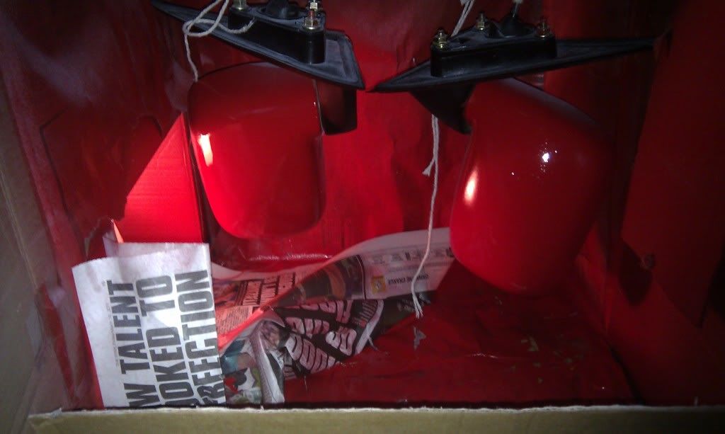

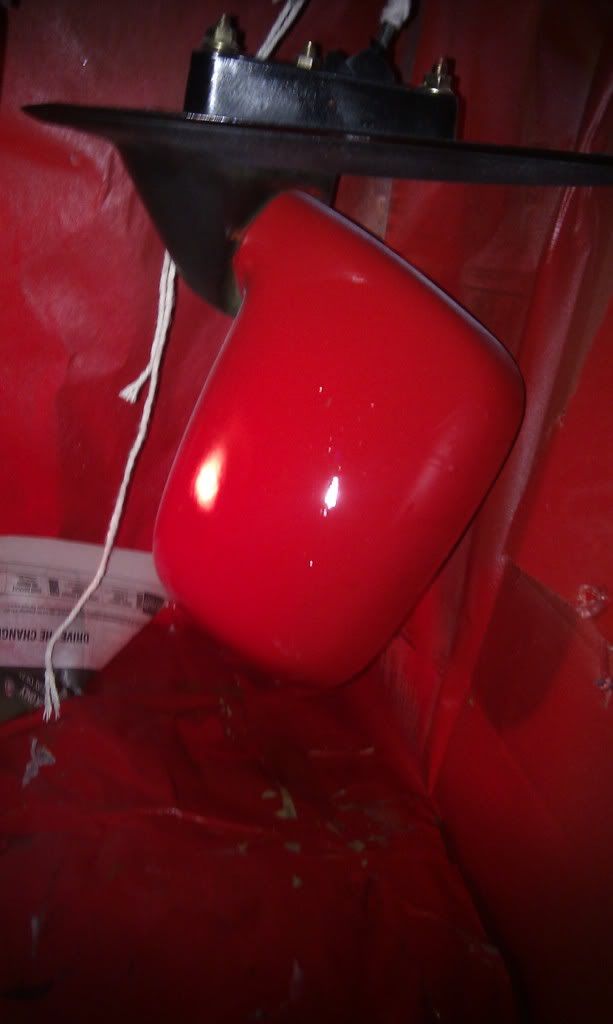

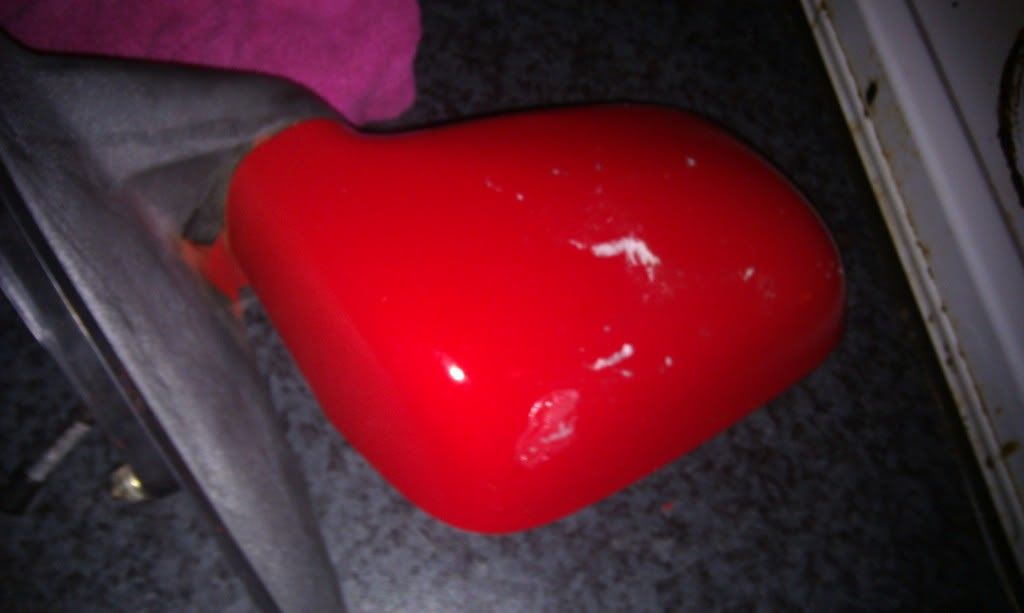

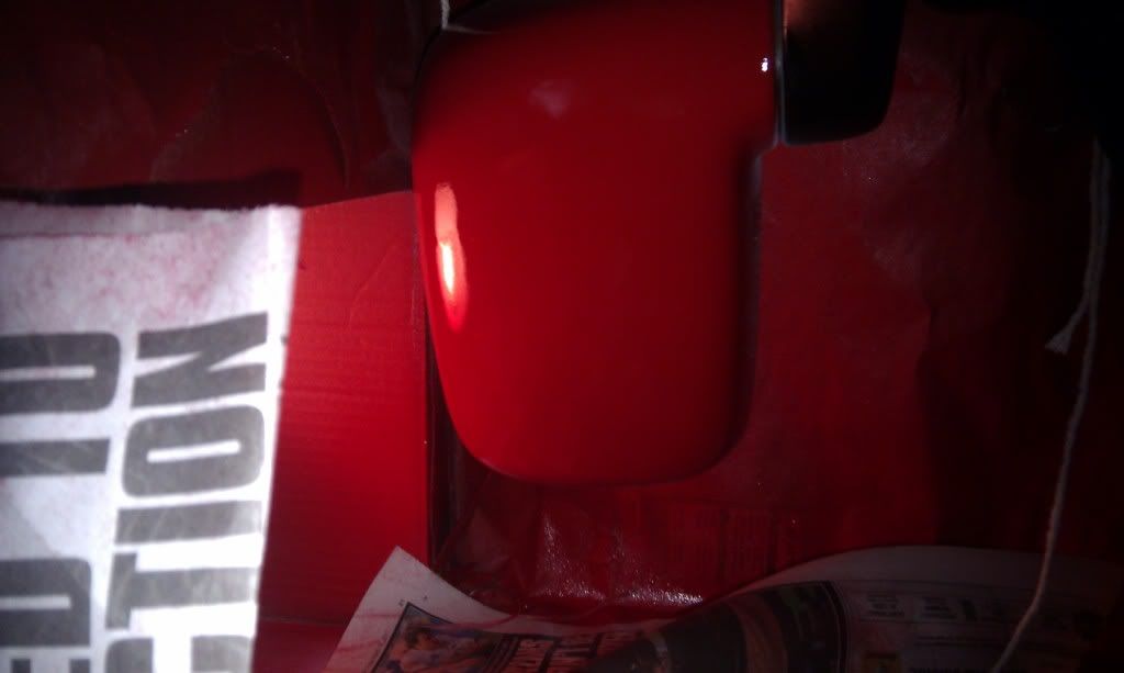

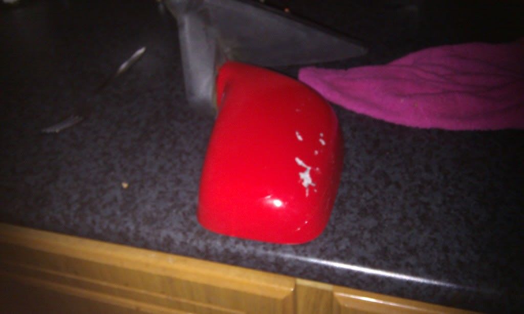

ep91face Posted March 23, 2011 Author Posted March 23, 2011 finally have them done,disaster struck towards the end when i thought they were dry took them out of the homemade spray box and the some newspaper got on top and stuck. i gave them a wash due to having no paint left to sand and respray and another couple of coats of laquer, in the wake of how disgusted i was that the paper stuck im happy enough with the final result for my first time spraying anything .ones better than the otherthis is my starlet about a year ago, havent looked after it like i should have but its all gonna change soon. big plans Quote
