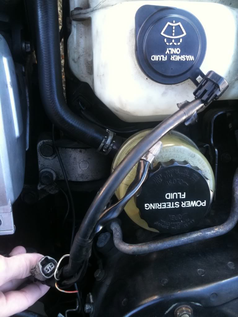

Might be for the high an low boost solonoide thingy, will pop out an look at mine...
Just looked an the longest i have but its not plugged in, the other two i do not have so can only say it must be for hi/low boost of which i have all removed...
One is the stabdard boost solenoid (longest one)
The white one on the P/S resovoir looks to be the brake master cylinder level
One in your hand looks like the idle control valve, what colour of wires go into it?
