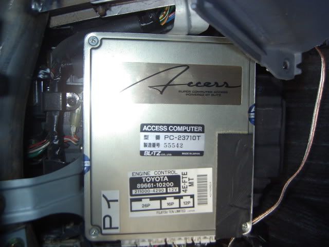

Ry4nL23 Posted September 16, 2011 Posted September 16, 2011 I bought a starlet gt about a week ago, it had some modifications already done to it, and is running a blitz ecu, the problem im having is i fitted a bleed valve till i purchase a boost controller, and i turned it up to run on a bar, but when it gets to about 0.8 bar fuel cut kicks in, i thought the blitz ecu supposed to get rid of the fuel cut and increase the rev limit? Do i need a FCD aswell? Im kinda new to turbo's take it easy Quote
akyakapotter Posted September 16, 2011 Posted September 16, 2011 If it is a blitz I'm sure you shouldn't be getting fuel cut as it gets rid of fuel cut and ups the rpm range check the ecu mate begind the glove box should have blitz seal stickers on it if not looks like it's an FCC or an FCD :-) Quote
Ry4nL23 Posted September 16, 2011 Author Posted September 16, 2011 I took the blokes word for it "/ hes my best mates good freind if that makes sense, so i doubt he would have lied, do i have to take the glove box out? Its rainning outside so if im gonna look i dont wanna be outside too long? Thanks Quote
akyakapotter Posted September 16, 2011 Posted September 16, 2011 No mate openthe glove box and push the sides in will drop down can see it in the right hand side take a pic and up load it mate :-) Quote
Ry4nL23 Posted September 16, 2011 Author Posted September 16, 2011 Okay thank you, will check when the rains clears Quote
akyakapotter Posted September 16, 2011 Posted September 16, 2011 blitz should look like this mate Quote
ktl Posted September 16, 2011 Posted September 16, 2011 the ecu is not behind the glovebox, the ecu on the GT is behind the center console at the bottom. so go to the drivers side, and look behind the center console if it helps right next to your clutch pedal. you'll see wires going into it. its held in by 2 x philip screw drivers and 1 at the back of it (passenger side) Quote
akyakapotter Posted September 16, 2011 Posted September 16, 2011 gt my bad sorry mate for some reason i thought you had a glanza lol Quote
Ry4nL23 Posted September 26, 2011 Author Posted September 26, 2011 yeah mate, turned out to not have a blitz ecu, was kinda pissed off but there you go, will need to get a fuel cut defender now, thanks anyways Quote
akyakapotter Posted September 26, 2011 Posted September 26, 2011 going for a sard like me ? dont forget the jam fcc or hks fcd that solved my boot problems a treat Quote
