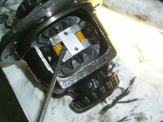

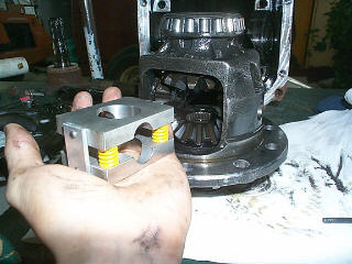

ok i have an update, they can do ours but. . . .
the good news is their gripper product which goes inbetween the spider gears will retail for 200 per diff which is silly cheap considering
and they can work out a solution they will need a front diff for measurments so its totaly doable (hooray there)
no the bad news,
i spent two hours researching phantom grip the the other night, its not a proper lsd as such
and their product
with researching it it does work but due to all the feadback on it there does seam to be some issue with the longevity of it and how it will wear down the teath of the spider gears,
so im not sure if it would be good for road use but strictly drag use,
then theres also instilation, it needs to be installed correctly and measured correctly or it could potentialy distroy the gears. . .
a la pic
whats peoples views on this, should we persue if further or find an alternative??
there is a lot of negative press out there if you search the product
ps renamed thread
same here, its not like our diffs are easy to come by neather.
send us a text when you have time, want to know if you have first fired your 4paw yet :)
as much as i hoped it was the answer it doesnt sound viable tbh :) as you have stated the diffs are sooooo hard to get i dont think its worth chancing. and the prce just makes it even harder to turn down but i think its for the best if we let this one go and carry on the hunt.
