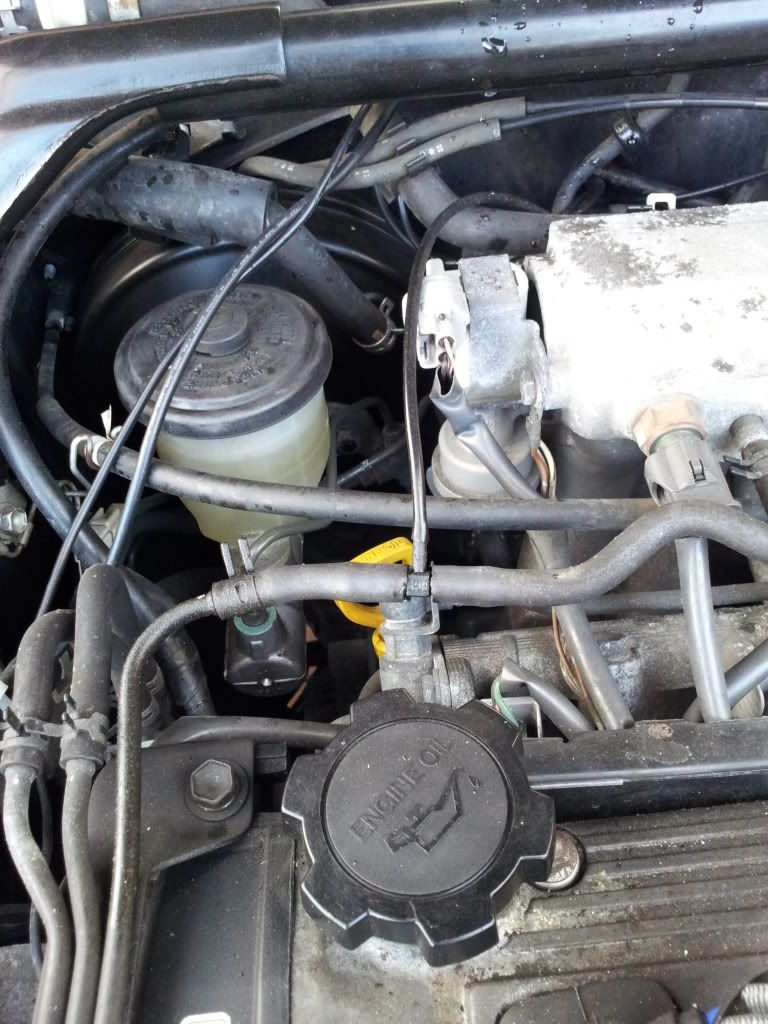

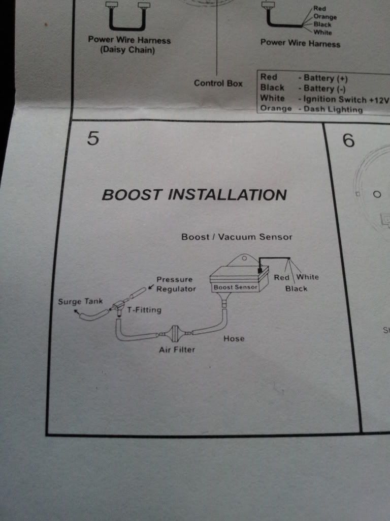

Amjad Posted February 18, 2012 Posted February 18, 2012 Can anyone help me with the fitting of my Depo boost gauge please?I'm a bit confused as to how to fit the vacuum hosing, here's a pic. Can anyone tell me where the t-piece, boost sensor and air filter ie in the car or in the engine bay?And what does it mean by surge tank and pressure regulator? Here's a picture of where my boost vacuums are now Can I just set up the vacuum pipes as they are now? And do I put the filter and sensor in the car our can I just secure them around the firewall?ThanksAmjad Quote
_shaun_ Posted February 18, 2012 Posted February 18, 2012 ive got my prosport sensor just bolted to firewall then just ran like urs with the filter in the middle works fine Quote
Idrees Posted February 18, 2012 Posted February 18, 2012 Simple vacuum from the manifold to the boost sensor box, with the little filter in between them. I did the same as Shaun and bolted it to the firewall. Quote

Amjad Posted February 20, 2012 Author Posted February 20, 2012 Sorted! Fitted it the same way it is now but I used the new supplied T-Piece in case the sensor required it. Cut part of the Map sensor bracket and the sensor is bolted with it and the filter is cable tied in series with some vacuum pipes under the strut brace Quote
