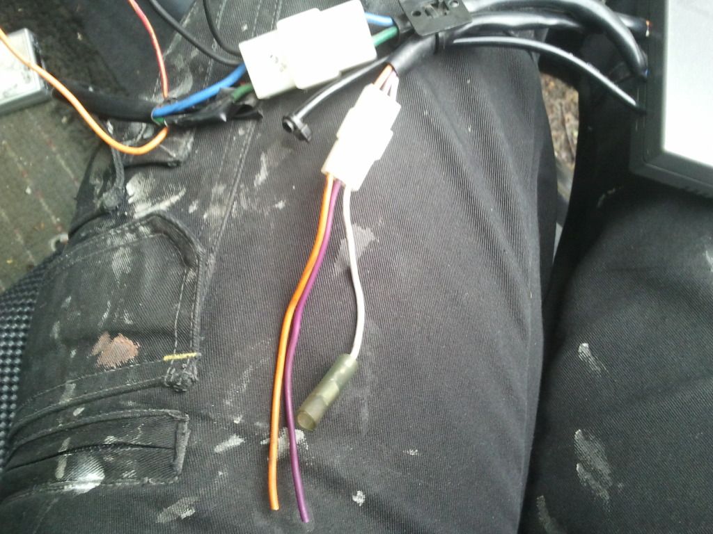

First of is the orange wire in this pic, I no it is for the speed sensor but could anyone tell me where i could find that? I guess this is what will control the Auto setting on the tt cause it doesnt work just now.
Not sure what white is for either?

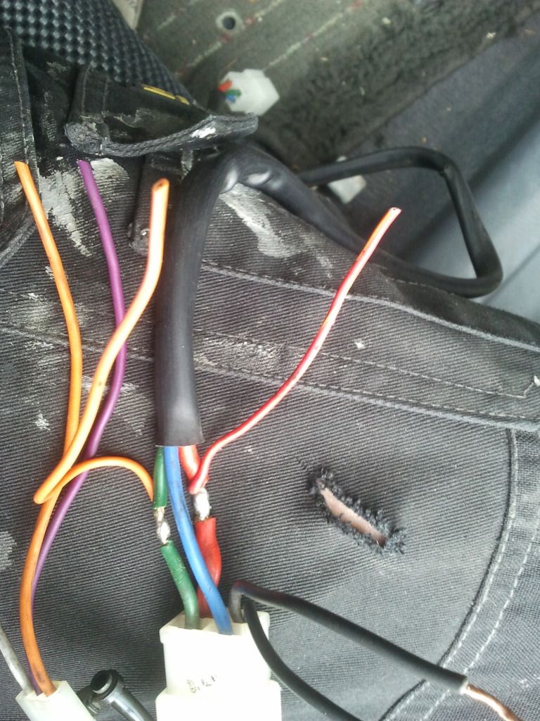

And the orange and red wires that have been soldered on to the harness in this pic
Orange is on green that is IGN
Red is on the red that is the constant 12v
Im just not sure why they have been soldered on to it?

Speed sensor
And handbrake
They are just for the safety's. To cut it out when the handbrake goes down or the car starts moving. So it can't be stolen on timer
Do you have a vacuum to it? That's used for the auto setting :)
Do you no where i could find the speed sensor?

So what about the soldered wires?
