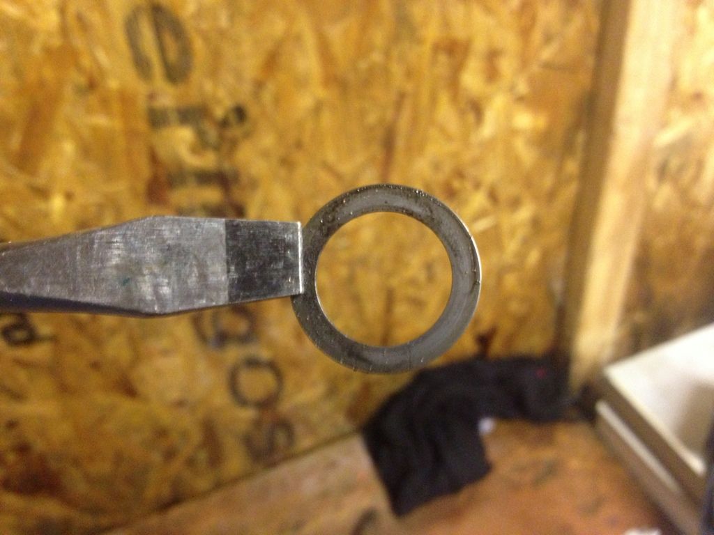

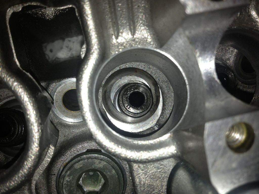

Lew91 Posted December 30, 2012 Posted December 30, 2012 Just been out in the shed for a bit sorting through parts and discoverd that a washer has fallen out of the cylinder head. It's the one that sits right at the bottom by the seal. Now are these included in a full engine gasket set? As I am getting one or do I have to source these separately? If so where can I get a set?Cheers Lewis Quote
AdamB Posted December 30, 2012 Posted December 30, 2012 Looks like a headbolt washer and you will get them with a bolt set mate. Quote
james@cjperformance Posted December 30, 2012 Posted December 30, 2012 is a valve spting washer. iirc they are not included in a gasket set ill see if i can find part number now Quote
_shaun_ Posted December 30, 2012 Posted December 30, 2012 as above and nah you dont get them in a gasket set Quote
Lew91 Posted December 30, 2012 Author Posted December 30, 2012 Yeah it's what the spring sits on top of, I didn't even realise they were there. Cheers for that, might make life a little easier Yeah it's what the spring sits on top of, I didn't even realise they were there. Cheers for that, might make life a little easier Quote
