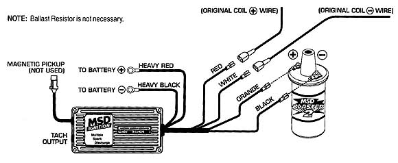

Tha Dragon Posted August 8, 2013 Author Posted August 8, 2013 (edited) You having problems with the trigger pick up? I was confused about the white wire but i was doing some research and i found this so i think i'm on the right path. Cause i have on that says put the "Red wire" to "Original Coil + wire" and nothing else so i was thinking what do i need to do with the "White wire" that is left. and about the "Original Coil - wire" But now i found this pic i think i have the solution for my problem. Edited August 8, 2013 by Tha Dragon Quote

Tha Dragon Posted August 8, 2013 Author Posted August 8, 2013 Just got home went thru the wires connected them like it is showed on the picture but it doesn't start and as soon as I take them all off the car starts perfectly, now I'm really stuck with it can you guys give me some advice on what 2 do?I have the MSD SCI with the msd blaster ss coil can you guys send me a wire diagram or some on how 2 connect the wires together so my car can start? Quote
enzo_e492901 Posted August 9, 2013 Posted August 9, 2013 (edited) This is how I did mine. Although mine was the MSD Digital 6A, it looks to wire in the same as yours. Gavin Edited August 9, 2013 by enzo_e492901 Quote
Tha Dragon Posted August 9, 2013 Author Posted August 9, 2013 (edited) Thanks for the info, isn't there anyone else that can help me out here really wanna use this the msd on my car. So in your wire diagram it look the same enzo_e492901 i'm a noob in wire diagram but please help me out here Edited August 9, 2013 by Tha Dragon Quote
enzo_e492901 Posted August 9, 2013 Posted August 9, 2013 With standard glanza wiring in place you need to... 1. Remove the standard coil + wire and in it's place on the coil connect the MSD Orange wire.2. Connect the MSD Red wire to the wire you took off the coil in step 1.3. Remove the standard coil - wire and in it's place on the coil connect the MSD Black Wire.4. Connect the MSD White wire to the wire you took off the coil in step 3.5. Connect the thick MSD Red wire to the battery + terminal.6. Connect the thick MSD Black wire to the battery - terminal. Magnetic pickup wires are not used on the Starlet/Glanza (MSD Green and Violet wires) Gavin Quote

enzo_e492901 Posted August 9, 2013 Posted August 9, 2013 From what you say about it kind of starting then cutting out I know what the problem is. You need an MSD tach adaptor to fool the igniter into thinking it's fired a coil so it sends the feedback signal back to the ECU. MSD part number 8910 or 8910EIS. If you get 8910EIS it can be wired both ways. Wired like this. Once again the Magnetic pickup wires are not used on the Starlet/Glanza (MSD Green and Violet wires) Gavin Quote
Tha Dragon Posted August 9, 2013 Author Posted August 9, 2013 So from what info i got i need to connect the wires to the "Tach Adapter" and then it would work ok? Quote
enzo_e492901 Posted August 9, 2013 Posted August 9, 2013 Connect it up like this... With standard glanza wiring in place you need to... 1. Remove the standard coil + wire and in it's place on the coil connect the MSD Orange wire.2. Connect the MSD Red wire to the wire you took off the coil in step 1.3. Remove the standard coil - wire and in it's place on the coil connect the MSD Black Wire.4. Connect the MSD White wire to the wire you took off the coil in step 3.5. Connect the thick MSD Red wire to the battery + terminal.6. Connect the thick MSD Black wire to the battery - terminal. Magnetic pickup wires are not used on the Starlet/Glanza (MSD Green and Violet wires) Gavin Then don't touch the connections you have already made above and connect the following to them... 1. Connect the MSD Tach Adaptor Red wire with the MSD Ignition Red wire.2. Connect the MSD Tach Adaptor White wire with the MSD Ignition White wire. Then it should work. Gavin Quote
