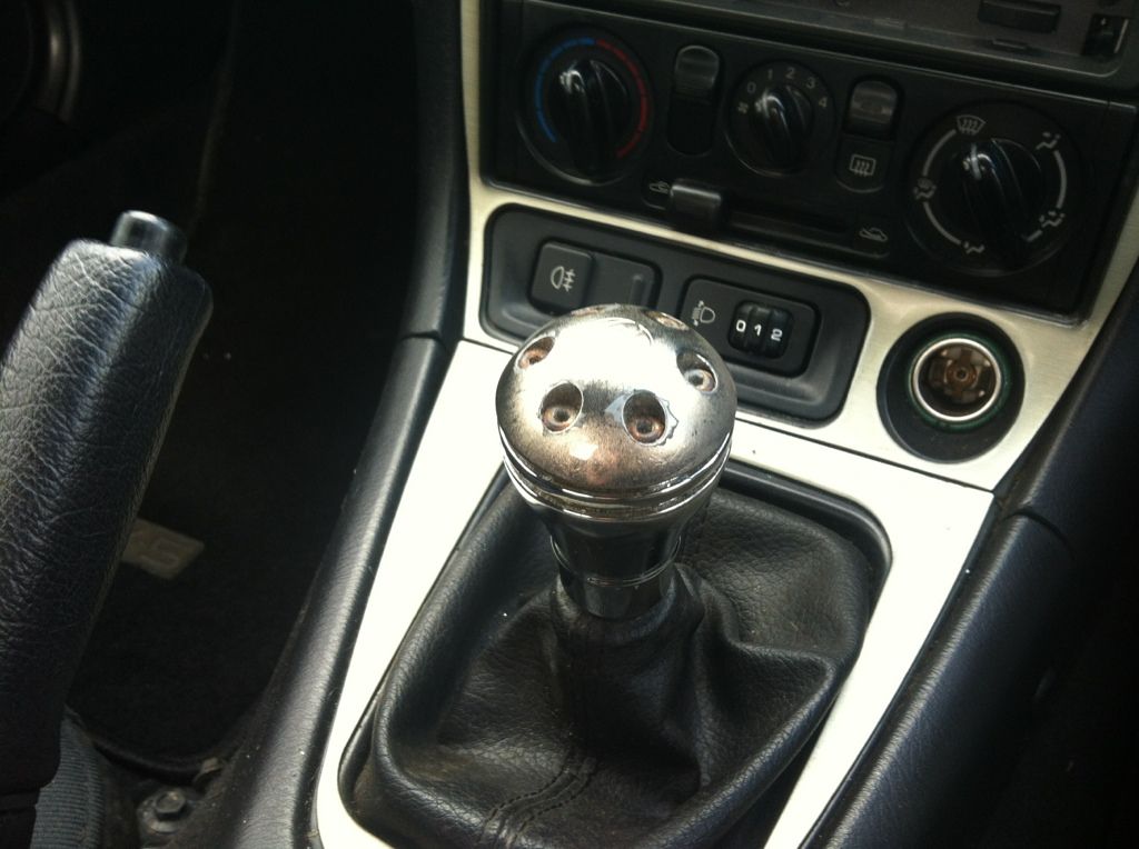

My 'Freaky Roadster' gear knob turned up in the post.
So out with the old.
8E355155-F2C5-463E-9A11-3CF52D63AA33-263
52D058C5-36EA-4AF3-8E2C-06BC60E8D184-263
Much better !

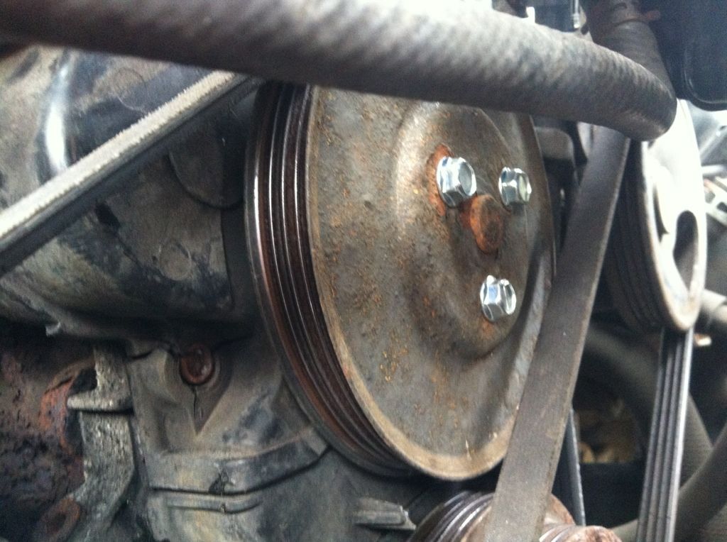

Then the water pump pulley bolt I mentioned previously.
Changed them from ...
Old and busted
F4F0106D-818E-4D92-80C4-F371E7DD93FC-263
New highness
3FDC229E-7F05-4B26-B3E2-CE04BCBABF6D-263

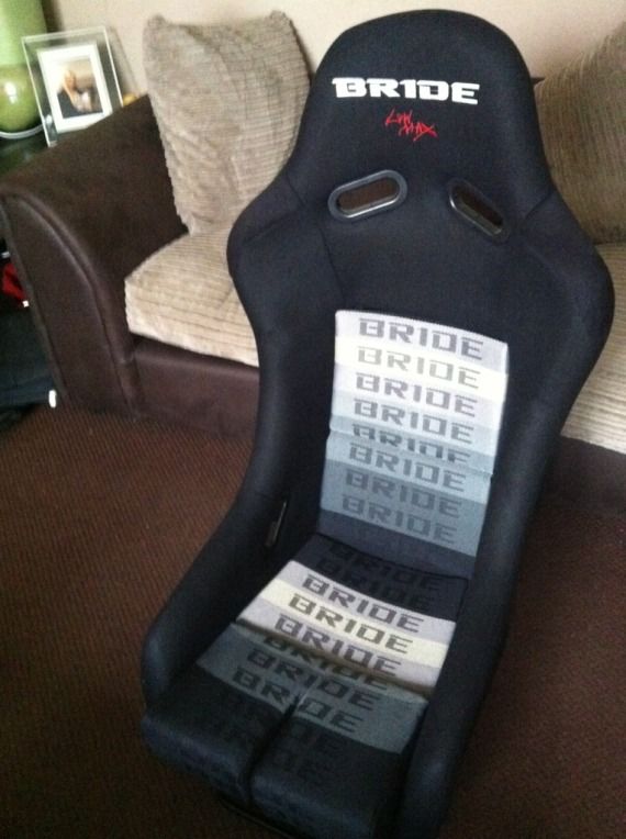

C6182042-F0FA-4C62-9128-464927E6CC2F-182

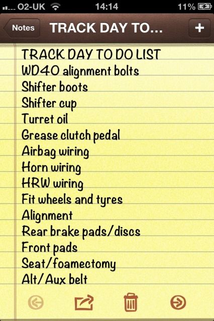

I have a trackday booked on the 15th
Here was my to do list.
B621F0C3-8758-42E8-B3A7-9A601981D4F0-433
I'm aware some of those didn't NEED doing for a track day but the task was set.
1st task, rear brakes as they were shocking.

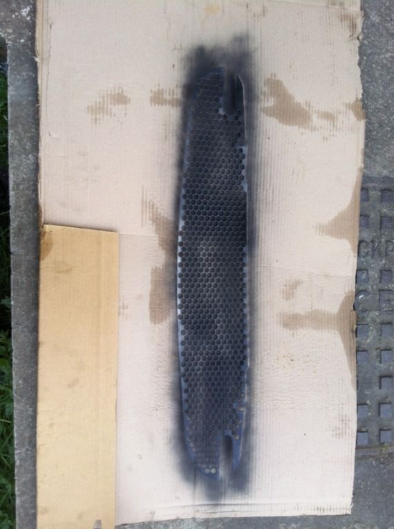

Also got time to spray my front grill
Before
C2832345-44D6-456E-AEE1-D88499E12709-433
During
4C3B7E5C-2A30-4A1B-96BE-BDAD3537388F-433
72C155FA-F89B-48B4-BFF0-D9C879B9B7B2-433

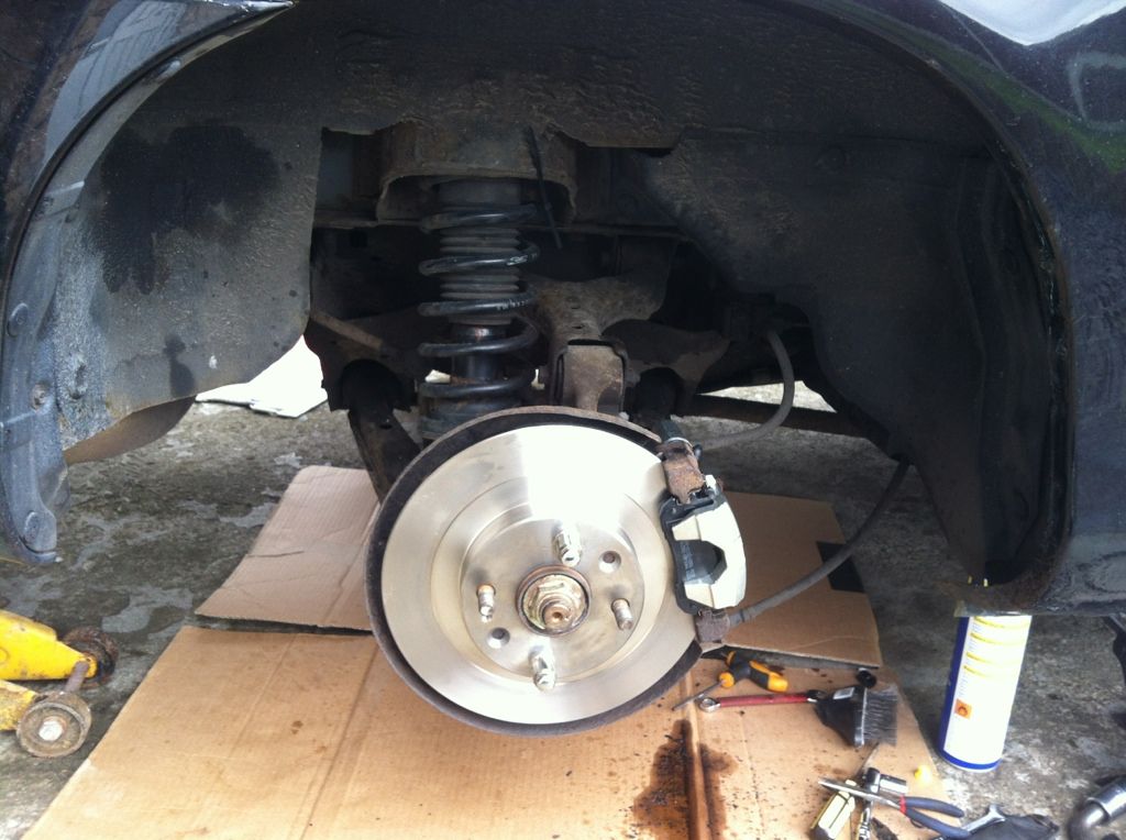

This was my Ali rad from Dan's group buy and 2 new rear calipers as both mine were siezed.
Fitted new rear calipers, pads and discs.
41BBB150-6BD8-4C35-B75B-1006B6CA54B4-119

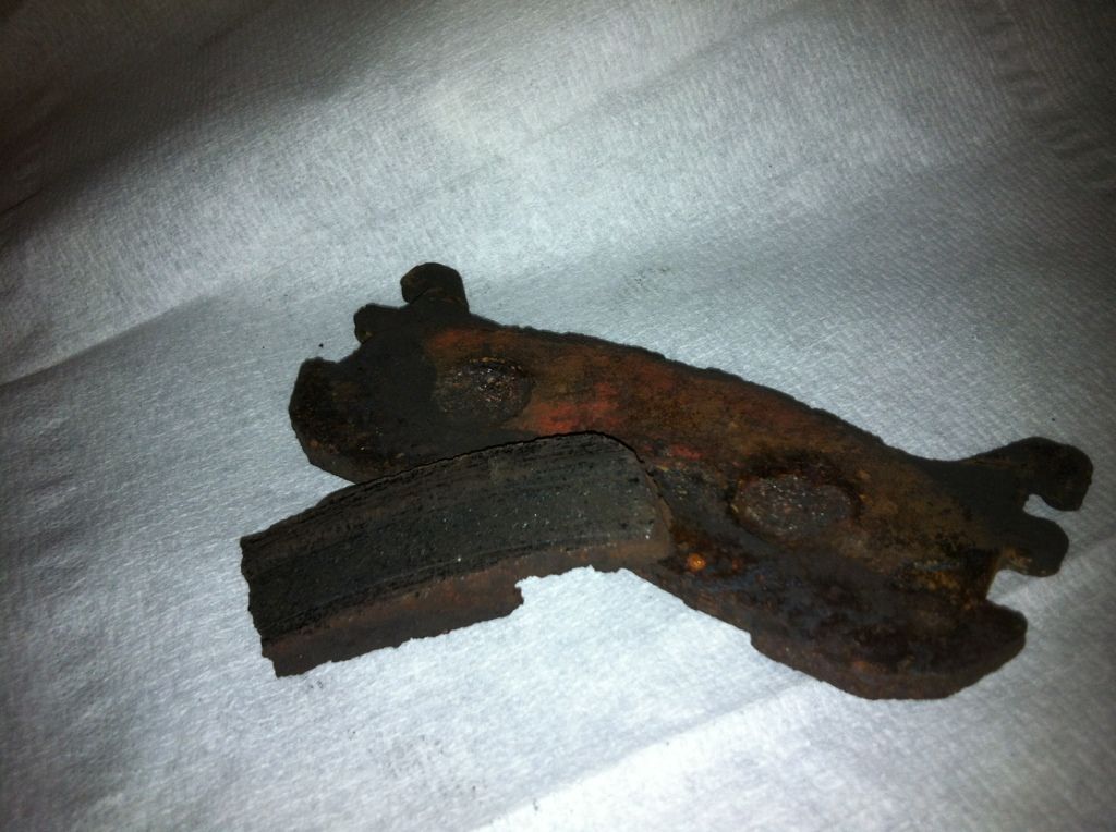

Old pads ....
B0D864DF-56A0-4970-A4CA-AA49270A08AE-119
Not good at all :/

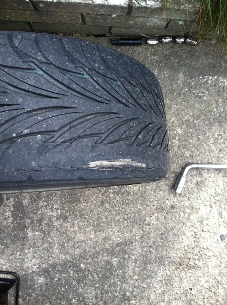

Also whilst the wheels were off I noticed this on the front left.
23420A1B-6696-44D6-9D54-DF7E36DAB901-119
No ideal but luckily I have new (to me) wheels and new tyres in the garage so got them put on but no pics of those just yet.
