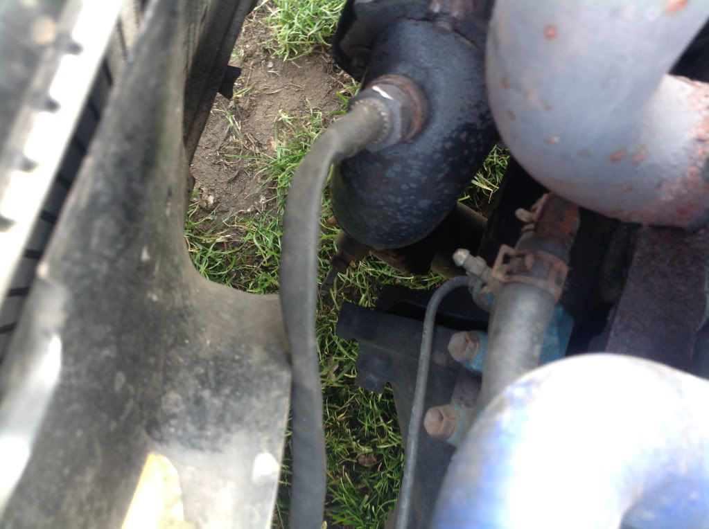

Dan Barnes Posted April 23, 2013 Posted April 23, 2013 My hi and lo boost has been bypassed but im confused on if its been looped how it should, i might just being a bit of a noob but how its been shown on other forums there are metal pipes running to the left hand side of the rocker cover, where as mine has none? I will take a picture now so someone can enlighten me hopefully lol Quote
Dan Barnes Posted April 23, 2013 Author Posted April 23, 2013 Excuse my filthy bay its on the to-do list lol Quote
akyakapotter Posted April 23, 2013 Posted April 23, 2013 Looks like you have a hks actuator anyway bud and gt's didn't have high low anyway correct me if I'm wrong anyone what boost are you running bud ? Quote

AdamB Posted April 23, 2013 Posted April 23, 2013 Your boost bypass is fine, the way you have it means the solenoid and all the gubbins can be removed. This does mean the button on the dash is useless but who needs low boost anyway? The viscosity of the oil won't really make any difference, a 5w over a 10w will provide better start up protection. But the 30 is probably a little too low and no doubt you will prob burn that off in no time! You'll be fine running a 10w40 now the weather is getting better Quote
