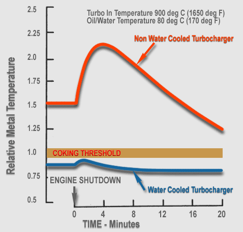

mattglanza79 Posted May 31, 2013 Posted May 31, 2013 AHi. Just heard a few peeps saying that u can u bend the water pipes from pump. As the ct9 doesn't need the water lines connected. Saying uses the oil to cool like new turbo cars.Is this the case? Or will my turbo run too hot. Quote
JayJ Posted May 31, 2013 Posted May 31, 2013 (edited) My car is currently running without turbo waterlines as my thermostat housing hasn't the inlet/outlet for the turbo. You just need to let the car idle for a moment after driving to cool down the turbo, but water will help a lot with the heat soak and I already have a new thermo housing to be changed soon. The waterlines are there for a reason and this picture will explain it very good Edited May 31, 2013 by JayJ Quote
mattglanza79 Posted May 31, 2013 Author Posted May 31, 2013 Hmmmm. I heard the water can cook the bearings in the turbo through to much heat Quote
JayJ Posted May 31, 2013 Posted May 31, 2013 I don't see how the water can cook the bearings as the water has own chamber? If something will cook the bearings, it's the oil after engine shutdown Quote
JayJ Posted May 31, 2013 Posted May 31, 2013 There's also a great write up about watercooled turbos written by Garrett engineers.. link Quote
mattglanza79 Posted May 31, 2013 Author Posted May 31, 2013 Thanks mate. Only had car three weeks and two of them its been on the drive out of action Quote
StuDoc 72 Posted May 31, 2013 Posted May 31, 2013 (edited) The water cools the turbo buddy so how could it cook anything? Your more likely to cook the bearings without the water than with them. Plus its the oil which cooks the bearings not water. If you have a CT9 and the water lines are there you would be absolutely mental to remove them. They were put there for a reason. Edited May 31, 2013 by StuDoc 72 Quote
mattglanza79 Posted May 31, 2013 Author Posted May 31, 2013 They are on mate. One leaking will be sorted later. Just given some gash info that's all boys. Thought id check as I have always workedwith oil cooled turbo's Quote
StuDoc 72 Posted May 31, 2013 Posted May 31, 2013 No worries mate always better to get an opinion on here where everyone is familiar with these cars. Quote
