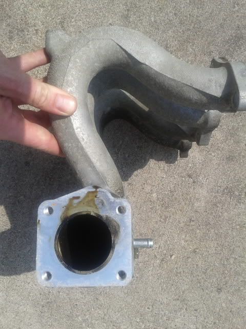

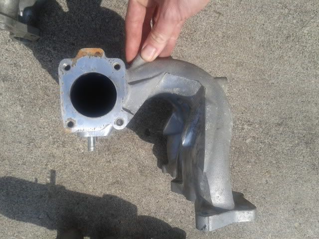

rmsnoel Posted July 22, 2013 Posted July 22, 2013 (edited) Im starting this thread to help answer some nonturbo questions about the inlet manifoldOur 4efe has 4 inlet manifolds available to it and multiple throttlebody sizes as oem.One of which is the glorious ACIS manifold.I have the manifolds here, and Ill do whatever tech needs done or tested and Im hoping to find a few guys on here to help with the formula's. I can do them myself but Id made a mistake I wouldnt spot it nor do I have a pc to present the results in graphs or tables.Heres the basics, http://www.team-integra.net/forum/blogs/michaeldelaney/130-intake-manifold-tech-runner-size-calculations.html http://www.chrysler300club.com/uniq/allaboutrams/ramtheory.htm Edited July 22, 2013 by rmsnoel Quote
