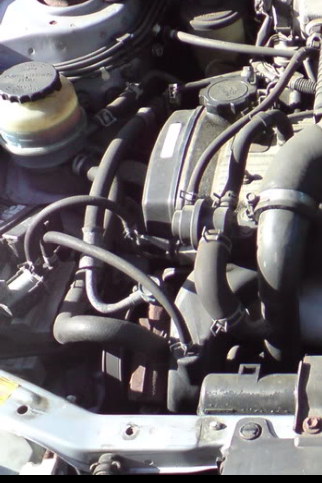

mikey4410 Posted August 16, 2013 Posted August 16, 2013 can somebody please upload some clear pictures of how the heck the hi/lo solenoid goes on my glanza please. have looked online but it hasnt helped much from what i have found so far i have just managed to aquire a solenoid but am unsure of were the tubings go from and to and whats in and out on the solenoid. any pictures at all to help me would be great,thanks alot Quote

mikey4410 Posted August 16, 2013 Author Posted August 16, 2013 does anybody know if the glanzas have the TWO vacuum tube fitments on them like the one i have got ? i know the gt ones have to vacuum inlets to them dont they Quote

mikey4410 Posted August 16, 2013 Author Posted August 16, 2013 i need it to run boost as at the moment its got pipe from turbo air feed direct to the actuator. that picture doesnt help much as i cant see were the other lines go down next to and a bit lower than the top cam cover. does anybody have more pictures ? Quote

akyakapotter Posted August 16, 2013 Posted August 16, 2013 The one by the cam cover goes to the actuator nipple that's facing the engine bud and the other one actuator to Turbo Quote
mikey4410 Posted August 16, 2013 Author Posted August 16, 2013 standard with two feeds going into it Quote
mikey4410 Posted August 16, 2013 Author Posted August 16, 2013 sorted,thanks so much for that potter.top man Quote
