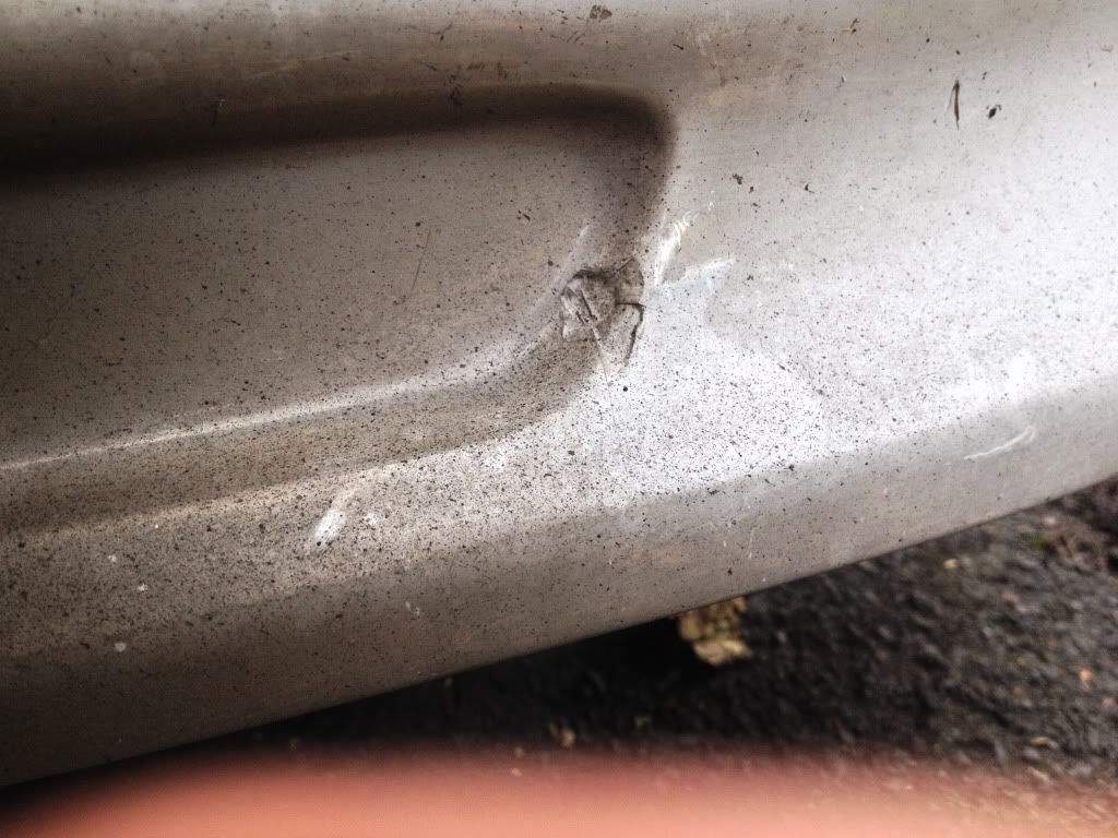

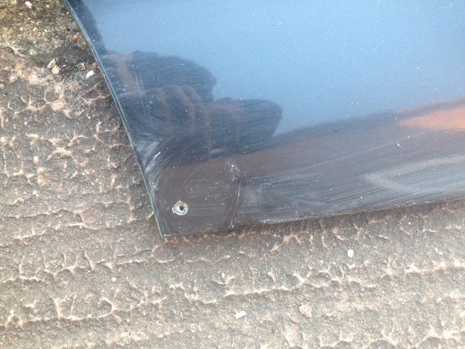

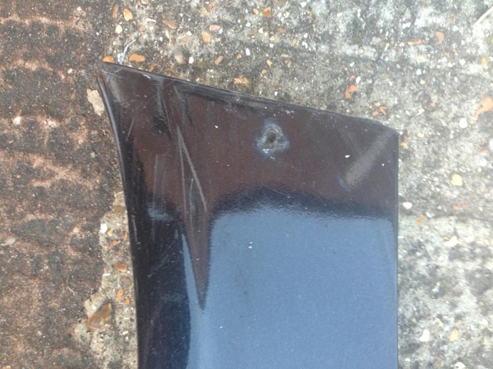

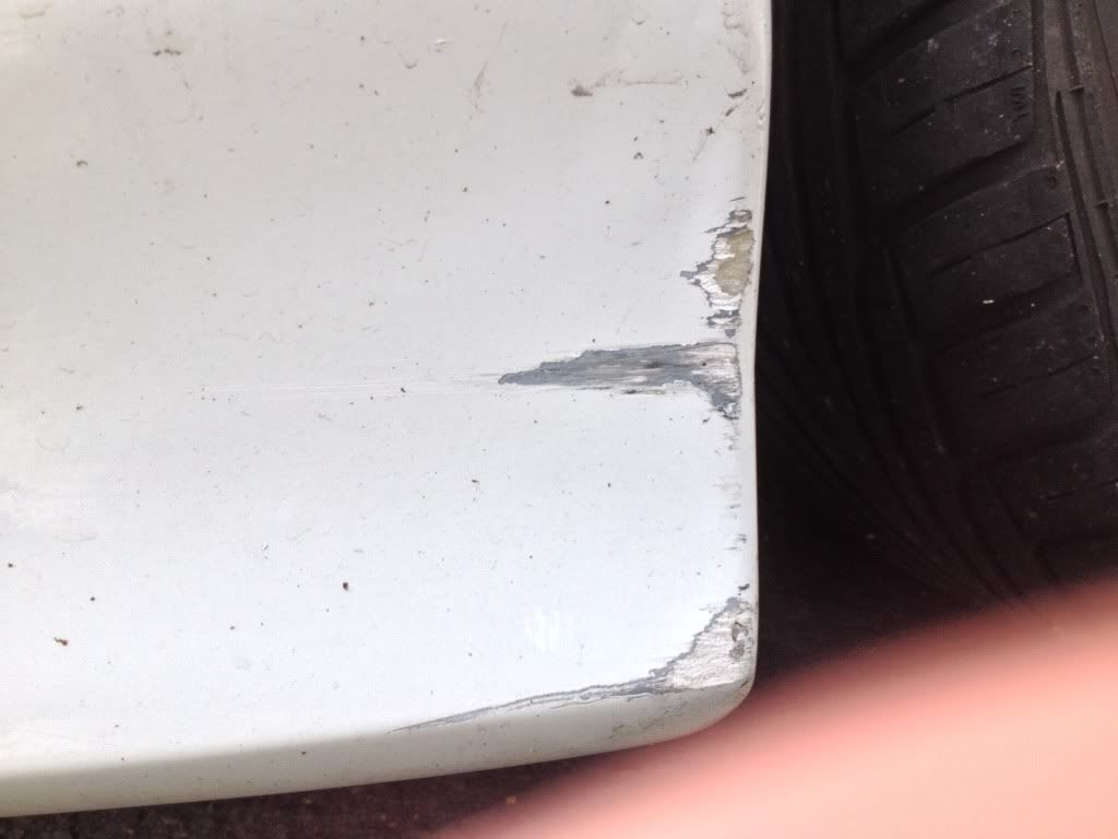

funny onion Posted November 13, 2013 Posted November 13, 2013 Put some pics of the damage up. Gouges you're probably ok just using some upol filler but cracks will need fiberglassing most likely. For filler on the gouges sand the surrounding area back before you apply the filler. Let it go off then sand flat. Same with fiberglass really but if possible I would fiberglass from the back of the bumper then filler the front. Don't have to worry about sanding the fiberglass off then and you can apply plenty. As for te skirts unless there's any damage then just give them a good key and dust over with primer, flat the primer then paint away. That's how I would tackle it (without seeing te damage myself) but I'm sure there will be others who think I'm completely wrong lol. Quote

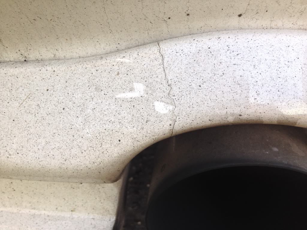

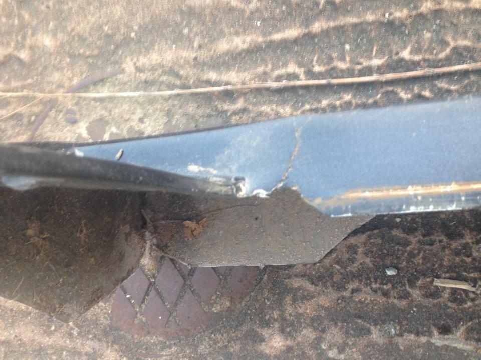

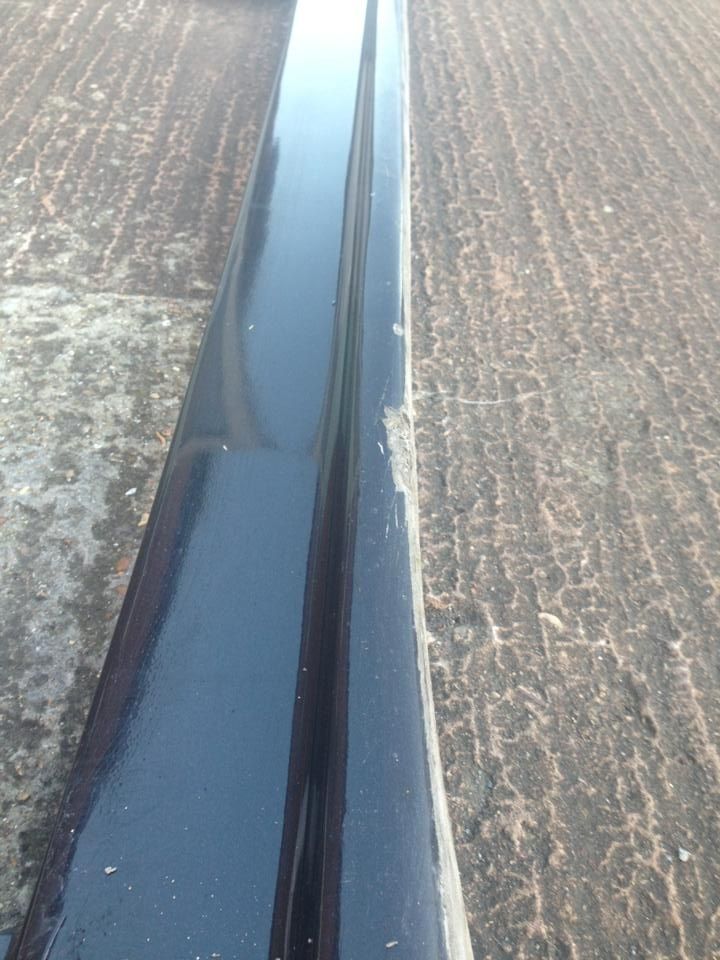

akyakapotter Posted November 13, 2013 Author Posted November 13, 2013 Front splitter dammage And here is the rear splitter damage I know it's very dirty needs a clean lol Quote
A L 3 X Posted November 13, 2013 Posted November 13, 2013 A good way to stop cracks spreading Is drill aSmall circular hole either end of it, then fill that hole with fibreglass resinOnce a crack starts you see it's easy for it to spread,You drill aSmooth hole at either end itStops it right where it is! Quote
akyakapotter Posted November 13, 2013 Author Posted November 13, 2013 Cheers Alex I don't think that can crack any more it's gone top to bottom anyway Quote
A L 3 X Posted November 13, 2013 Posted November 13, 2013 Oh yeah that's apparent now you mention it, best thing is to probably glue the join and reinforce it somehow Quote
akyakapotter Posted November 13, 2013 Author Posted November 13, 2013 One of my body work mates recommend plastx or dolphin glaze but my got its expensive lol Quote

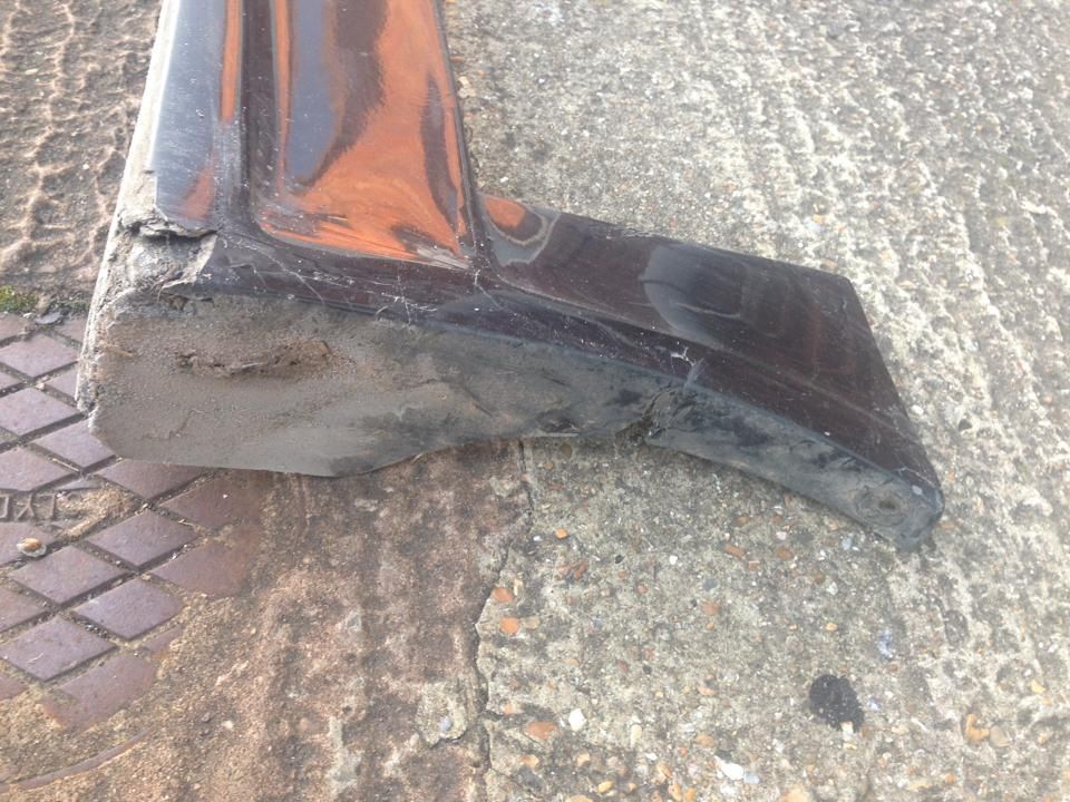

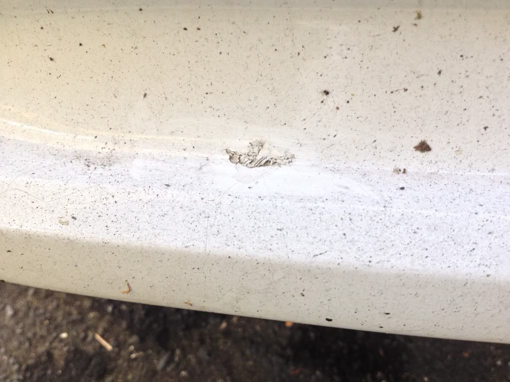

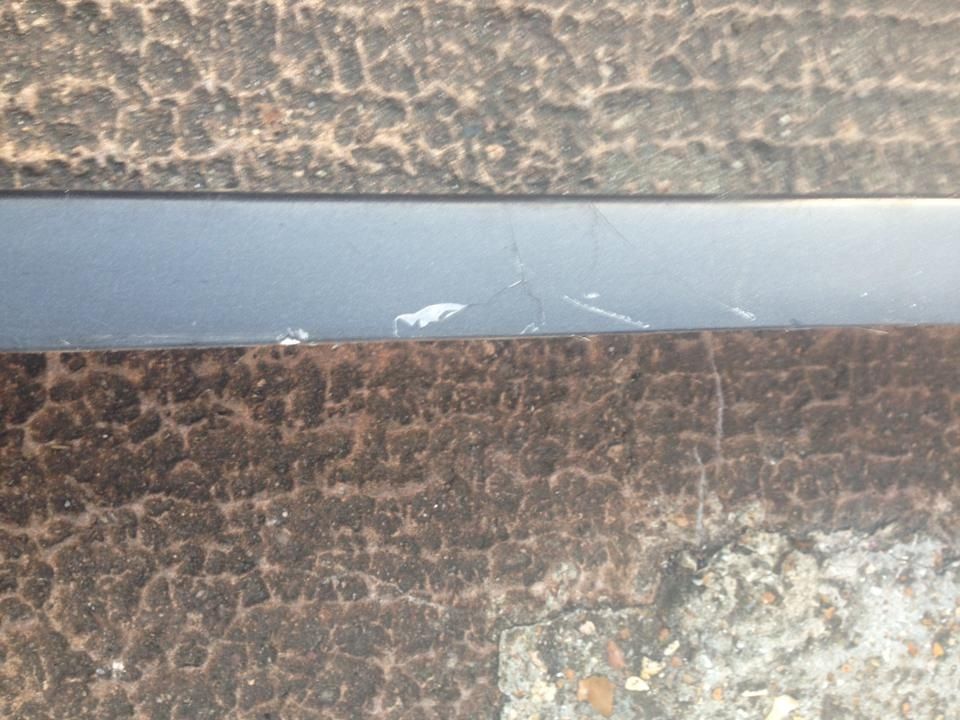

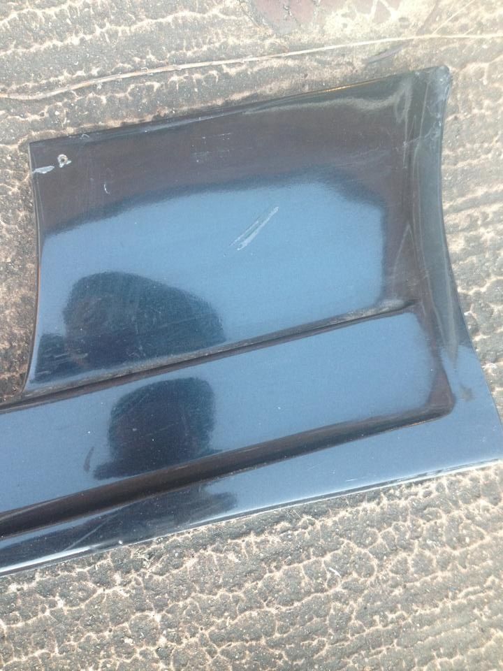

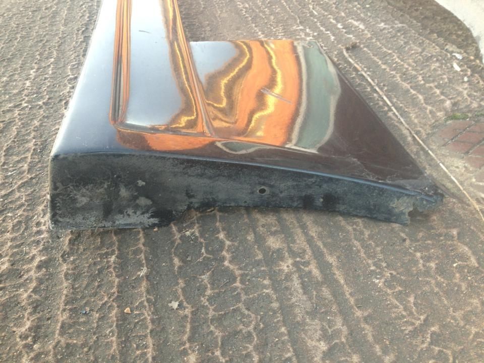

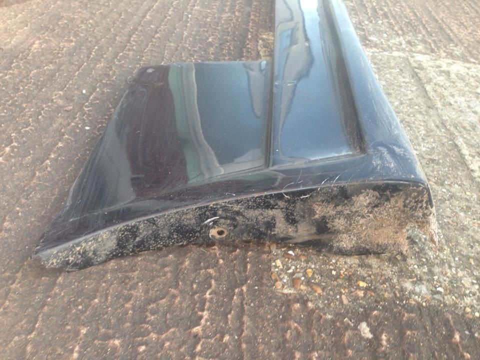

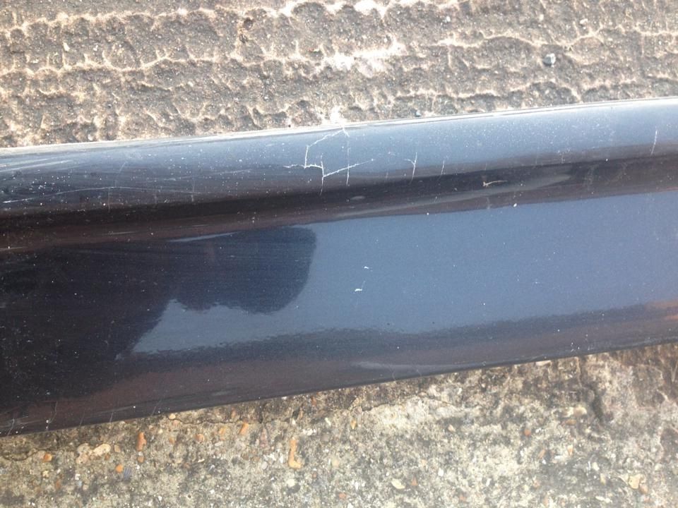

akyakapotter Posted December 5, 2013 Author Posted December 5, 2013 Ok so picked up some genuine livesports side skirts that need work pics to follow what's my best plan of action to repair them ie what will I need ect cheers nick Quote
akyakapotter Posted December 10, 2013 Author Posted December 10, 2013 Anyone recommend me products I'll need for the repair of the splitter and skirts I wanna get a list of things I'll need to get aftercrimbo cheers nick Quote
Gainzy Posted December 10, 2013 Posted December 10, 2013 Bridging filler with hardener, wet n dry from p320 to p1500, filler card, fibreglass kit, mole grips, flat rubbing block Quote
akyakapotter Posted December 10, 2013 Author Posted December 10, 2013 Ah cool been looking at the filler but dunno what is the best stuff to get Quote
Gainzy Posted December 10, 2013 Posted December 10, 2013 Would only use the upol yellow tin for metal, bridging will be fine Quote

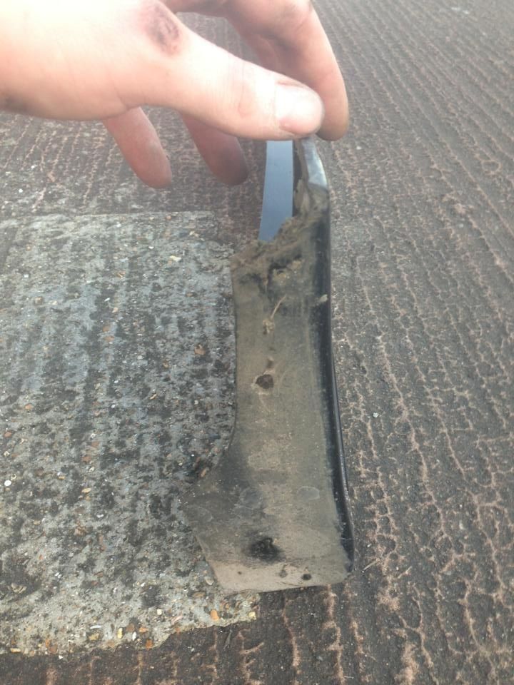

akyakapotter Posted January 3, 2014 Author Posted January 3, 2014 Ok so made a start on these today how much sanding should I do before I start with the fiberglass matting and bridging filler cheers nick Quote
