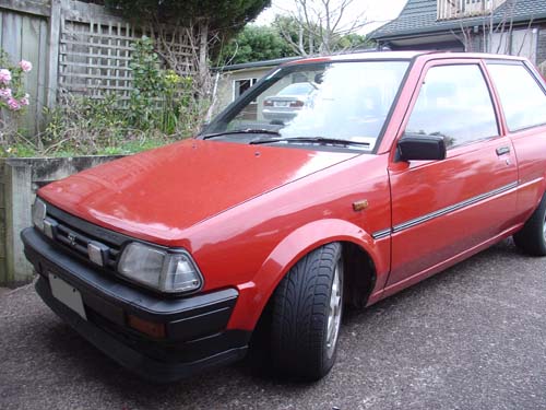

Chapman34 Posted December 2, 2013 Posted December 2, 2013 i have an ep70 and it needs to be dropped as its handles like a boat, and ive fitted 15s just wondering if theres any upgrades shocks and springs wise as i cant afford coil overs or justify it as its only a daily. do i get some ep70 lowering springs on standard shocks 40mm drop? would i gain anything from using standard ep82 or glanza suspension? aftermarket shocks and springs combo for a ep82 or glanza do they fit? ie 40mm drop on aftermarket springs? or would it sit to high or will it sit lower?. only reason i ask ive had owned hondas aswell and still do, and i know you have issues if you use EG suspension on an ED/EF/EC civic chassis and will cause the civic to sit high has eg shocks are longer, just wondering if thats the similar case to starlets. any help would be appreciated as cant seem to find much info on compatibility of the newer starlet parts on the older ep70 model this is how it sits now Quote
