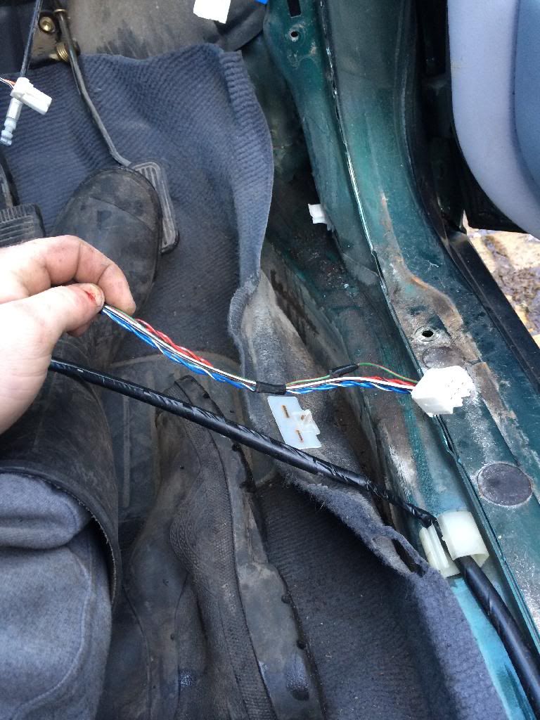

dangeestarlet Posted January 26, 2014 Posted January 26, 2014 Hi, just wiring up my loom now and there a wire that runs down the drivers side from the back with a plug as shown and there's nowhere on the dash loom to plug it in, any idea were it goes? It seems to be for the back lights or fuel pump cheers Quote

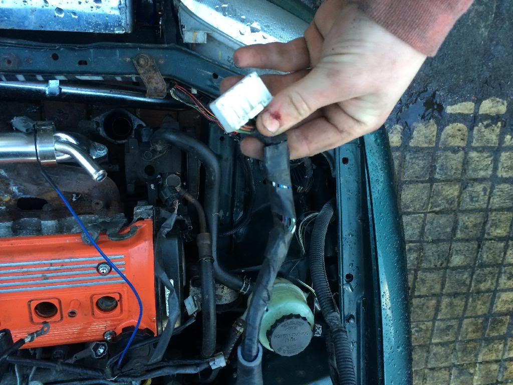

dangeestarlet Posted January 26, 2014 Author Posted January 26, 2014 Ok so I found it goes into a box and there's no other connectors on the dash loom to plug in but I found a plug on the engine loom that will plug into box but it's in the bay on the drivers side :s Quote
Zeldoz Posted January 26, 2014 Posted January 26, 2014 I think that went onto a plug which was near the handbrake mate. Could be wrong Quote
Zeldoz Posted January 26, 2014 Posted January 26, 2014 (edited) That box was up on the right of the steering wheel inside.The loom ran around the bay and through a hole behind the wing then into that Edited January 26, 2014 by Zeldoz Quote
daniel_g Posted January 26, 2014 Posted January 26, 2014 Thats for the ABS, your UK spec wont have ABS. The other plug for it runs up the OSF wing and into the car there, but it wont matter anyway Quote
dangeestarlet Posted January 26, 2014 Author Posted January 26, 2014 So the plug in the bay runs back into the car and plugs into the box? Yes the box sits up under by the steering wheel, fitting the interior loom was pretty easy just got stuck on that bloody plug haha Quote
daniel_g Posted January 26, 2014 Posted January 26, 2014 Yeah mate it goes into a rubber grommet under the OSF wing and up behind the dash.The engine bay is easy aswell man, it all lays out pretty easy and the plugs cant get mixed up.You might find the washer motor wiring is in the wrong place aswell Quote
