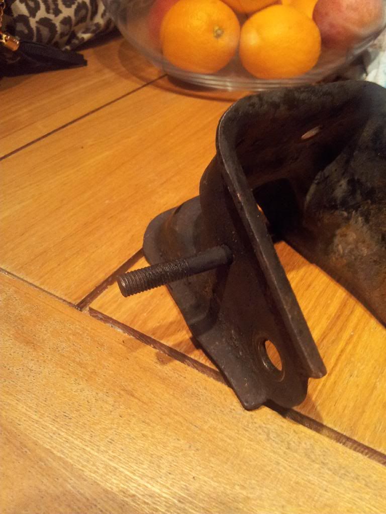

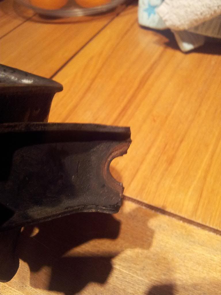

kavan-k Posted February 3, 2014 Author Posted February 3, 2014 2nd photo is where it broke, whats the bolt on the first pic for? Also there was two bolts missing, must of been a brutal hole Quote
morgey Posted February 3, 2014 Posted February 3, 2014 Think There's a vibration dampener on there usually. Not really needed.I'd say that's been broke a while looking at that and how rusty it is. Quote
kavan-k Posted February 3, 2014 Author Posted February 3, 2014 Yeah its in pretty shit shape lol ahh thats not so bad, as long as its nothing important! Cheers morgey! Quote
