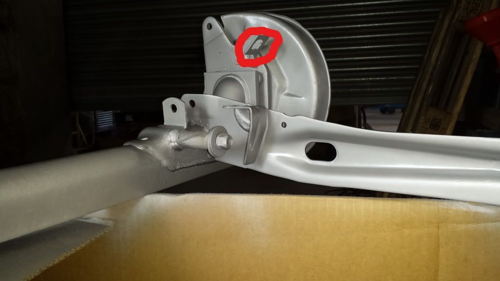

akyakapotter Posted February 16, 2014 Posted February 16, 2014 (edited) ok so went to fit my rear braided lines today got them on but i have a problem. Where they go through the bracket there is a clip that holds it on tight well ment to. The fittings on the braided line is to small so the clip dose nothing and there loose any one who has them fitted able to help me out this is the bracket in red. cheers nick Edited February 16, 2014 by akyakapotter Quote
Jamie5414 Posted February 16, 2014 Posted February 16, 2014 I just bent my clips a bit more so they are pointed in the middle to add a bit of spring to them, haven't drove the car with it like this yet, but I did mine last weekend and it's the best thing I could think of Quote
akyakapotter Posted February 16, 2014 Author Posted February 16, 2014 but they do nothing because you can move the line left or right and the whole fitting goes through the hole was stressing me right out then it got dark lol Quote
Jamie5414 Posted February 16, 2014 Posted February 16, 2014 Yeah I know what you mean, I just kept bending the clip till it was really tight (you had to knock the clip in with a rubber hammer). I don't know why they are so slack though...I thought they where meant to be EP91 specific.....I did one of mine and went inside pissed off lol, still got to do the other side, saving that for a time when it's not raining Quote
akyakapotter Posted February 16, 2014 Author Posted February 16, 2014 so did i mate if the fitting was 1mm bigger i wouldn't be having this problem may see if a washer will help me out Quote

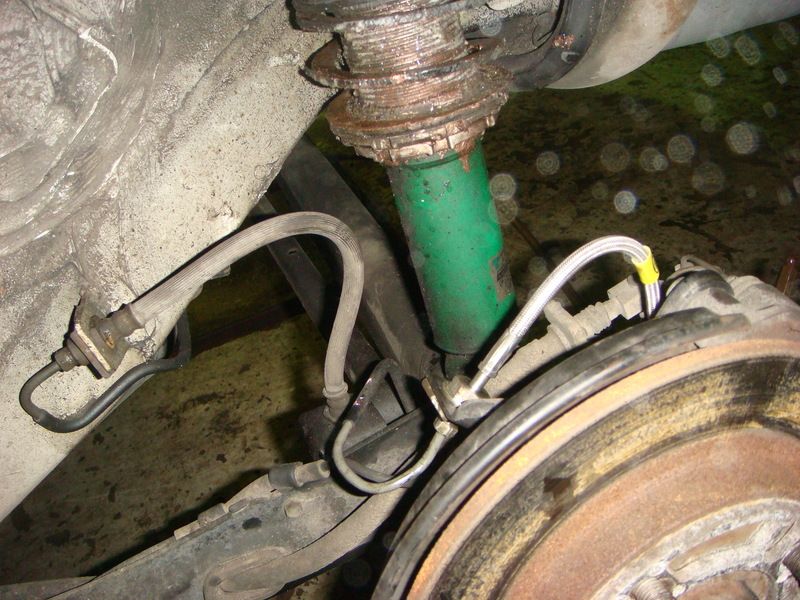

akyakapotter Posted February 17, 2014 Author Posted February 17, 2014 That's the one that's being a bitch with the braided line fitted Quote
