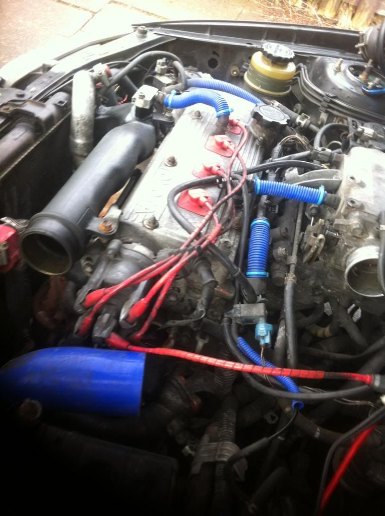

BIGGFOOT Posted February 27, 2014 Posted February 27, 2014 not sure if this the right section to post in but having a problem with cooling. I Set off to pick my mate up from work today ( about a 15 minute drive ) after 10 minutes of driving (normal) noticed a bit of steam coming out of my bonnet scoop. I thought nothing of it at first as i'd just washed it n thought maybe a bit of water had gone on my manifold or engine, maybe 1-2mins later noticed more steam + my temp gauge was right at the top! pulled over immediately onto somebodys driveway and turned it off, opened the bonnet and my coolant bottle was shaking violently spitting boiling water everywhere. left it to cool off for few mins then started my mission of finding water ( I was on a country lane in the middle of nowhere) lol I knocked on the 2 houses that were connected to the long driveway i'd pulled into, was going to ask for water but nobody answered.......im not proud of this but I kind of jumped over the back fence and found myself watering can and a outside tap thank god. car drives normal no smoke, oil is clean -ish (not cheesey white cream) I don't think its as bad as a headgasket but just wondering if anybody has had same issues or if its a common fault and how to cure it????? ive just ordered a thermostat as its only a tenner and heard they can get stuck open or closed, do you think this is a good place to start? any help much appreciated thanks Quote
