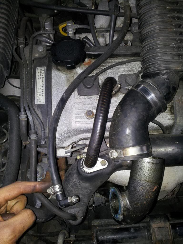

I bought a greddy type s bov last week which has the exact same mounting bracket as this one:
http://www.ukstarletowners.com/topic/37875-fitting-greddy-type-s-to-tmic/
I was trying to fit it earlier and had a couple of issues.
1. The mounting bracket on the bov, was too big to attach to the pipe which connects to the TMIC.

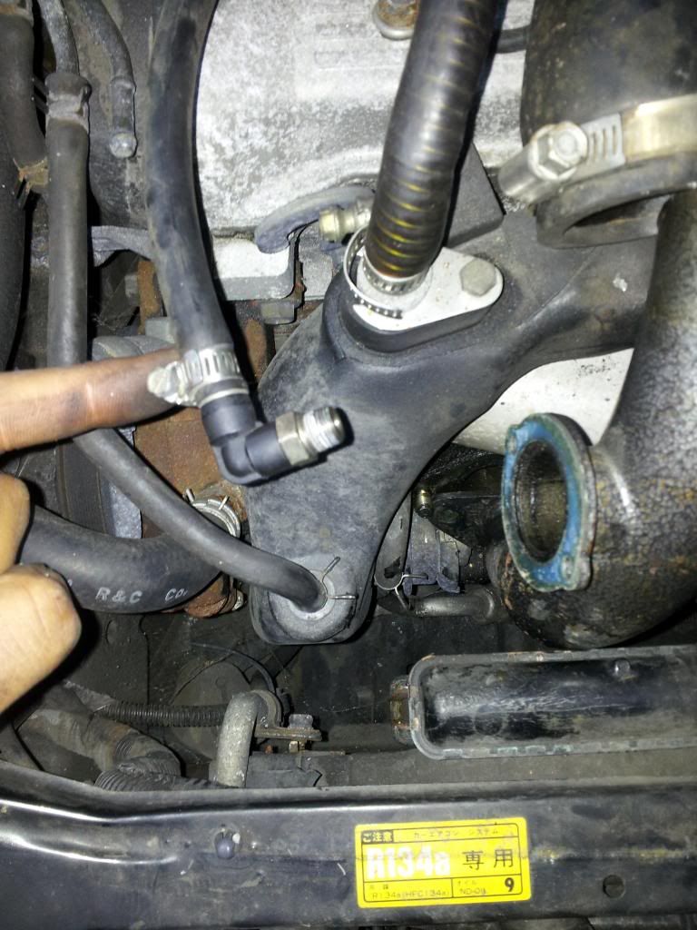

I had a Blitz SS, which I removed to fit the greddy. Looking at the pipe - Think its called the hot side pipe :s - I don't think its a stock ep82 one...and may have been modded by the previous owner to fit the blitz bov? Can anyone confirm this by looking at the pic below.
2. Also do I connect this hose - hose from the TB - ,to the top greddy bov nipple?
Thanks for any help with this peeps. Got my first tool box today and finally got my GT diy cherry popped.
Edited by Djaniero
To your first question, no that is not the stock pipe.
I would personally buy a stock one from someone on here and then just do exactly what amjad did in his thread that you linked above.
