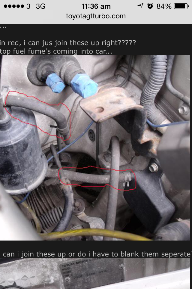

right im currently miles from home and got fuel running out the bottom of this little black box to the right in this pic I've just found
1D08C9E3-1724-458A-97E2-46FC129183D8_zps
i had to change the fuel tank last night, I've drove 15 miles with no problem till i got out and notice it. so what is this black box? and have i put sone pipes on the fuel tank wrong? any help would be great as i dont really want to drive it now. cheers
The bottom output from the charcoal canister should just be a breather so sounds like its being pressurised, which means you probably do have some pipes the wrong way on the tank.
