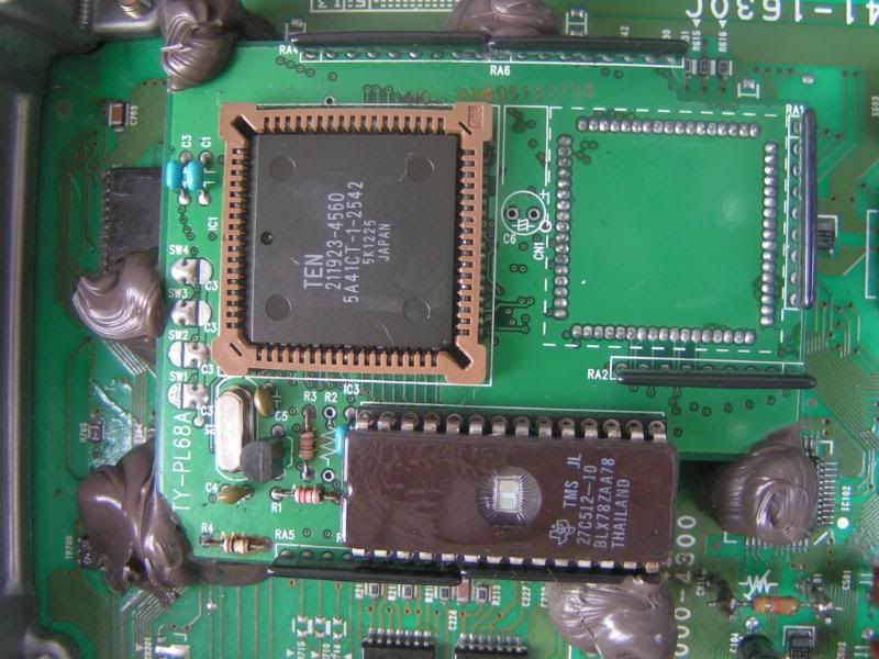

Adam M Posted June 4, 2014 Posted June 4, 2014 Hi ukso I can't find if my ecu is standard or notFirstley what power can a standard ecu produce?As my car defo feels 200 bhp if not more ( have no printout)Secondley the ecu just has the standard sticker on it no aftermarket logo or stickers all i have are the codes which are these:Toyota89661-10200211000-4290 12v26p 16p4e fteP - -Reason is the tuner needs to know or shall i show him the ecu and see what he thinksIf anyone can shed light please doThanksAdam Quote
morgey Posted June 4, 2014 Posted June 4, 2014 Open it up. Stock has a single board. Aftermarket has a secondary.But be warned some ecu's are said to have a light sensing chip that goes blank I've opened (apparently)Stock ecu revs to 7700Speedlimiter at 112mphBoost cut at 0.85 barBoth the later can be removed with a speedo convertor and a Fcd Quote
Adam M Posted June 4, 2014 Author Posted June 4, 2014 Thanks allot for the reply mate i'll have a look!Mine is running about 11-12 psi so 0.85ish barLimits at like 8500 and does about 120-130 mph i think so must be aftermarket i guessI'll check thanks for the info massive help! Quote
morgey Posted June 4, 2014 Posted June 4, 2014 With rpm that high I would assume so. But yeah if you open it up you will either see a board with a 2nd one on top a bit like this http://img.photobucket.com/albums/v229/TTJ/JamECU_2.jpgThat means it's non standard Quote
morgey Posted June 5, 2014 Posted June 5, 2014 Stock 4e-fte ECU revs to 7200 rpm.I stand corrected. I don't have a 4e or 5e so Quote
karl. Posted June 5, 2014 Posted June 5, 2014 Stock 4e-fte ECU revs to 7200 rpm. EP82 is 7200 and EP91 is 7500 Quote
