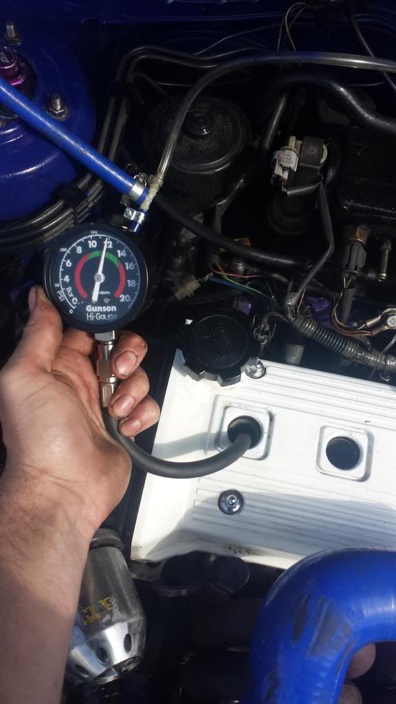

ryan22laird Posted June 29, 2014 Posted June 29, 2014 What should the correct reading be on a compression test on a stage 2 forged engine ? A done a check today and all 4 cylinders are 110 psi over all 4 does that sound about right ? Forgot to mention it's wossner pistons if that makes any difference Quote
russ78 Posted June 29, 2014 Posted June 29, 2014 was this a cold test ? why did you do a compression test ? Quote
mikey4410 Posted June 29, 2014 Posted June 29, 2014 Thats not right at all.throttle must be fully open, each cylinder requires 5 secs of cranking to give result. All this with a WARM engine Quote
ryan22laird Posted June 29, 2014 Author Posted June 29, 2014 was this a cold test ? why did you do a compression test ?Yes mate the engine was cold and a only got the engine two weeks ago just wanted to see what the compression was reading Quote
ryan22laird Posted June 29, 2014 Author Posted June 29, 2014 Thats not right at all.throttle must be fully open, each cylinder requires 5 secs of cranking to give result. All this with a WARM engine the engine was cold mate a was having problems with the throttle position sensor the day before could that cause it what should the correct reading be ? Quote
russ78 Posted June 29, 2014 Posted June 29, 2014 try a warm test with throttle fully open buddy as mikey says as those readings are inaccurate.... Quote
ryan22laird Posted June 29, 2014 Author Posted June 29, 2014 Haha my bad a borrowed a friend compression tester he told me to start of with that one of the compression testers was fucked no doubt a pick the fucked one up ae well basically a just done a compression test and it's reading 165 psi does that sound correct ? Quote
ryan22laird Posted June 29, 2014 Author Posted June 29, 2014 bang on for a forged engine buddy thanks dude 😀 Quote
