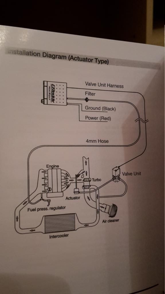

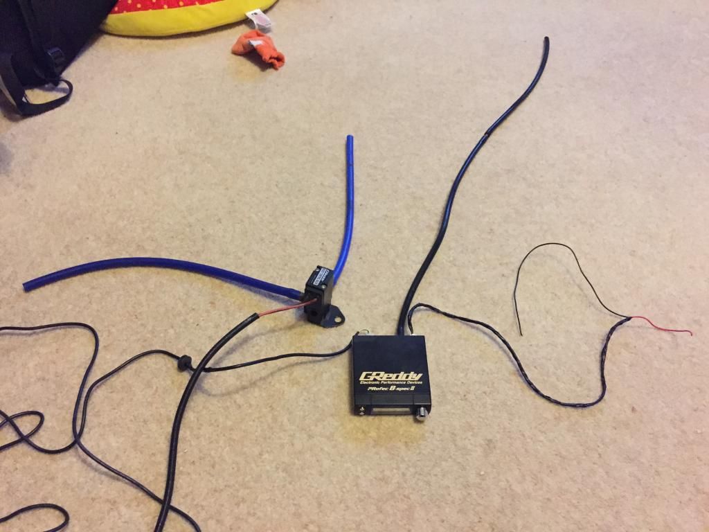

Manny01 Posted November 27, 2014 Posted November 27, 2014 (edited) Just got a greddy ebc, just need to know where things go, I know what to do with the power wires, does the vacuum pipe out the back of the unit go to the boost guage? And the boost adjuster the other end of the loom vacuum pipes go on the actuator and turbo yeah? Thanks. Edited November 27, 2014 by Manny01 Quote
Matt1878 Posted November 27, 2014 Posted November 27, 2014 Post some pictures of what you have mate and Im sure someone with the same controller can help.. Usually you will have two vac pipes... one off the actuator and one off the turbo both going to a solenoid. All depends on what EBC you have ofc. Quote

Gainzy Posted November 27, 2014 Posted November 27, 2014 You need an inline airfilter to the long black pipe a couple of T piece's and 4 metre's of vac pipe 4mm Quote
Manny01 Posted November 28, 2014 Author Posted November 28, 2014 Got any pics of an inline air filter for example? Quote
Gainzy Posted November 28, 2014 Posted November 28, 2014 http://pages.ebay.com/link/?nav=item.view&id=221604456480&alt=web Quote

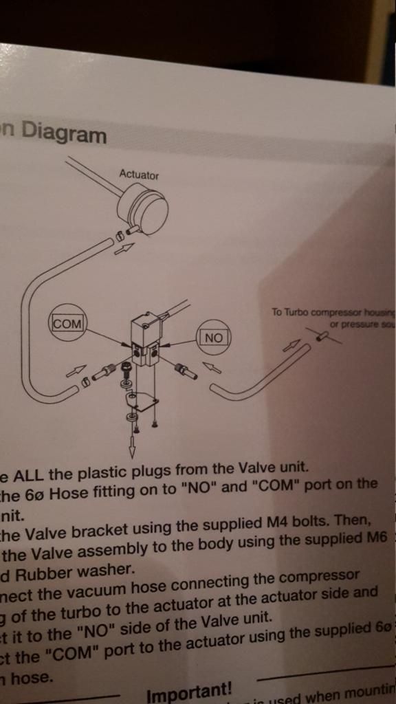

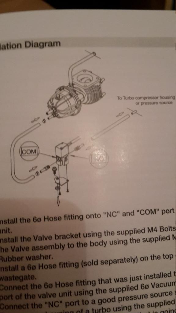

Manny01 Posted November 28, 2014 Author Posted November 28, 2014 Cool, thanks, so that goes in the pipe and where does the pipe connect to? Quote
Gainzy Posted November 28, 2014 Posted November 28, 2014 Your vacuum pipe to the solonoid I have a manual I will put pics up later for you. Quote
