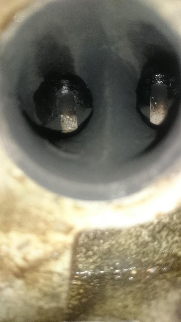

decdd19 Posted December 15, 2014 Share Posted December 15, 2014 Hi lads picked up this engine in the money as it's not gonna be in the car for long, manifold is removed as u look in through the ports u can see oil, I think, just wondering is there a simple fix? Keep in mind I'm not to worried how this engine runs as building a forged 5e... But will want to sort it if I sell it later if it's a problem Quote Link to post Share on other sites
Glanza_Ragger Posted December 15, 2014 Share Posted December 15, 2014 Looks like stem seals are gone, oil seeping down the valve. Quote Link to post Share on other sites
decdd19 Posted December 15, 2014 Author Share Posted December 15, 2014 Might do them while the engine is out Quote Link to post Share on other sites
