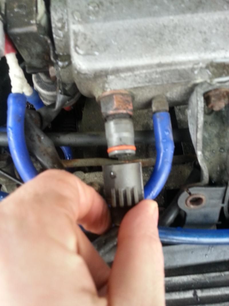

turbominicooper Posted January 31, 2015 Author Posted January 31, 2015 get your multimeter out and check for cracks in the wires first 24 is the sensor on the inlet mani it might be broken disconnected or break in wire 31 is got to do with be map sensor i think do same cheks there Colin, is this the intake sensor? Quote
fordie_glanzaV Posted January 31, 2015 Posted January 31, 2015 Yeh thats air intake sensor.Had same problem the other day.. as colin said get multimeter out and check for life..My wire spit just as it comes off injector loom so luckily didnt have to trace it far. Quote
