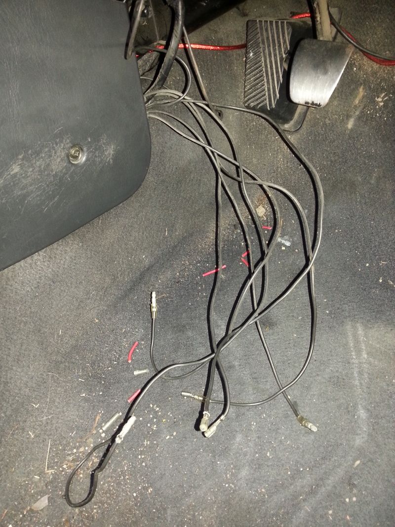

turbominicooper Posted March 14, 2015 Author Posted March 14, 2015 ive had a further look and wtf are all these earths for? they look like they bridge to each other?? Quote
turbominicooper Posted March 15, 2015 Author Posted March 15, 2015 sound so after unbridging all 8 of them eartn wires ive dropped the drain from -0.58 to -0.34 but ive literally tested every connector and cannot find this last bit. grrrrr Quote
