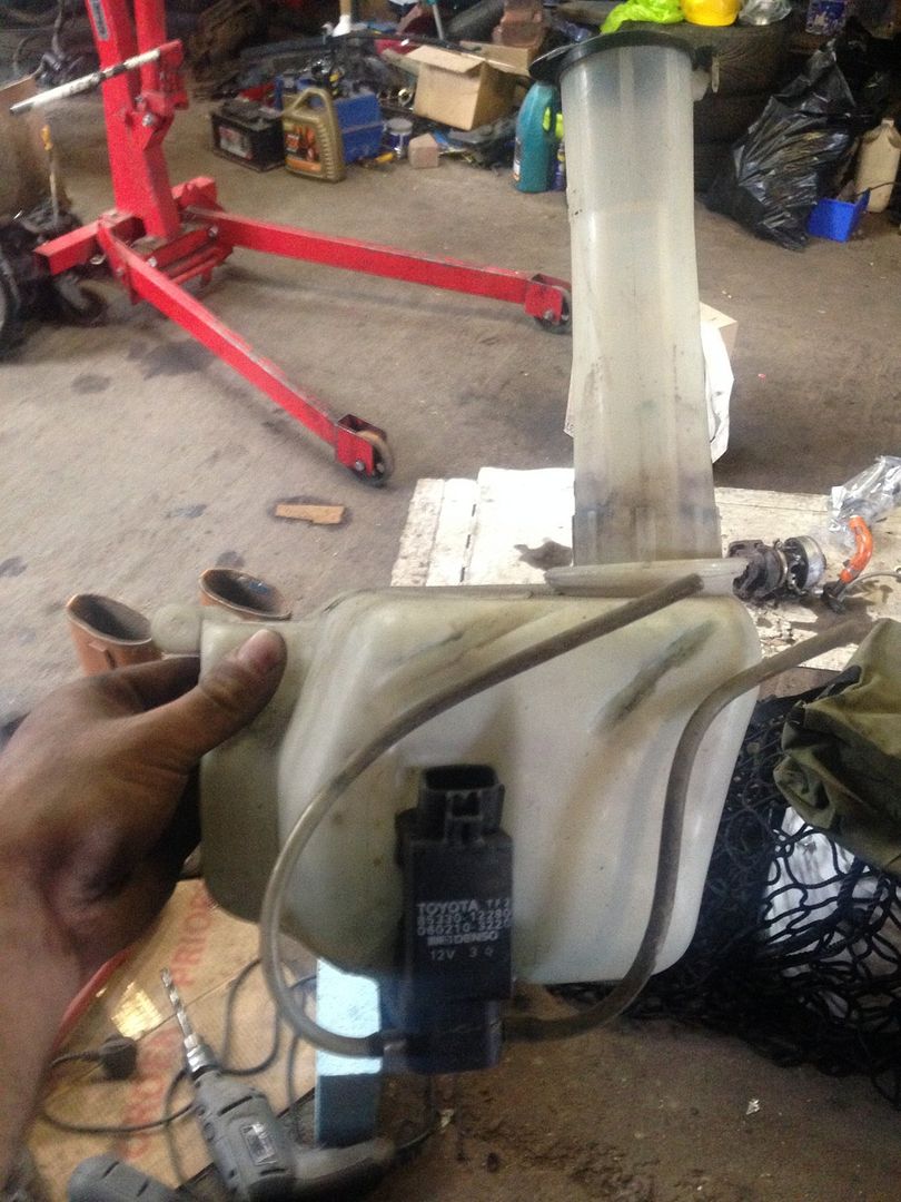

4efteboost Posted May 26, 2015 Posted May 26, 2015 Has anyone on here gone and put a glanza washer bottle and expansion tank in an ep82? Have got a top mount manifold and need the room for a filter on drivers side. Have read the glanza bottles are the same as an abs equipped ep82 but still not sure. And if you have how did you go about moving the plug for the washer pump over to the otherside of the engine bay Quote
Flaminsam Posted May 27, 2015 Posted May 27, 2015 I have a washer bottle from an abs ep82 which sits in the wheel arch on the passenger side if that's any good to you? As for the wiring can't help you with that one. Could just extend the wires so they reach the other side? Same as the pipes? Quote
4efteboost Posted May 27, 2015 Author Posted May 27, 2015 Is it cool of you could pm me a pic of the bottle please? And yeah was thinking the same with the wiring and extending it back through the conduit Quote
daniel_g Posted May 27, 2015 Posted May 27, 2015 I replaced the engine loom in my old GT with a non ABS loom, the car did originally had ABS (which i removed) and i had to extend the washer pump wires, its only 3 wires just run them up under the front cross member, theres already a loom there so you can tuck the wires beside that. Quote

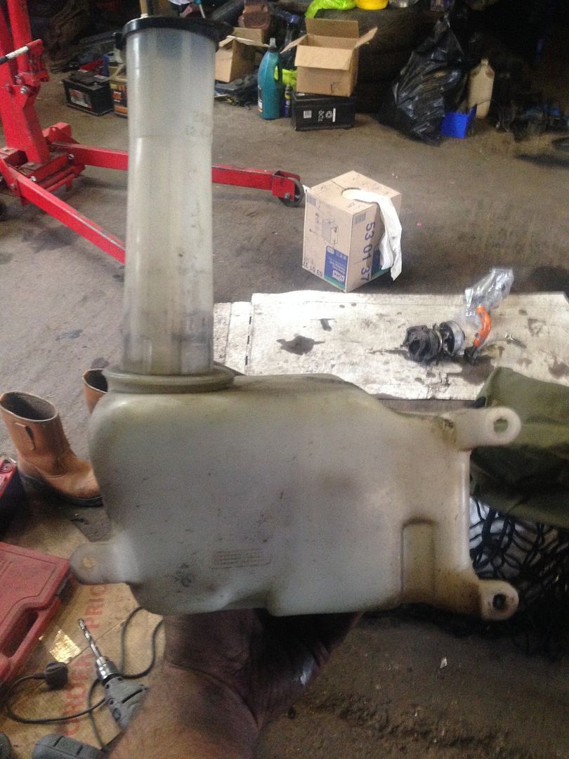

Flaminsam Posted May 27, 2015 Posted May 27, 2015 Il get you a picture at weekend if that's ok? I'm away on a course at the moment so can't take a pic. Quote
4efteboost Posted May 27, 2015 Author Posted May 27, 2015 yeah weekend is cool man cheers, managed to bodge my non abs expansion tank in over by the battery but is covering the hole where the abs versions washer bottle neck pops up through the body work so need to see if a glanza expansion tank will fit Quote
4efteboost Posted June 1, 2015 Author Posted June 1, 2015 (edited) Yeah defo the one I need, might have to get that off you at the end of the month how much you want for it? Edited June 1, 2015 by 4efteboost Quote
