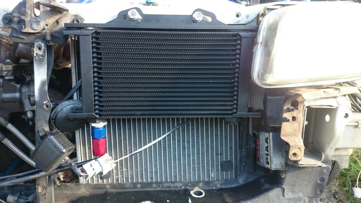

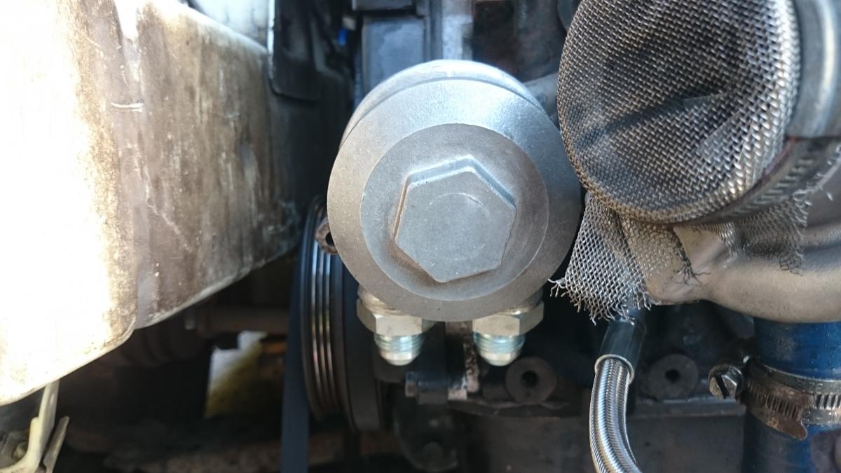

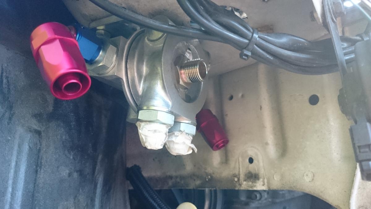

akyakapotter Posted August 1, 2015 Posted August 1, 2015 (edited) OK so got everything mounted but have no idea how to plumb it up right please help Edited August 1, 2015 by akyakapotter Quote
karl. Posted August 1, 2015 Posted August 1, 2015 The two coming out of your filter housing will go to the two red and blues on the thermostat plate. The two coming out of it will go to the cooler. From what I've read you should mount the cooler so that it doesn't drain when it's not running. Quote
akyakapotter Posted August 1, 2015 Author Posted August 1, 2015 It's a thermostat sandwich plate attached to a filter relocation I dont want to plumb it in and not get any oil flowing round the engine. I'm so confused lol Quote
