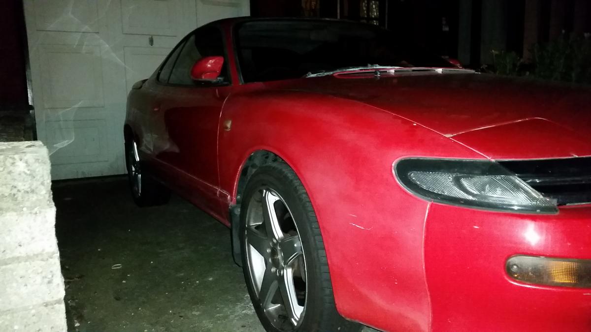

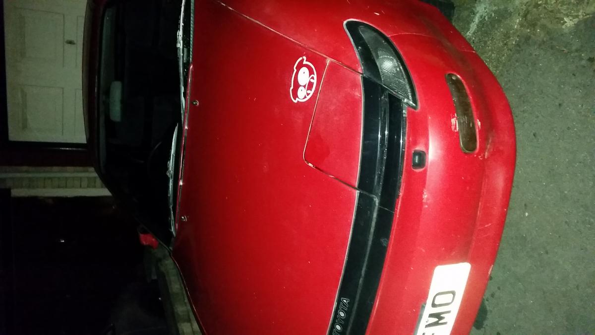

Last Sunday evening, this turn up on the drive. I drove 100 miles to pick it up and was very stressed as car temperature kept going up and down + power steering leaking. Anyway managed to get home in one piece and car is sound in the yard.
So now starts 3SGE project D.????

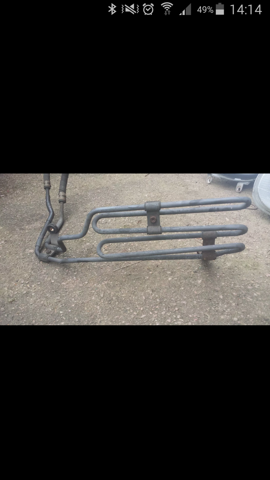

The power steering fluid was splashing on the radiator and coolant was low too , so I guess this was the issue. The car does not smoke or have any funny smell from exhaust and power was great on my drive back. 7rpm gear changes no problem and not sluggish at all. I might also add a high flow aluminium radiator on the to get list.😆 Edited by TRD
Yeah I've got an mr2 now just an n/a so same engine as yours basically! Love it so much fun to drive suprisingly revvy engine
Changed the rusted power steering cooler with a gt4 used one and took me 4 hours to get it right and modify for it to fit. Also gave the radiator a flush and wiped all the dirt. Car drives fine now and temp gauge just sitting under 90°. Drove around locally in traffic to make sure all works as usual and temp didn't budge ☺. Feeling happy. I'll get pictures soon.
Below is the one for gt4 I received.post-5063-0-14841900-1450566344_thumb.pn

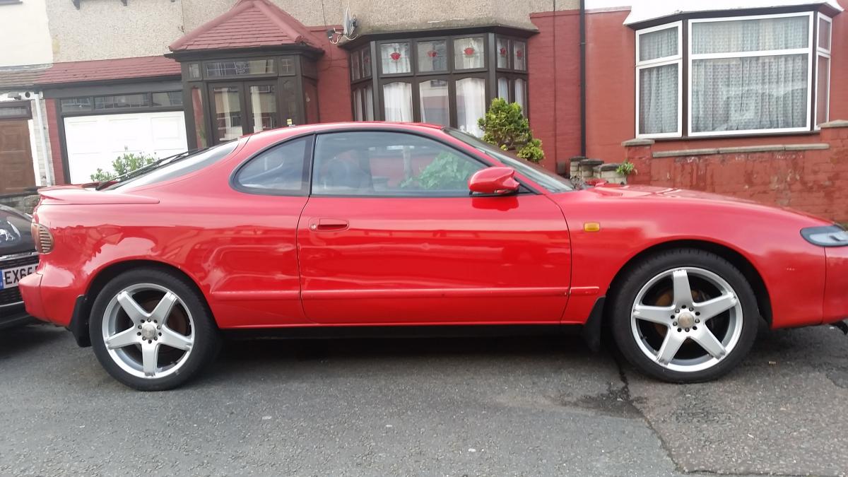

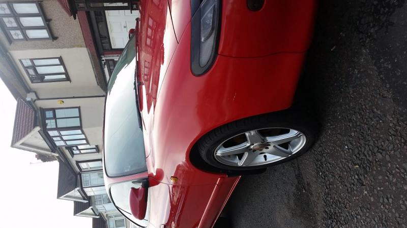

Gave the car a good buff up taking out the fade before winter storage. Then applied a paint protector "diamondbrite" to hopefully keep the shine and avoid fading again

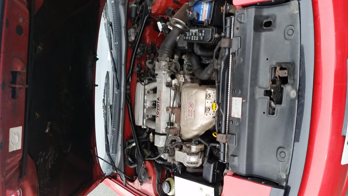

First thing is get the engine a treat.

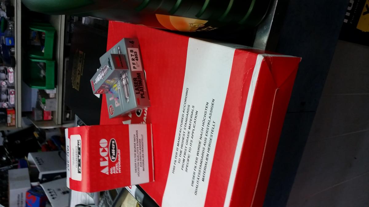

So I bought water pump , timing belt, tensioners , Belts ( power steering , alternator ) , platinum spark plugs , fully synthetic oil and changed all fluids as as such. Anti freeze , brakes fluid , power steering fluid etc... Big hole in the pocket but hey what's the use of a sweet ride without a sweet running engine ????
post-5063-0-36850400-1455987919_thumb.jppost-5063-0-98216300-1455987951_thumb.jppost-5063-0-07608200-1455987989_thumb.jppost-5063-0-89244100-1455988024_thumb.jppost-5063-0-86047400-1455988055_thumb.jp
It's so clean and amazing to drive .
