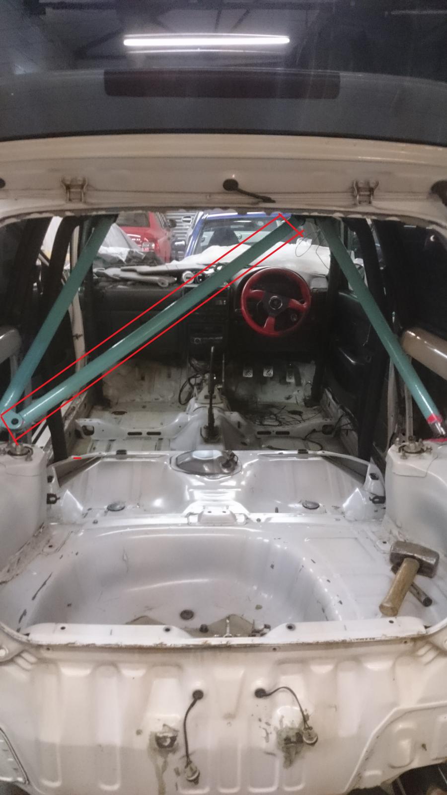

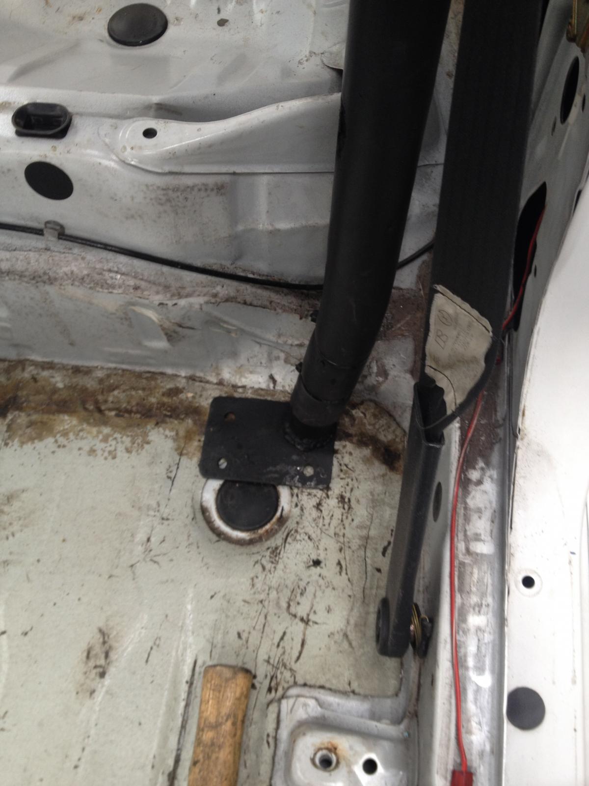

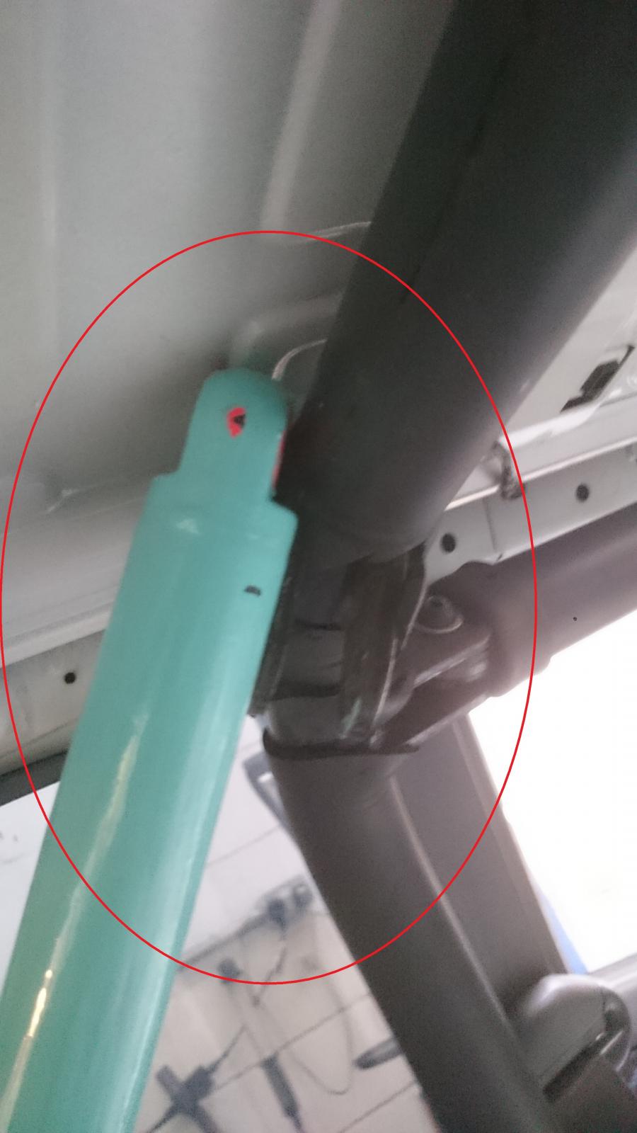

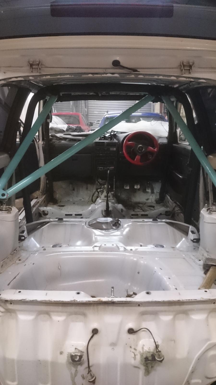

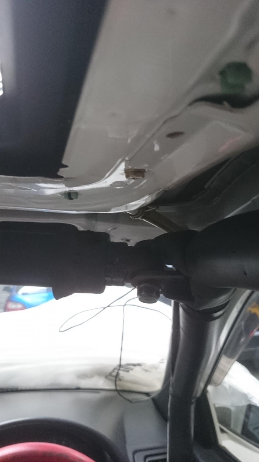

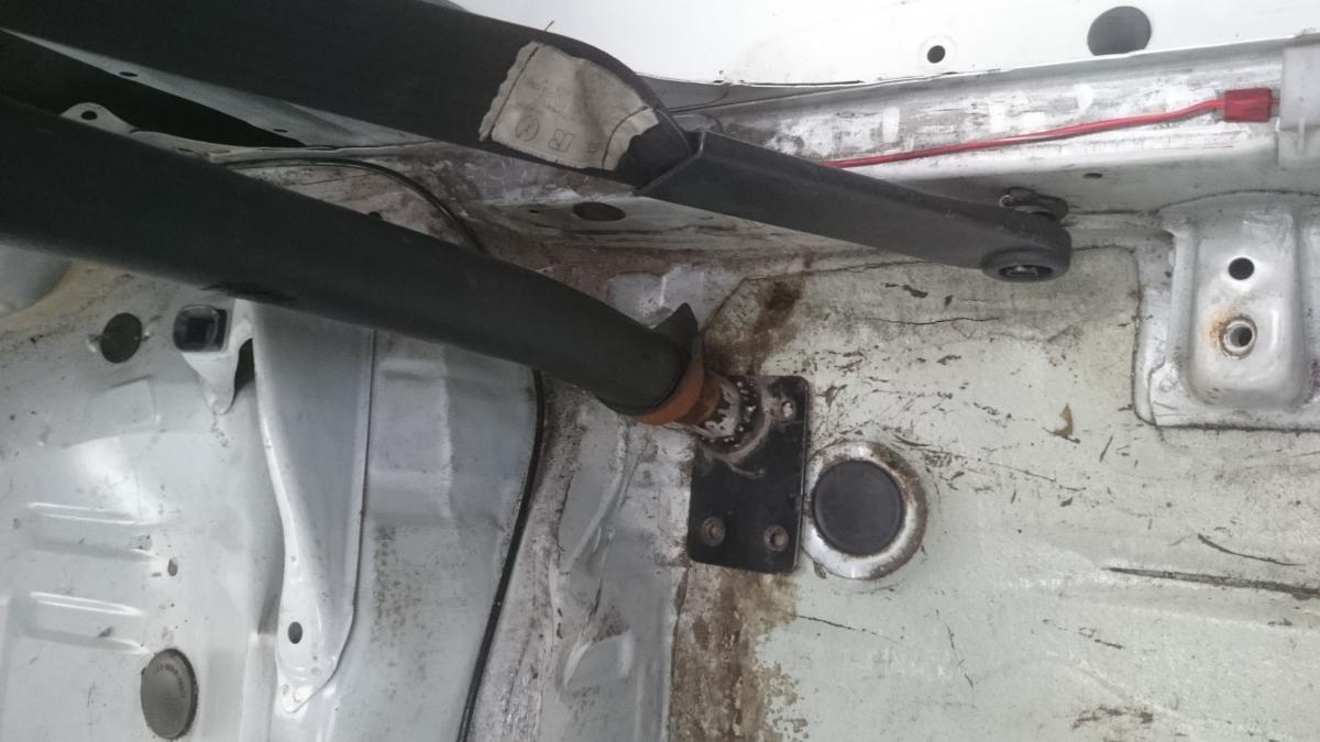

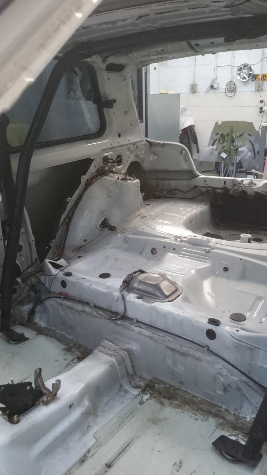

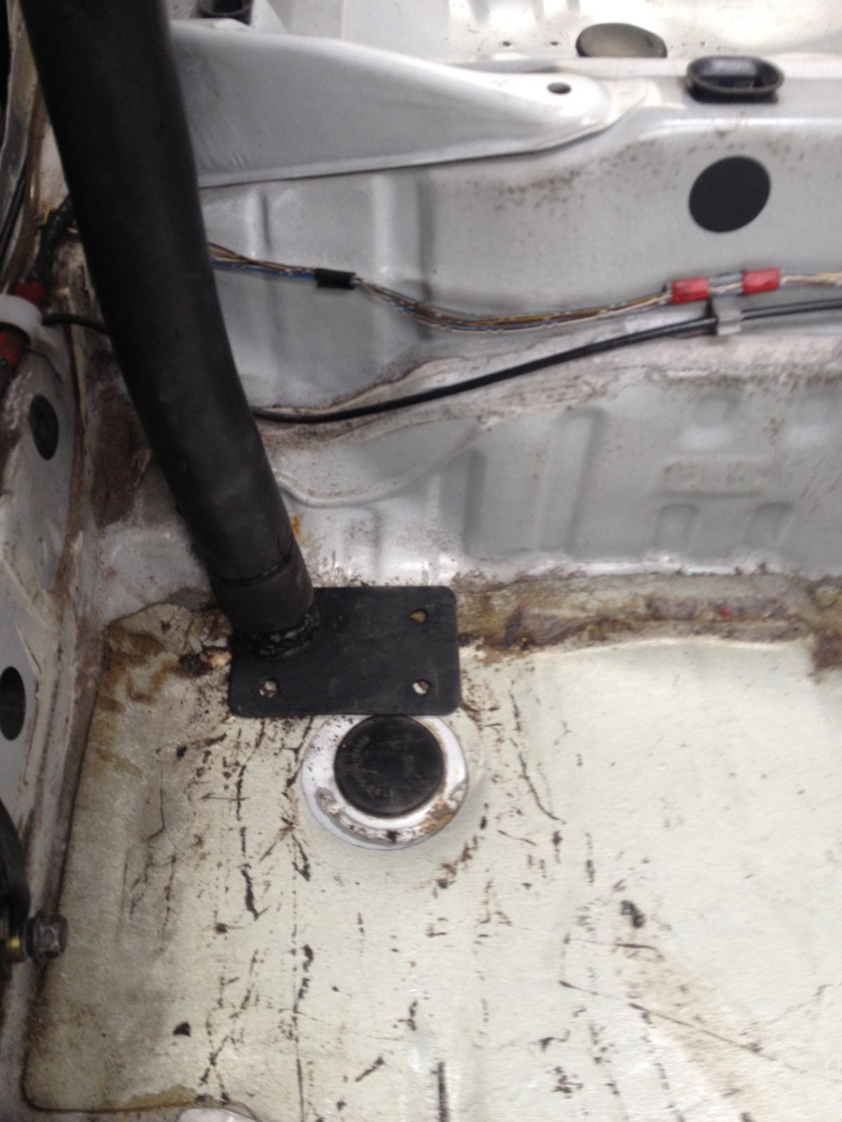

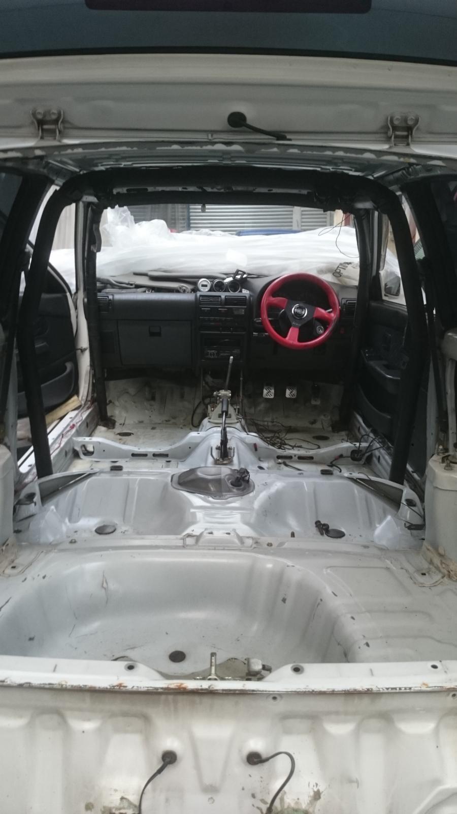

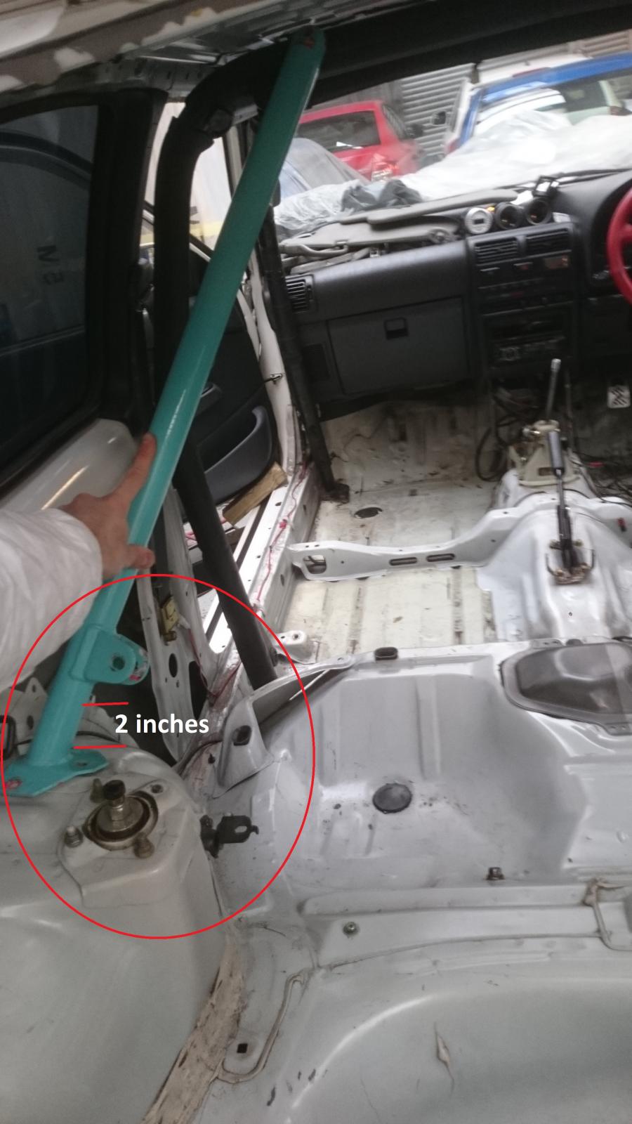

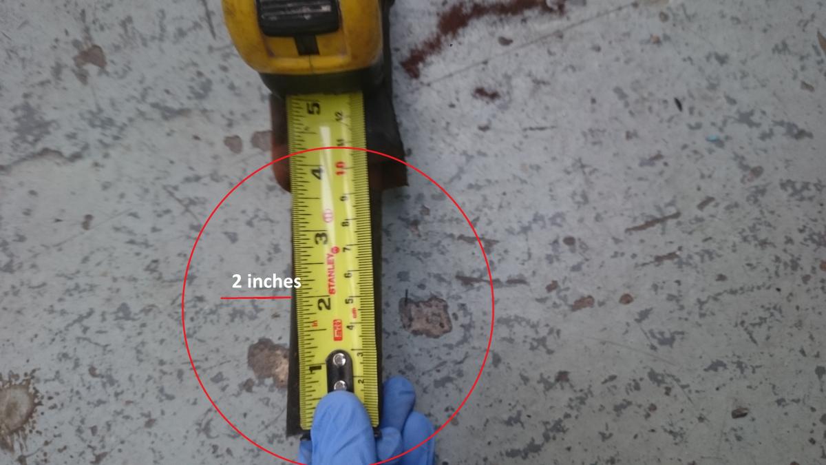

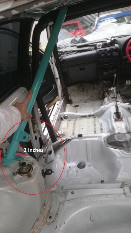

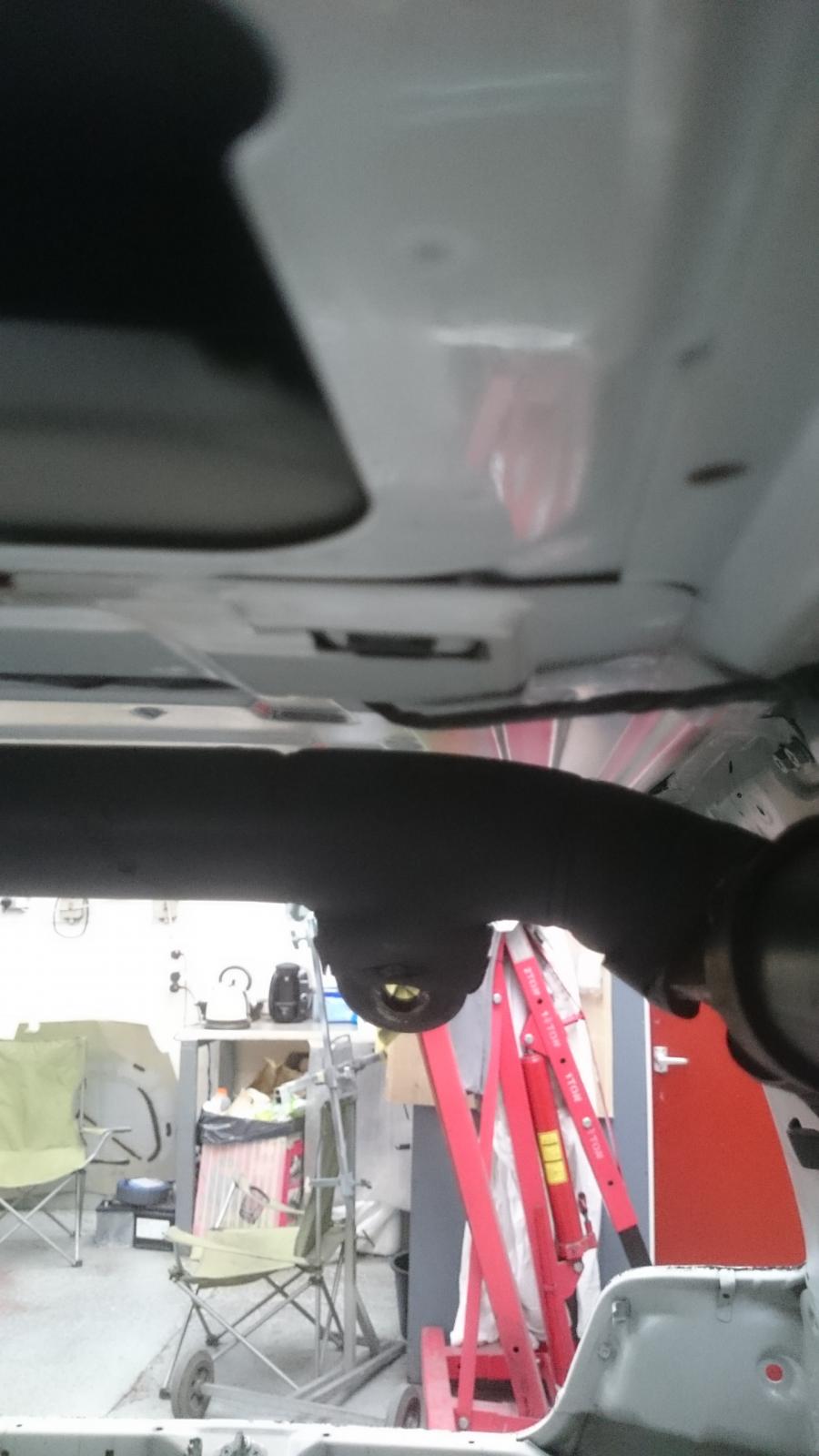

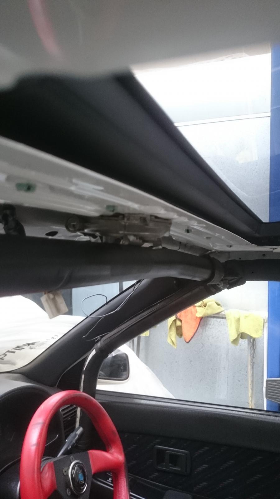

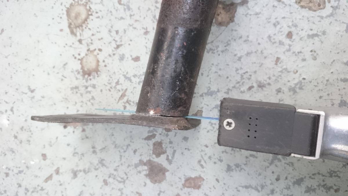

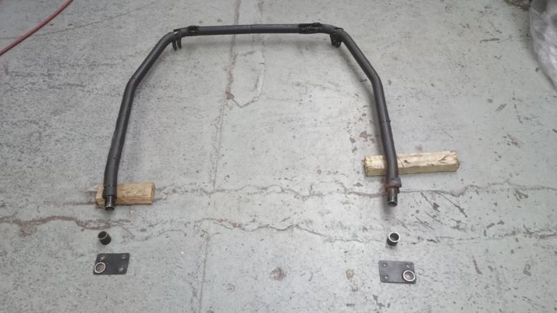

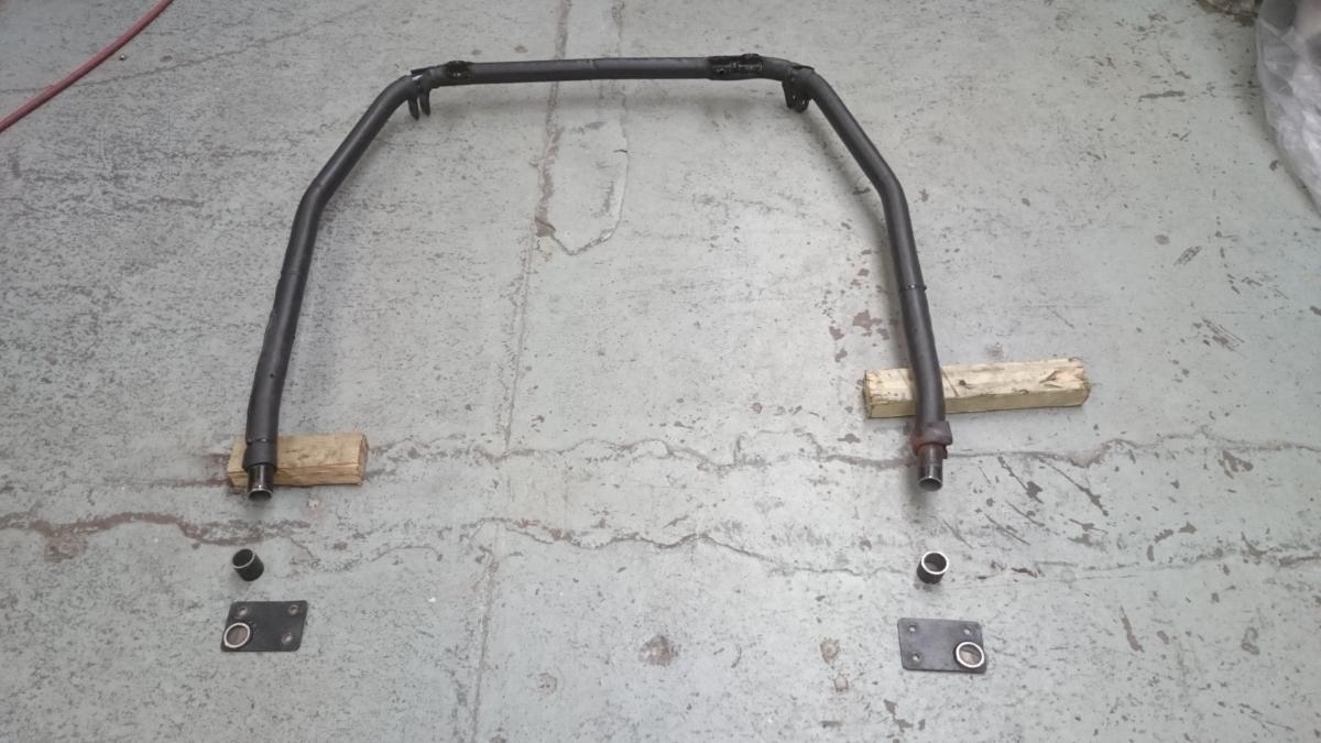

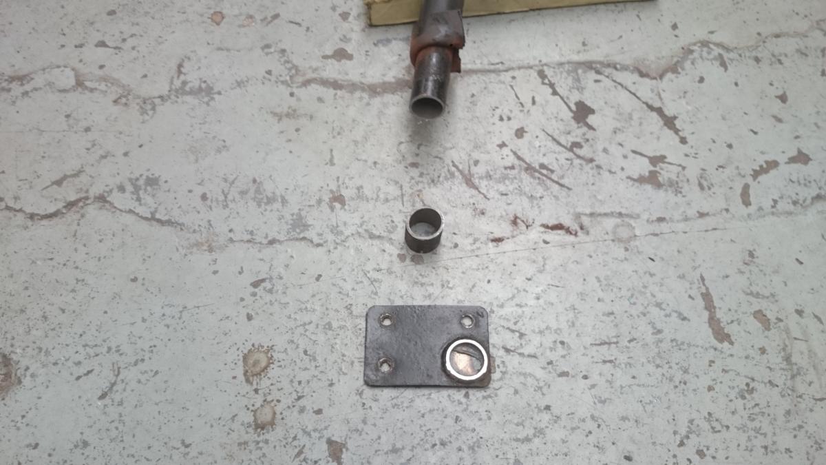

starletezy Posted December 29, 2015 Posted December 29, 2015 (edited) So I have seen a lot of people asking how do you fit an Cusco non sun roof roll cage into an sun roof model and is it a lot of work well I hope I can answer that question for you guys it does take a lot of work and wouldn't recommend doing it your self if you don't have any fabrication skills. all four rear pillars will need to be cut two inches to bring the cage down the reason being the sun roof tray intrudes the cockpit by around two inches the tray wont come out due to being welded and bonded on so the only option is to cut and weld the roll cage. The two front pillars don't need to be cut it just about clears the sun roof motor I have put together some step by step images on how to modify the cage below As you can see pictures the B pillar section of the cage wont fit as the tray above is in the way The bottom of the B pillar post needs to be brought down by 2 inches once the bottoms have been cut off the cage will need to be put back in the car to be mocked up just incase any changes are needed once the cage is in an mocked up and sits nicely take it out and tack weld the bottoms back on Bottoms tack welded on The run roof motor clearance is just about so no modification needed The clearance on top rear B pillar post should look like this So now on to the rear posts as the B pillar posts were brought down 2 inches they will need to come down as well As you can see there way off! If you have a 7 point cage like mine the cross bar wont need cutting thankfully Once you have everything tacked on and lined up weld all four posts up properly I would recommend taking it to a professional welder Edited May 15, 2016 by starletezy Quote

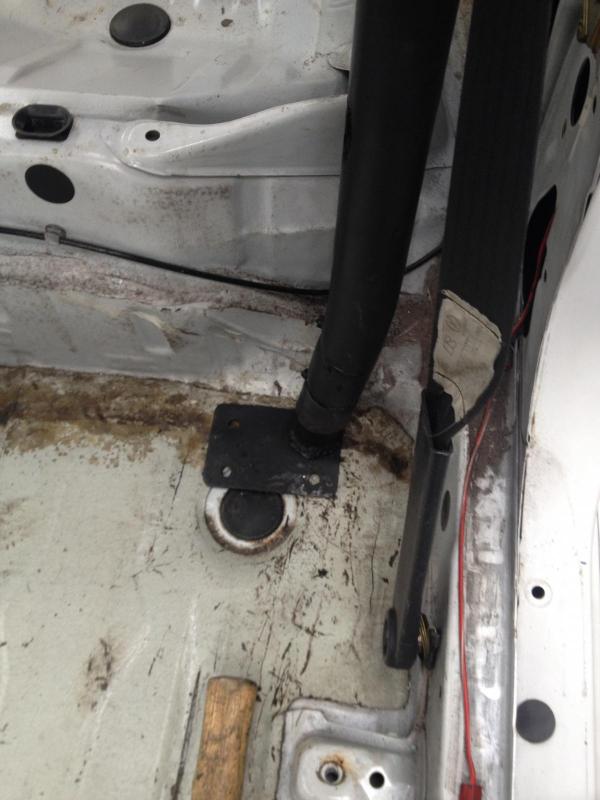

5e colin Posted December 29, 2015 Posted December 29, 2015 your not reinforcing the chassi where the cage bolts down ??? the way its now the cage is just for show and has no safety feature really Quote
starletezy Posted December 29, 2015 Author Posted December 29, 2015 your not reinforcing the chassi where the cage bolts down ??? the way its now the cage is just for show and has no safety feature really cage is mocked up in the pictures mate not bolted down yet and yes I have got all the reinforcement pates needed to reinforce the chassis its not for show... Quote

abbott Posted December 29, 2015 Posted December 29, 2015 Hi dude im glad you got it fitted shame it was a little hassel. But i would also sleeve the main hoop after its welded for extra strenth. But thats my advise. Fair play tho as most people would give up Quote
Flynn Posted December 29, 2015 Posted December 29, 2015 What do you mean by "sleeve" abbott? Sorry not a term I'm familiar with lol Quote
starletezy Posted December 30, 2015 Author Posted December 30, 2015 Hi dude im glad you got it fitted shame it was a little hassel. But i would also sleeve the main hoop after its welded for extra strenth. But thats my advise. Fair play tho as most people would give upCheers buddy just takes abit of patience all worth it seeing the end result sleeve were the plates sits at the bottom? Quote

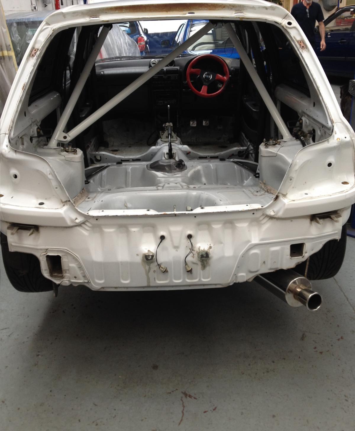

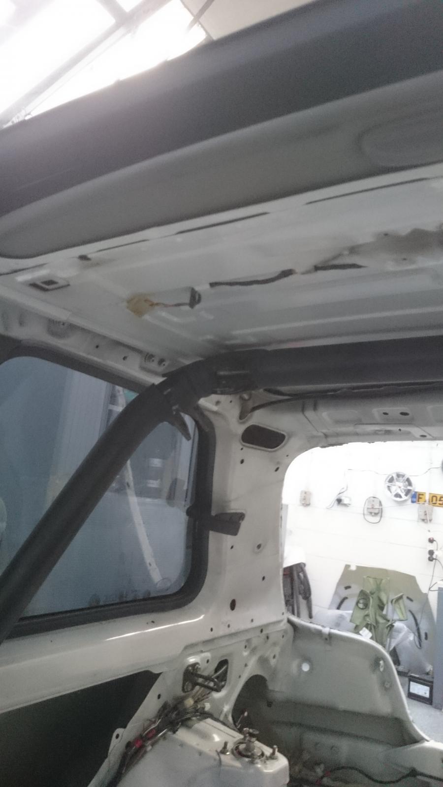

turbo-fever Posted December 31, 2015 Posted December 31, 2015 Had this done to mine few months ago only down side is the cage sits lower then normal so more prone to banging your head lol Quote
Flynn Posted December 31, 2015 Posted December 31, 2015 Does it sit a bit on the piss along the length of the car, can't really see from the picture?Used to twat my head on the cage when it was in my SR so kind of got used to ducking in......still do it now out of habit lol Quote
starletezy Posted December 31, 2015 Author Posted December 31, 2015 (edited) Thats why you put foam around the roll cage lol Edited December 31, 2015 by starletezy Quote
turbo-fever Posted January 5, 2016 Posted January 5, 2016 Does look a bit pissed but it's tight to the roof all the way along its just the way the bars sit Quote
starletezy Posted January 6, 2016 Author Posted January 6, 2016 Does look a bit pissed but it's tight to the roof all the way along its just the way the bars sit Looks good mate Quote
Flynn Posted January 6, 2016 Posted January 6, 2016 Is that centre bar bang up against the roof, the big hoop one? Quote
starletezy Posted January 7, 2016 Author Posted January 7, 2016 Is that centre bar bang up against the roof, the big hoop one? No mate it clears the roof by 2cm so I would say its bang on Quote

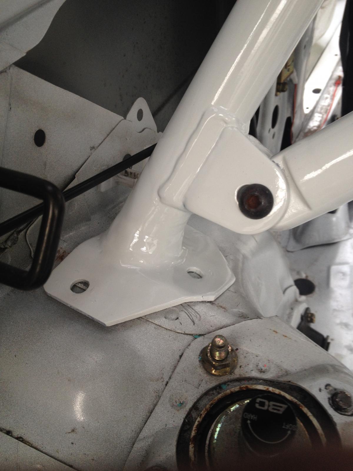

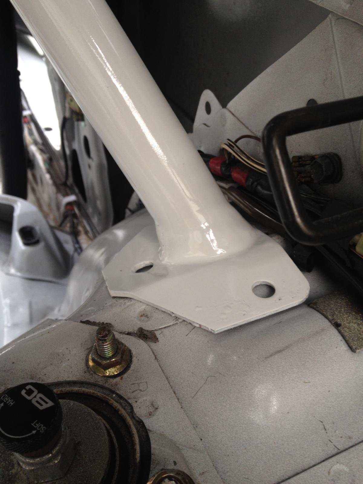

starletezy Posted May 15, 2016 Author Posted May 15, 2016 Update cage stubs welded painted and fitted Quote
