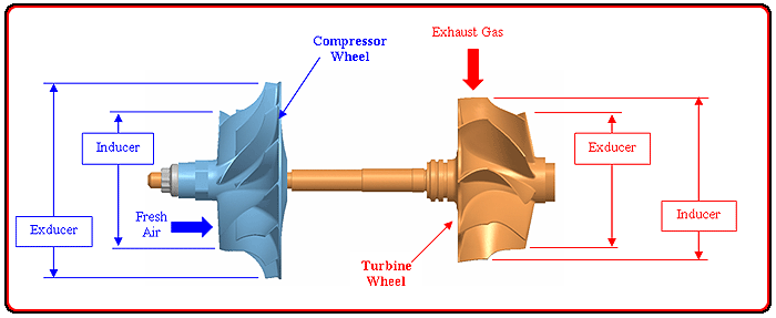

ep82paul Posted April 7, 2016 Author Posted April 7, 2016 Just been reading about measuring inducer exducer do I measure back of compresser wheel or the blades never done this before cheers Quote
5e colin Posted April 8, 2016 Posted April 8, 2016 (edited) like this ( google pic ) Edited April 8, 2016 by 5e colin Quote
ep82paul Posted April 8, 2016 Author Posted April 8, 2016 Thought so cheers ill do that tomorrow with a micrometer I used my car today it only smokes when you let of the throttle smells like burning oil then it will smoke on tick over till you go again smoke goes let off throttle it's back I had a look under the bonnet looks like oil weeping past manifold 1st exhaust port near cam any ideas Quote
