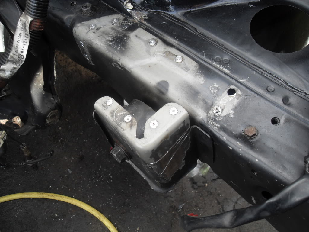

loz180691 Posted May 8, 2016 Posted May 8, 2016 I have just relocated my battery to the boot and was wondering with the metal base in the engine bay can that be cut out to tidy up bay? Quote
Flaminsam Posted May 9, 2016 Posted May 9, 2016 Metal base? I don't think they have a base as such as the battery sits on top of the gearbox mount in a plastic tray? Do you have a picture to explain what part you mean. Quote
Socks Posted May 9, 2016 Posted May 9, 2016 If your talking about the little plate welded onto the chassis leg that the plastic battery tray sits ontop of. You can remove it but be careful as your gearbox mount is just underneath! Quote
loz180691 Posted May 9, 2016 Author Posted May 9, 2016 But doesn't the metal around the bolt for gearbox mount support it? Quote

starletezy Posted May 11, 2016 Posted May 11, 2016 Yeah a few spot welds only thing is if you take the battery plate off you will weaken the gear box mount right under it I would leave it alone Quote
starletezy Posted May 11, 2016 Posted May 11, 2016 That section is what is holding the mount in place mate Quote
Ollieh17 Posted May 11, 2016 Posted May 11, 2016 From what i remember the mount sits under the chassis leg? The battery tray is just a skin on top Quote
starletezy Posted May 11, 2016 Posted May 11, 2016 No mate the plate its self is apart of the engine mount its spot welded to the chassis leg and battery plate Quote

starletezy Posted May 11, 2016 Posted May 11, 2016 It is possible to remove it but you will just need to make a custom bracket to hold the engine mount Quote
Ollieh17 Posted May 11, 2016 Posted May 11, 2016 Some upload a photo of what it looks like. Cant remember for the life of me hoe it goes. But doesnt to me look like the battery tray provides any support Quote
starletezy Posted May 11, 2016 Posted May 11, 2016 Will take a pic of it later for you mate you will know what I mean once you see it Quote
starletezy Posted May 11, 2016 Posted May 11, 2016 Managed to pull out a photo posted on here couple years ago. As you can see when removed the battery tray is partly an engine mount Quote
