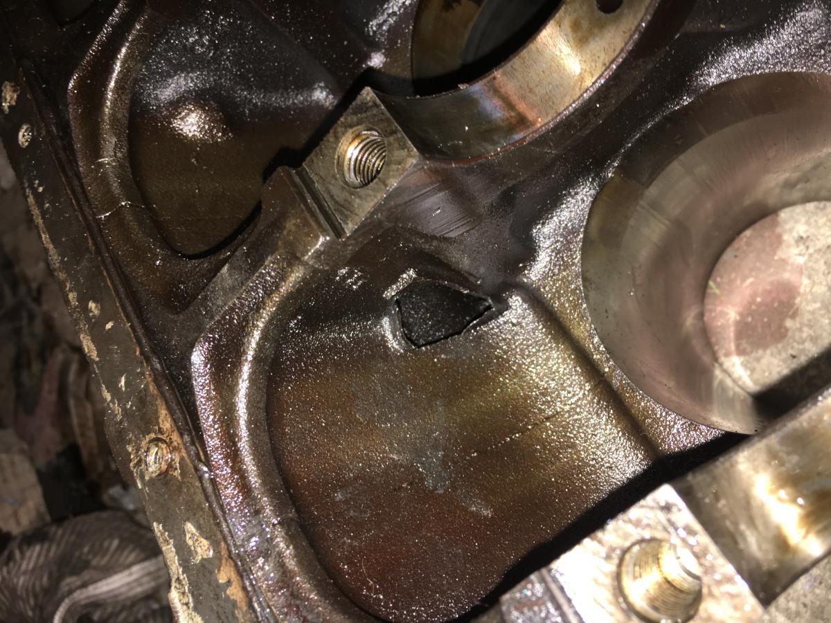

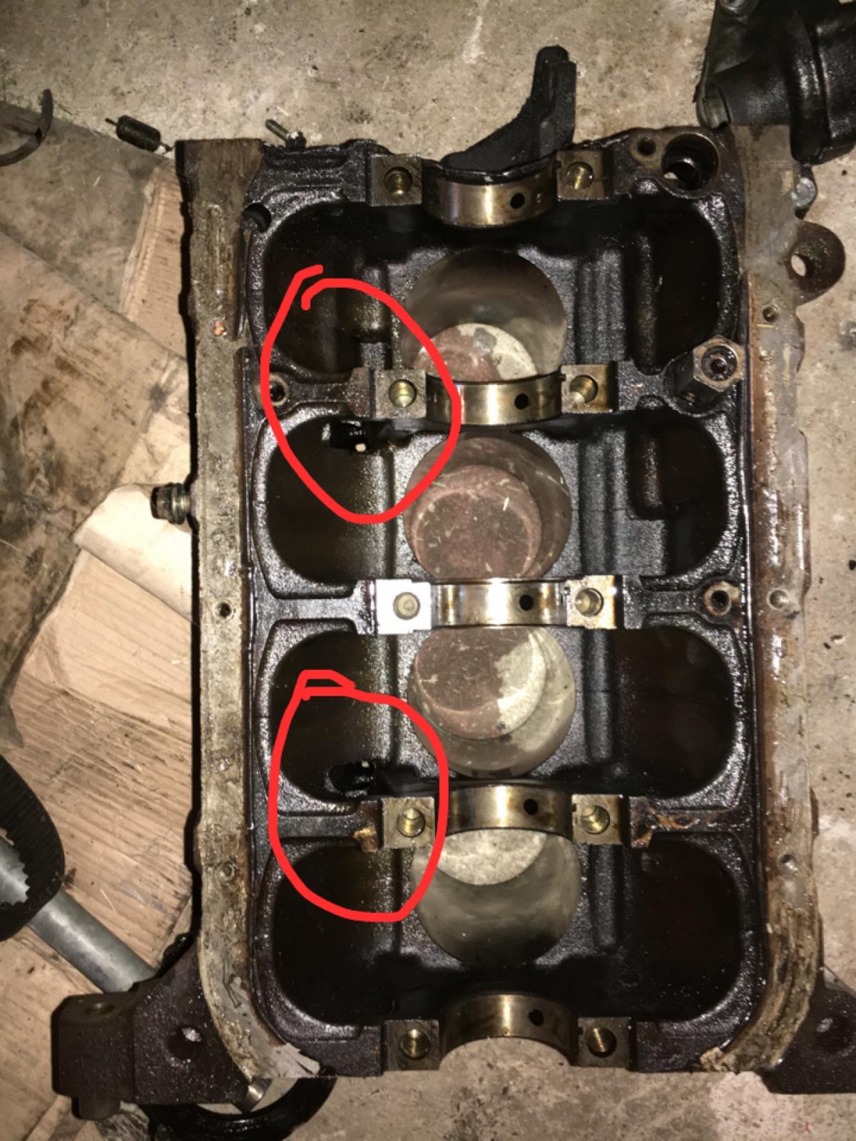

SpikeyJp_68 Posted May 30, 2016 Posted May 30, 2016 Right lads bought an fte engine the other day and saw a hole at the bottom of the block and thought it was fucked. I've since taken the crank out and I've noticed there's 1 at each end. The holes at first looked to be sharp edged as if they were damaged. But looking at it closer the holes are pretty much identical so makes me think they're supposed to be there ??? Quote
morgey Posted May 30, 2016 Posted May 30, 2016 Oil drains from the head. The thin sharp edges are just flash in the casting. You can file that off if you wanted to Quote
SpikeyJp_68 Posted May 30, 2016 Author Posted May 30, 2016 (edited) So it comes like that as standard ? Thought it was knackered with the edges being so rough I couldn't imagine Toyota leaving it like that. Cheers pal Edited May 30, 2016 by SpikeyJp_68 Quote
morgey Posted May 30, 2016 Posted May 30, 2016 Yup. Mass produced so dont have time to clean them all up. Plus its only to allow oil to run down. It wint be a restriction or anything Quote
SpikeyJp_68 Posted May 30, 2016 Author Posted May 30, 2016 Yup. Mass produced so dont have time to clean them all up. Plus its only to allow oil to run down. It wint be a restriction or anythingFeel rather silly now.... Quote

starletezy Posted May 31, 2016 Posted May 31, 2016 The holes look dreadful but they do the job lol you could clean them up to get a better flow Quote
SpikeyJp_68 Posted May 31, 2016 Author Posted May 31, 2016 The holes look dreadful but they do the job lol you could clean them up to get a better flowMight do that. Just a file job is it ? Quote
