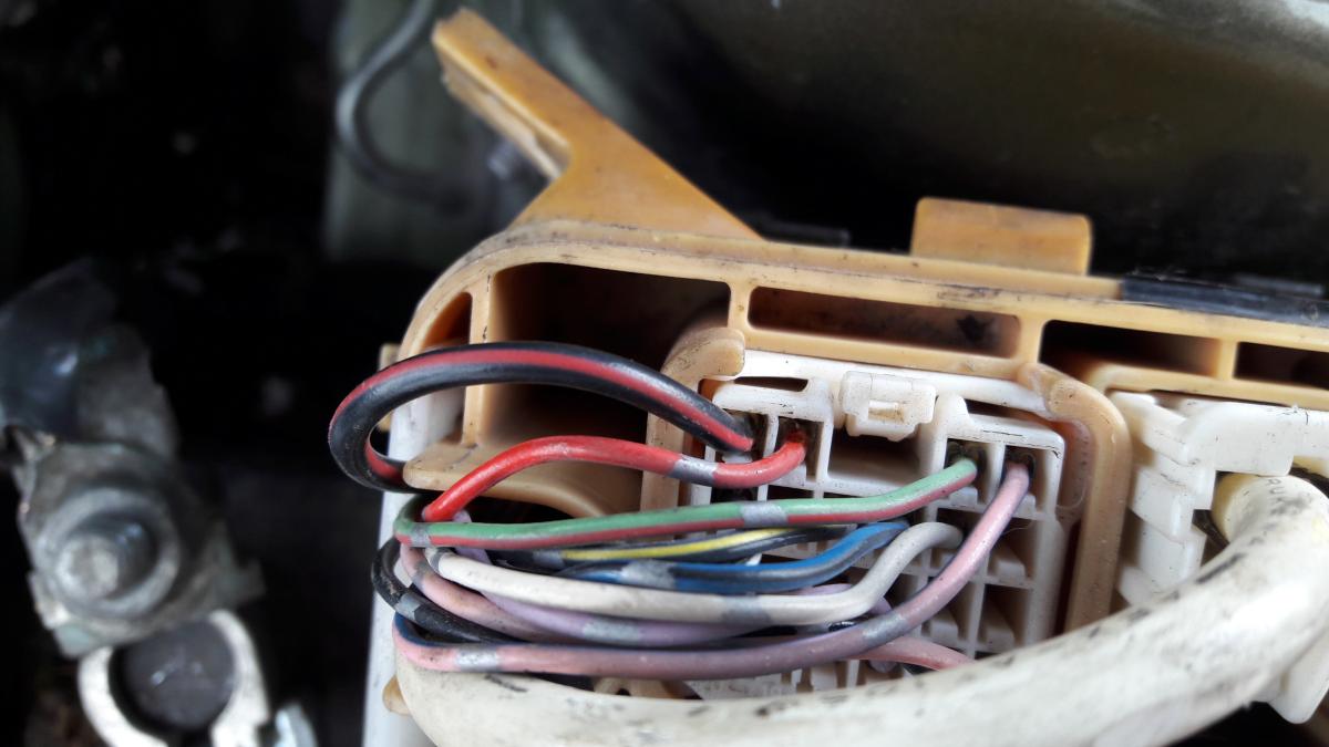

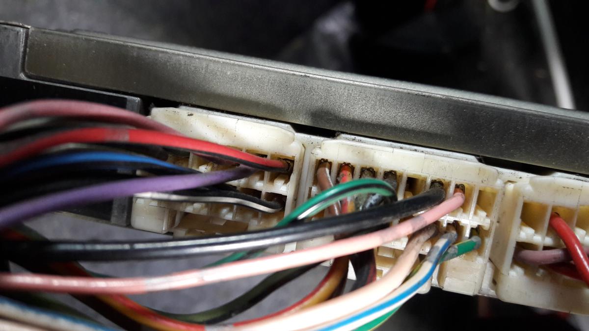

SpikeyJp_68 Posted April 9, 2017 Author Posted April 9, 2017 Okay so, trigger wire isnt getting 12v.I have continuity between the trigger plug and the wire in the fusebox as shown (black and red) Altgough i have not got contunuity between the fusebox wire and the black and red wire on the 12p plug on the ecu as shownI also tested behind the wing and no continuity between it and the fusebox however i get a short beep on the wire next to it ? Sounds to me as if theres a loose connection in the fusebox maybe ?? Quote
5e colin Posted April 9, 2017 Posted April 9, 2017 trace that black red wire under the dash fusebox check its fuse is ok to Quote
SpikeyJp_68 Posted April 9, 2017 Author Posted April 9, 2017 trace that black red wire under the dash fusebox check its fuse is ok to Okay ill have a look at that. Pit 12v directly to the starter and it works for its not the starter Quote
