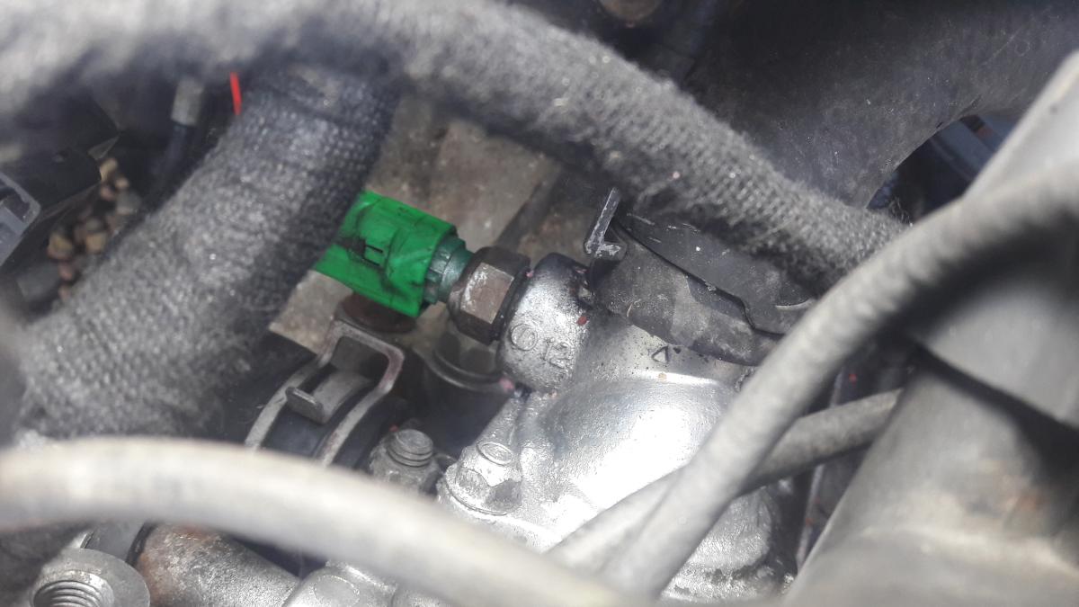

SpikeyJp_68 Posted May 1, 2017 Posted May 1, 2017 (edited) Hi guys, got round to reading the fault codes on my car except im not sure exactly what its telling me. I beleive it to be no.22 which is coolant temp sensor (is reluctant to start when cold).Ive attatched a video below and then the fault code link from tggt.com. Any help greatly appriciated. https://m.youtube.com/watch?v=SrrNpwTizcY&feature=youtu.be http://www.toyotagtturbo.com/forums/showwiki.php?title=EFI+self-diagnosis+system Edited May 1, 2017 by SpikeyJp_68 Quote

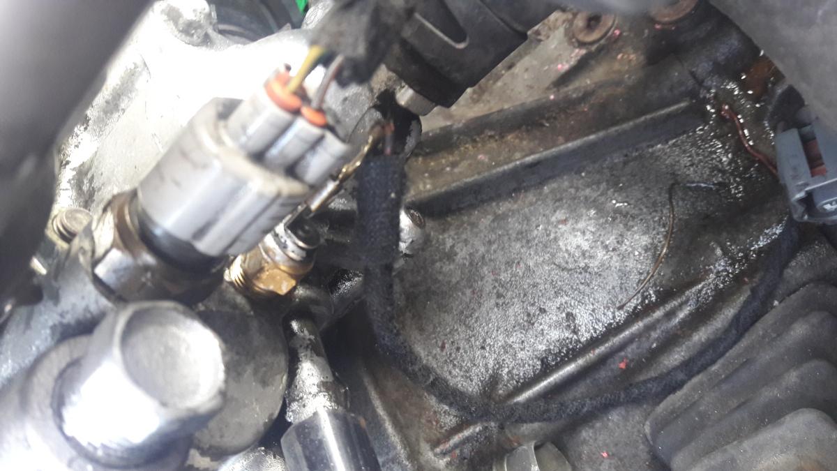

SpikeyJp_68 Posted May 1, 2017 Author Posted May 1, 2017 Cheers pal For the coolant temp semsor is it the green one in pic 1 or one of the 2 in pic 2 ?? Quote
gorganl2000 Posted May 1, 2017 Posted May 1, 2017 as said above codes 12 and 22 green one i think is for the fangray triangular one is for the ecu both are coolant temperature sensors in a way....but most like the gray one is the issue---car may not start if its disconnected if your fan is working, most likely the green one is ok the temp guage in the dash will read incorrectly if one of them is bad, but i cant remember which one Quote
patman Posted May 1, 2017 Posted May 1, 2017 Green one on mine is the ecu temp sensor that's on a ep82, if your not sure try get it started if you can let temp needle on dash raise abit pull one sensor out at a time and then check needle to see which one it goes down on that will be your temp sensor other will be your ecu temp one 👍🏻 Quote

SpikeyJp_68 Posted May 6, 2017 Author Posted May 6, 2017 Update for anyone with these code(s)22 is related to the grey ecu temp sensor - a new one fixes it.Code 12 will occur when, but not limited to, the car isnt being started with the key i.e sending 12v direct to starter trigger wire - sending 12v from the 'start, position on the key barrel will fix it in this case Quote
