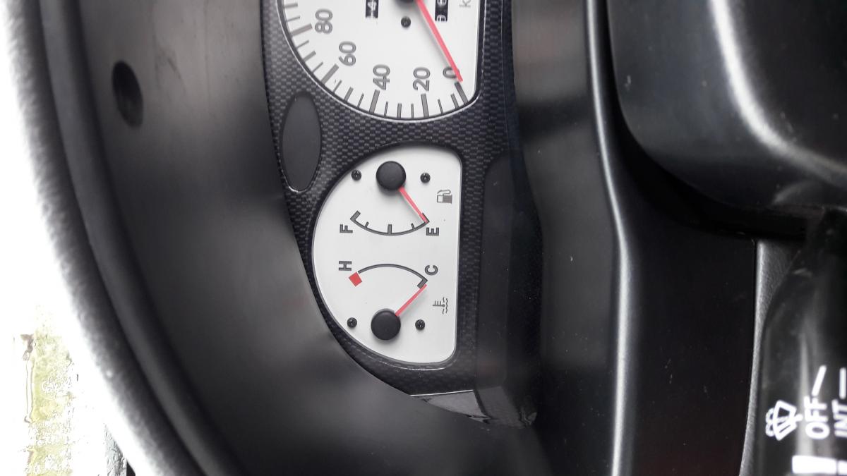

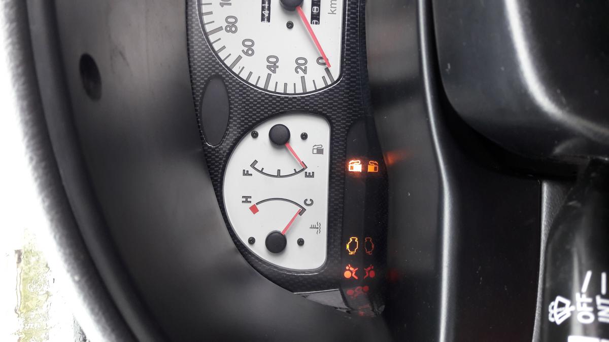

SpikeyJp_68 Posted June 5, 2017 Posted June 5, 2017 Temp gauge ignition offTemp gauge ignition onCar has been sat overnight so it is fully cold. Any ideas as to what is causing this ? Or is my needle set wrong ? When fully upto temp the needle sits inbetween the middle and hot Quote
gorganl2000 Posted June 5, 2017 Posted June 5, 2017 maybe temp sensor is going bad?...is the wire connection good?any diagnostic codes? Quote
5T4R7ET N/A Posted June 5, 2017 Posted June 5, 2017 its could be following if its been a warm day then in thoery could be picking up a bit of temperature instead of not moving when stone cold? or it always moves when the ignition is turned on? to show gauge has got power or the needle needs resetting, maybe it has been removed before Quote
SpikeyJp_68 Posted June 5, 2017 Author Posted June 5, 2017 (edited) Have just changed the ecu temp sensor. No fault codes runs spot on. I have had the needle removed to clean behind yes. Pictures were taken today in Ireland so its 7 degrees and raining haha. Was okay on my 96 spec clocks only seems to happen when i swithed to my 98 spec ones Edited June 5, 2017 by SpikeyJp_68 Quote
5T4R7ET N/A Posted June 6, 2017 Posted June 6, 2017 I would say the needle needles resetting then. You probably didnt put it back it exactly the right placeWhen cold the needle sits a lot lower than the marking on the consoleTake a look at some pictures of temp needle of other glanza's Quote
SpikeyJp_68 Posted June 6, 2017 Author Posted June 6, 2017 I would say the needle needles resetting then. You probably didnt put it back it exactly the right placeWhen cold the needle sits a lot lower than the marking on the consoleTake a look at some pictures of temp needle of other glanza'sCan someone show me where theres sit when cold in that case Should hopefully solve the problem Quote
