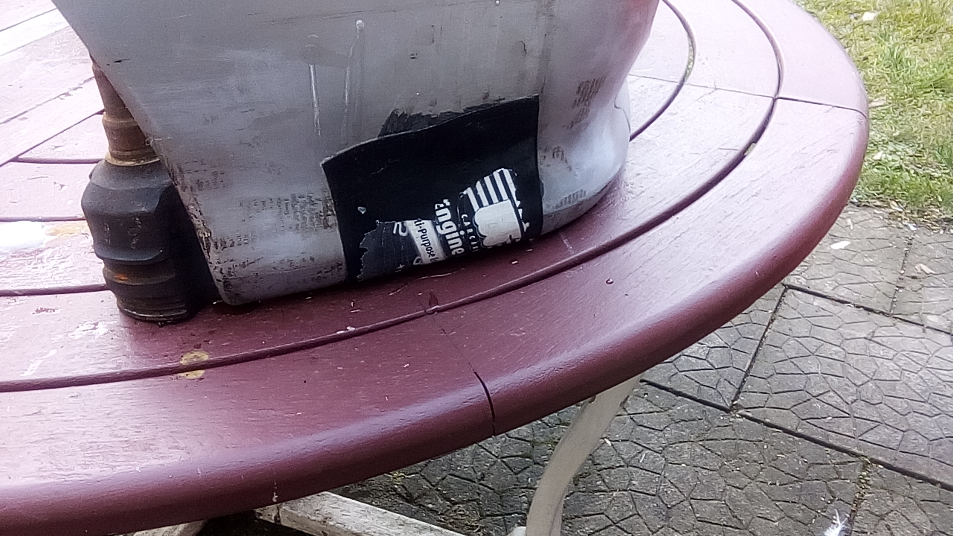

5e colin Posted October 11, 2017 Posted October 11, 2017 (edited) lads i need to fill a 5" hole in the bumper im sick of looking at it something needs fixing can yous give me some tips on bonding it without it peeling off Edited February 5, 2018 by 5e colin Quote

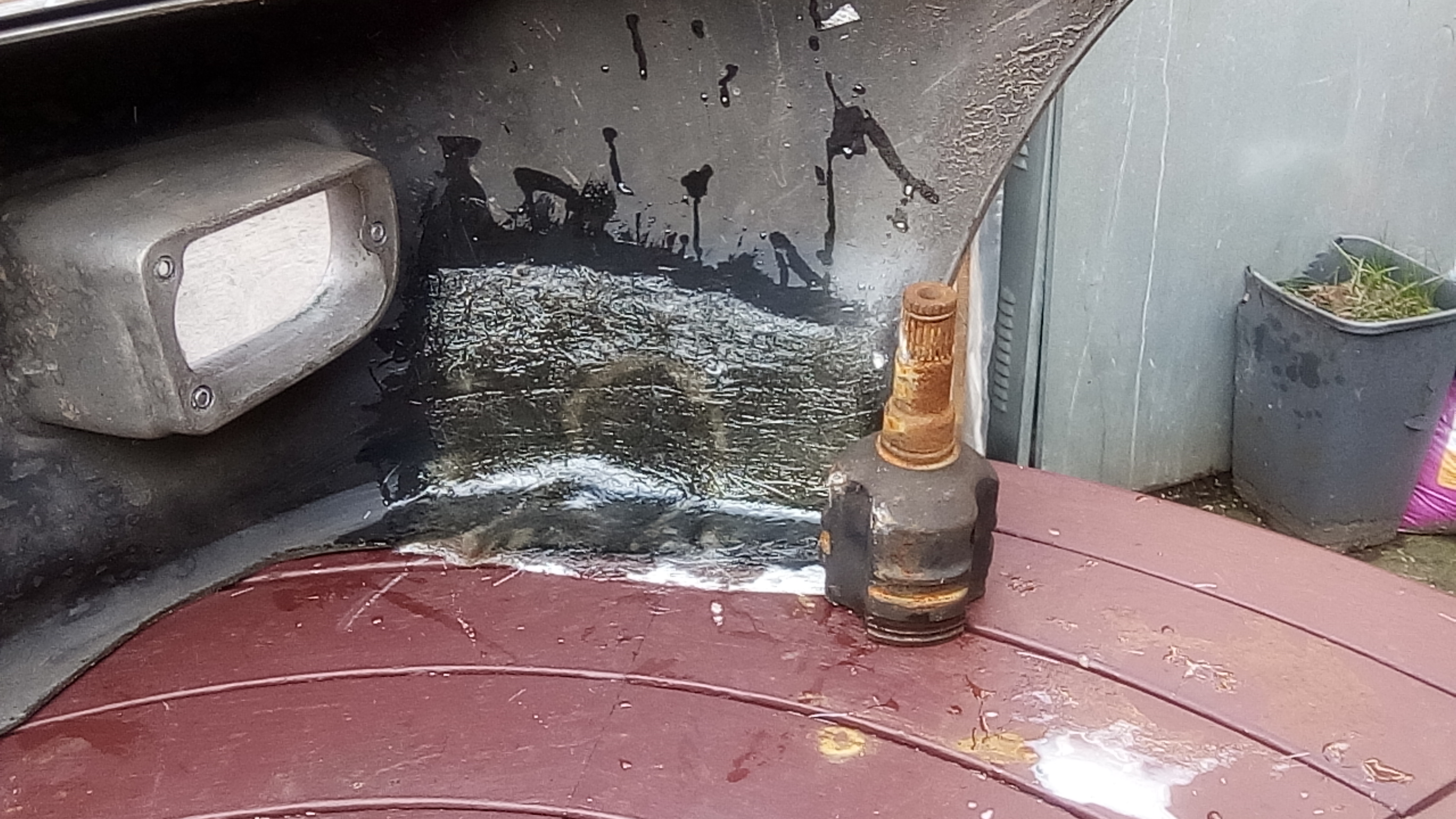

5e colin Posted February 9, 2018 Author Posted February 9, 2018 Did that 20 min after I took pic feck me the whole house stank like fibreglass the missis was not happy ha ha turned out OK ish needs some Sandi g and filler on the outside not bad for first time . better application tools would be handy like minni roller and bigger brush Quote
rob_bower Posted February 13, 2018 Posted February 13, 2018 A light keying with rough paper will help also a small drill bit through so they’re ar a few holes so some of the resin runs through can also help it grab. At that size I would have been tempted to mesh it to. Or just build a few layers of glass up. Quote
