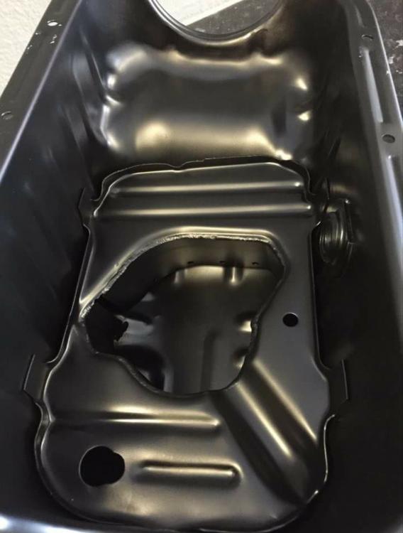

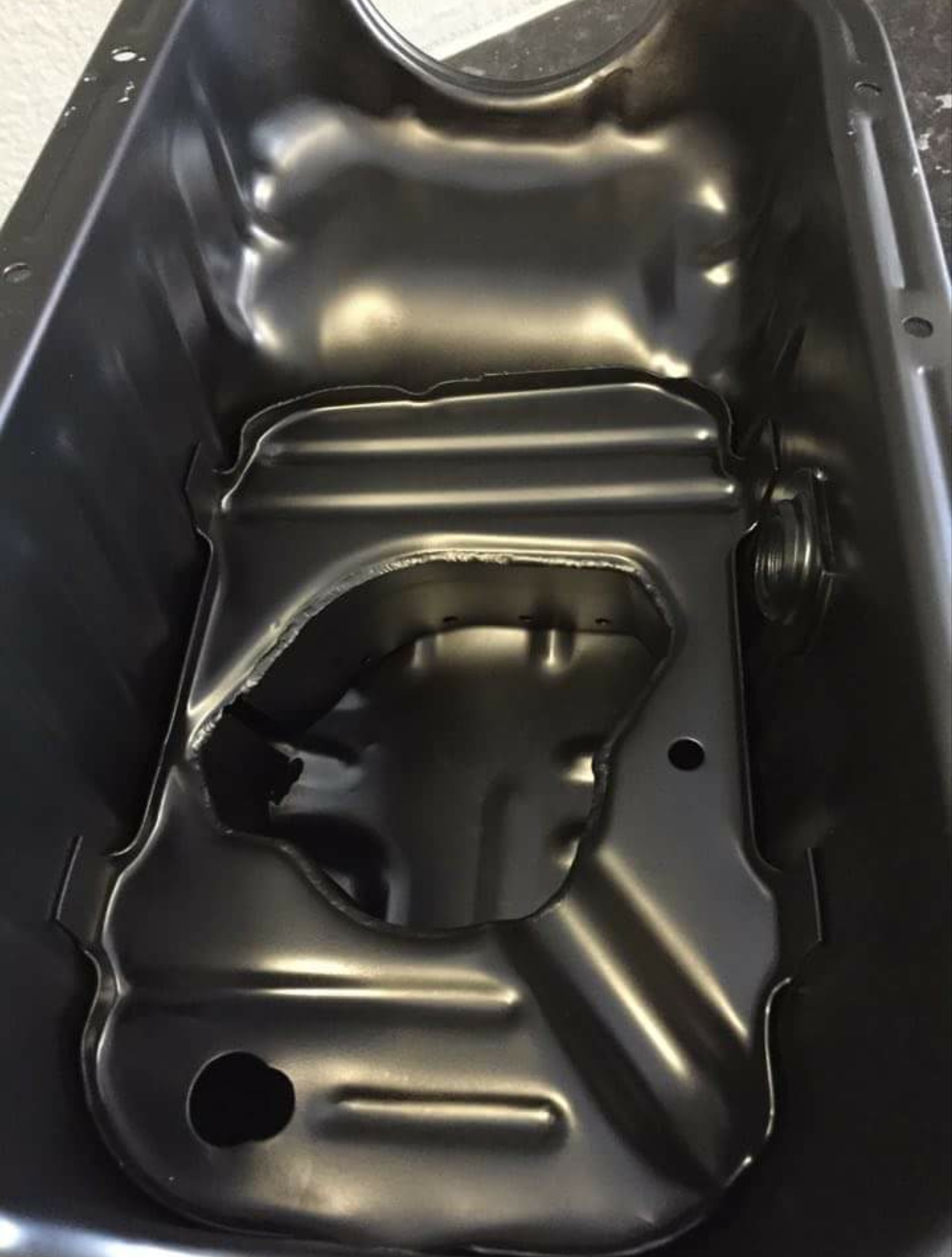

Mxdsnny Posted November 26, 2017 Author Posted November 26, 2017 I’ve taken my sump off to send off. And there a factory plate around the oil pick up. Does anyone have a picture of a sump after it’s been baffled? Just so I can picture what it looks like. Thanks Dan Quote
akyakapotter Posted November 26, 2017 Posted November 26, 2017 This is mine not a trap door one but dose the job brilliantly. Cheers nick Quote
Mxdsnny Posted November 26, 2017 Author Posted November 26, 2017 49 minutes ago, akyakapotter said: This is mine not a trap door one but dose the job brilliantly. Cheers nick Thanks, that’s nothing like what I imagined haha. Quote
