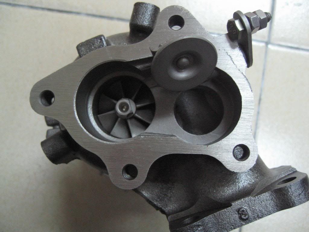

keirz Posted April 13, 2008 Posted April 13, 2008 basically when the turbo reaches its desired boost pressure the actator pulls the wastegate arm to open the wastegate (that is basically a hole) to divert the exhaust gases (which is what spins your turbo) out of the wastegate and away from the turbo blades, stopping the boost from rising past the desired amount. if the wastegate hole is too small the gases cant escape away from your turbo quick enough and so boost presure continues to rise.porting the wastegate is making that hole a little bigger to allow more gases to be diverted and so you get more controlled boost.sounds a little complicated but its not really. its the hole on the right mate
