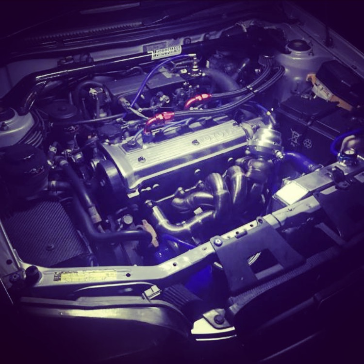

I'd move that fuel pressure regulator away from the king lead you'd be better off going to have progressive dyno runs it should run a smooth 1bar boost
