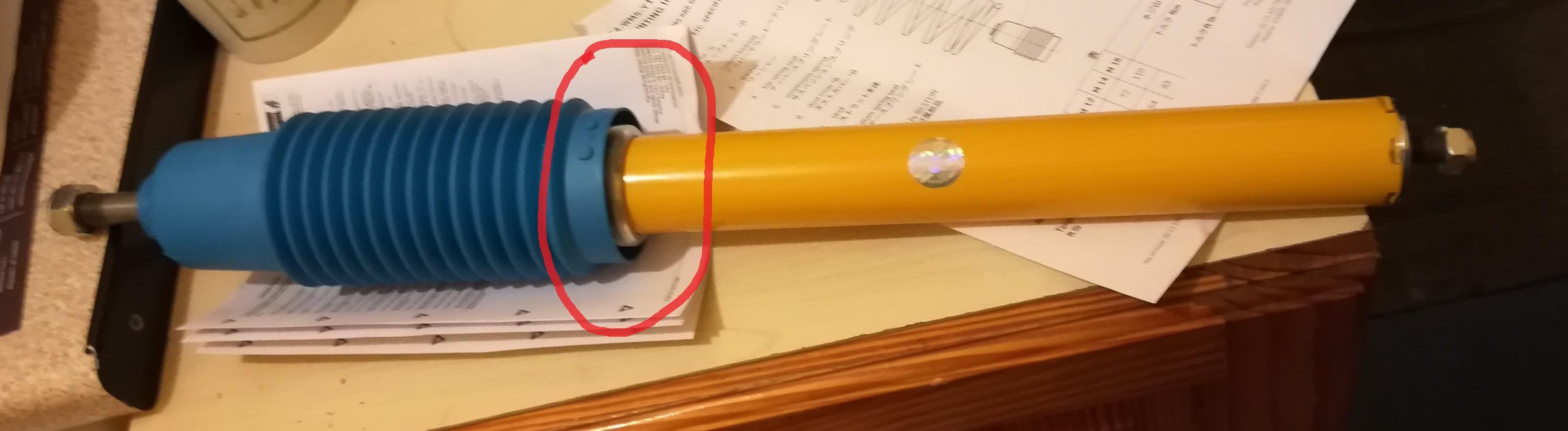

Hi all - I am trying to fit the Bilstein B6 Sport Shocks (P/N 34-050484) at the front of my EP91 (UK spec).
I know about cutting the top of oem struts and bolting at the bottom but the threaded ring on top of the insert which supposed to lock into cut oem tube is TOO BIG (SEE THE PHOTO).
Does anyone know how to fit this bloody thing?!?
The car is on the lift at the garage and even my mechanic is badly stuck with this...
THANKS IN ADVANCE!!!

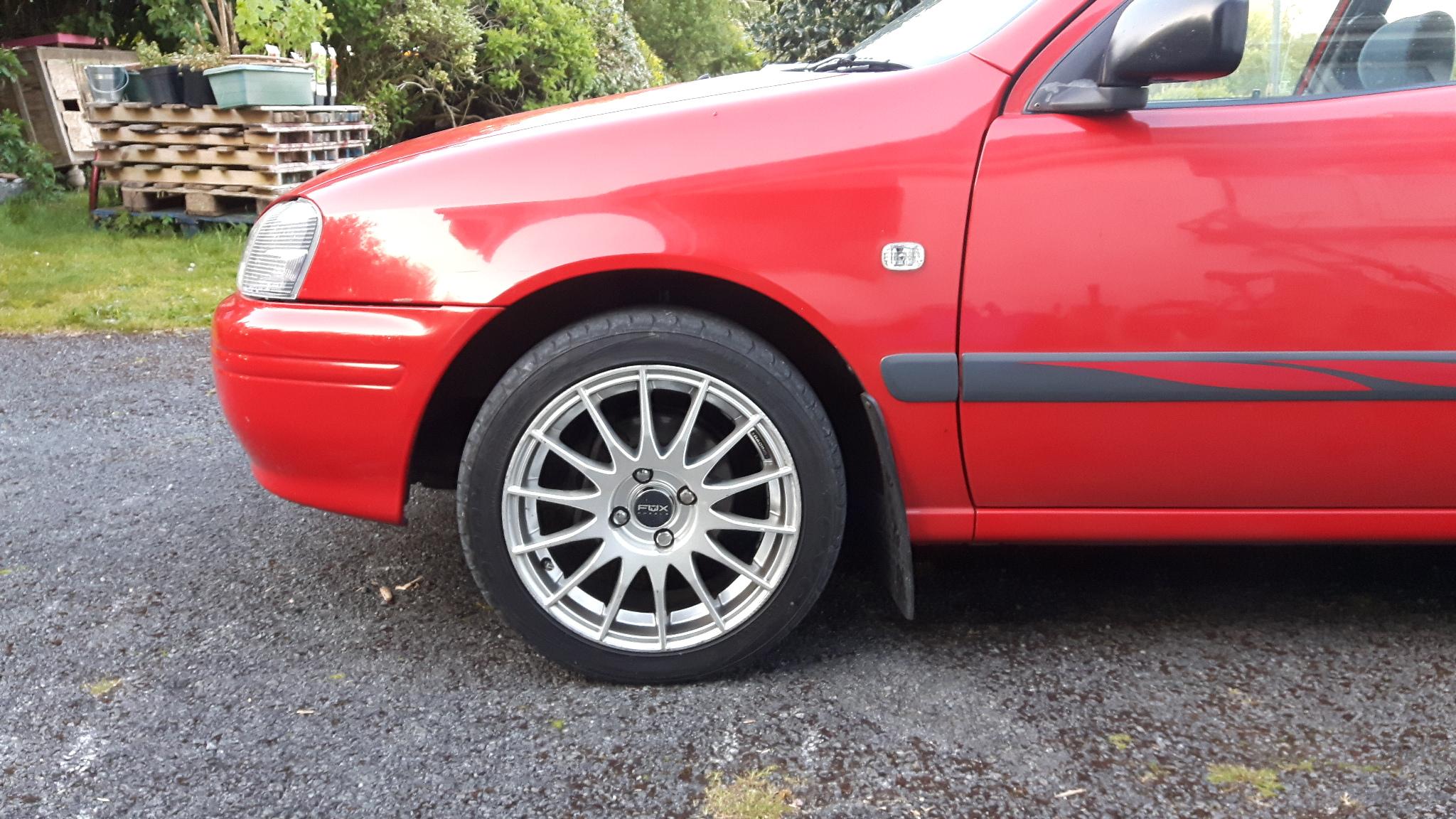

My front (on teins springs) looks ridiculously high on oem shocks (plus it bounces up on bumps) and I reckon sporty shocks is a must cure.

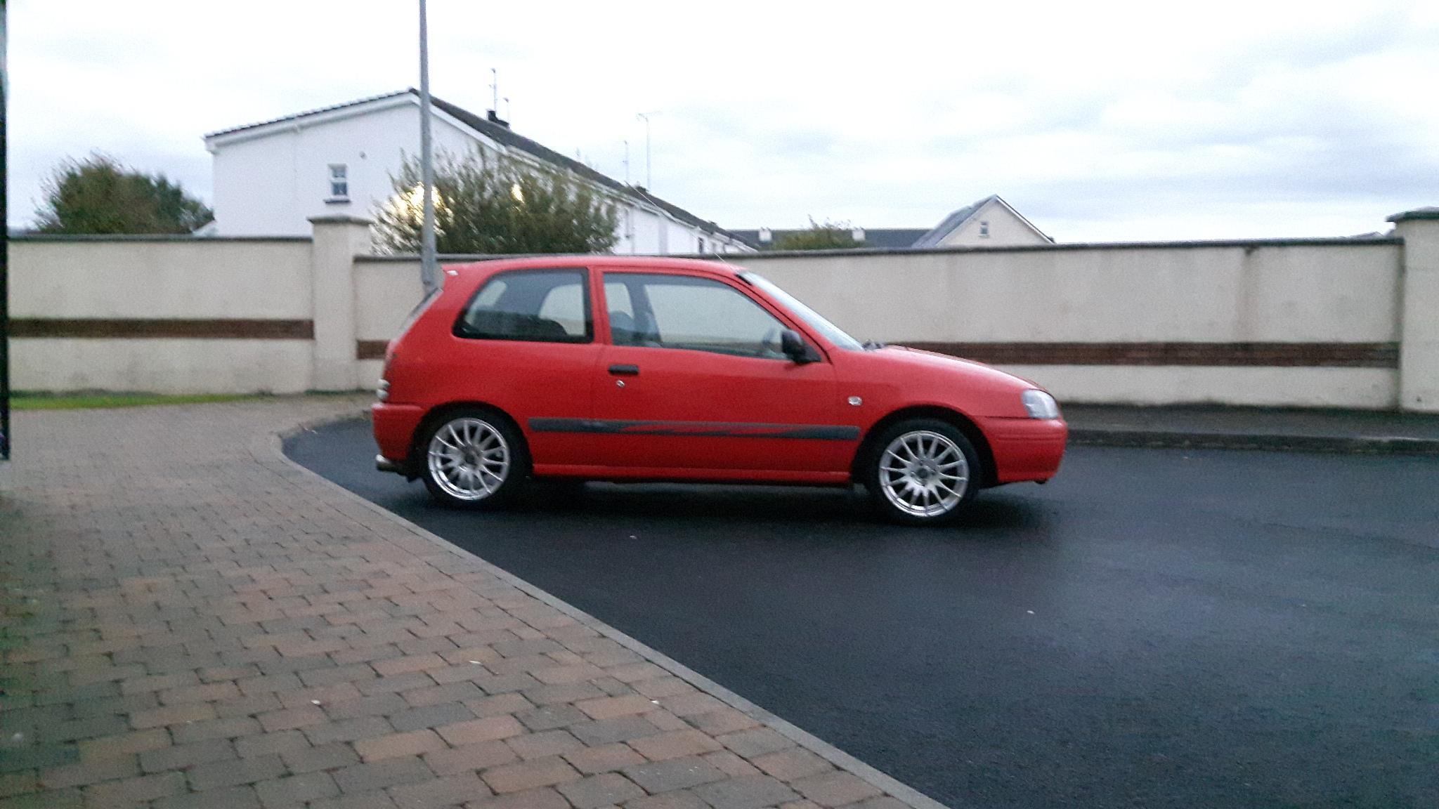

I need to go lower at front so don't want them SR special that's the problem...
After fitting tein springs (for EP91 not EP82!) it was a big disappointment in relation to the look of the car. The rear is low alright but the front is a joke. How the hell they describe them teins as 57mm lowering?!?
Other than that they're great springs, lovely soft comfortable handling and car not bouncy (except over bumps!) but the height being 20mm lower than oem?!? That's why I've decided to change the shocks as the last resort and am left now with these useless bilsteins wrrrrrrrr
