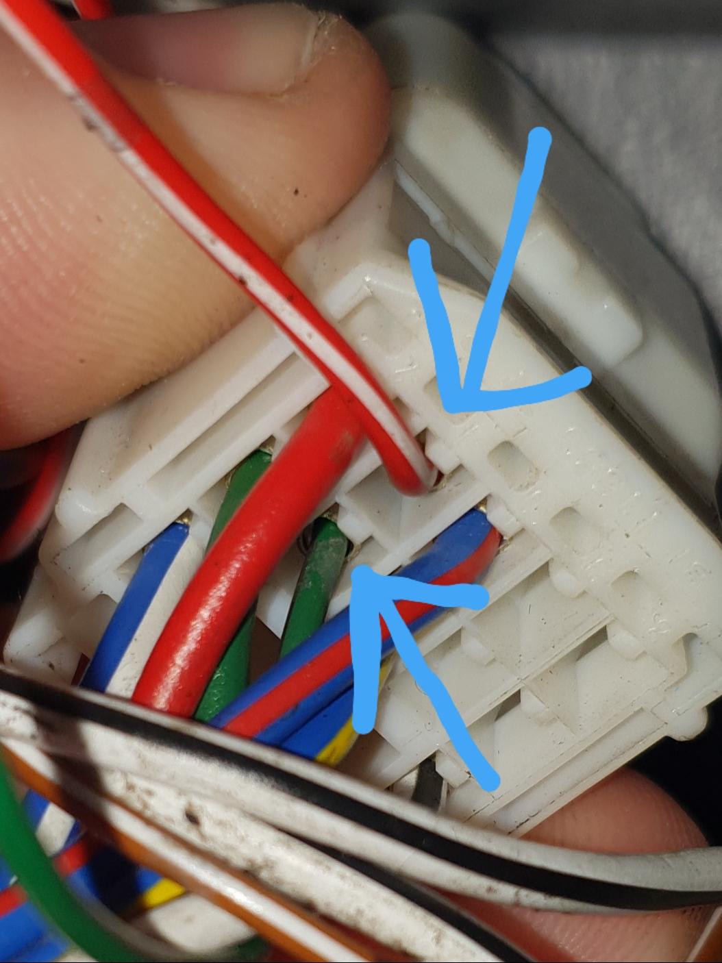

maddox710 Posted September 13, 2018 Posted September 13, 2018 Can anyone tell me pin outs on a 96 glanza for a universal remote locking kit. Really just the bit that controls the original locking? Quote
lukEp Posted September 13, 2018 Posted September 13, 2018 (edited) Wires coming from Drivers door through The "A" pillar behind the kick panel at accelerator pedal. Square white plug. IIRC small red and green wire they could possibly have a trace on them. I'll check soon. If you supply a neg to the wire it will lock or unlock depending on which wire. Edited September 13, 2018 by lukEp Quote
lukEp Posted September 13, 2018 Posted September 13, 2018 Red with a white trace Green with a black trace Quote
