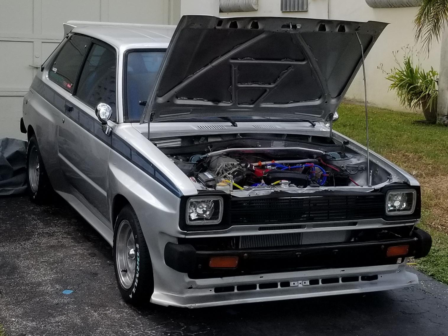

The KP60 starlet like above is 4 x114 but the EP70 , EP82 & EP91 are all 4 x100. Its a pain because there's so many nice 4 x114 wheels.

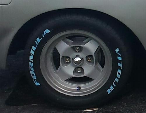

The wheels on the car right now are American Racing brand. Also from the 80s. In 13"
But they are the "oval hole" type. Meaning they fit both the 4x100 and 4x114.3......Just neither very well!
Unless you install them carefully and tighten each lug in increments, you'll end up going down the road with the steering wheel wobbling.
Too bad because I've found 245/50/13 and 205/50/13 tires that fit great.

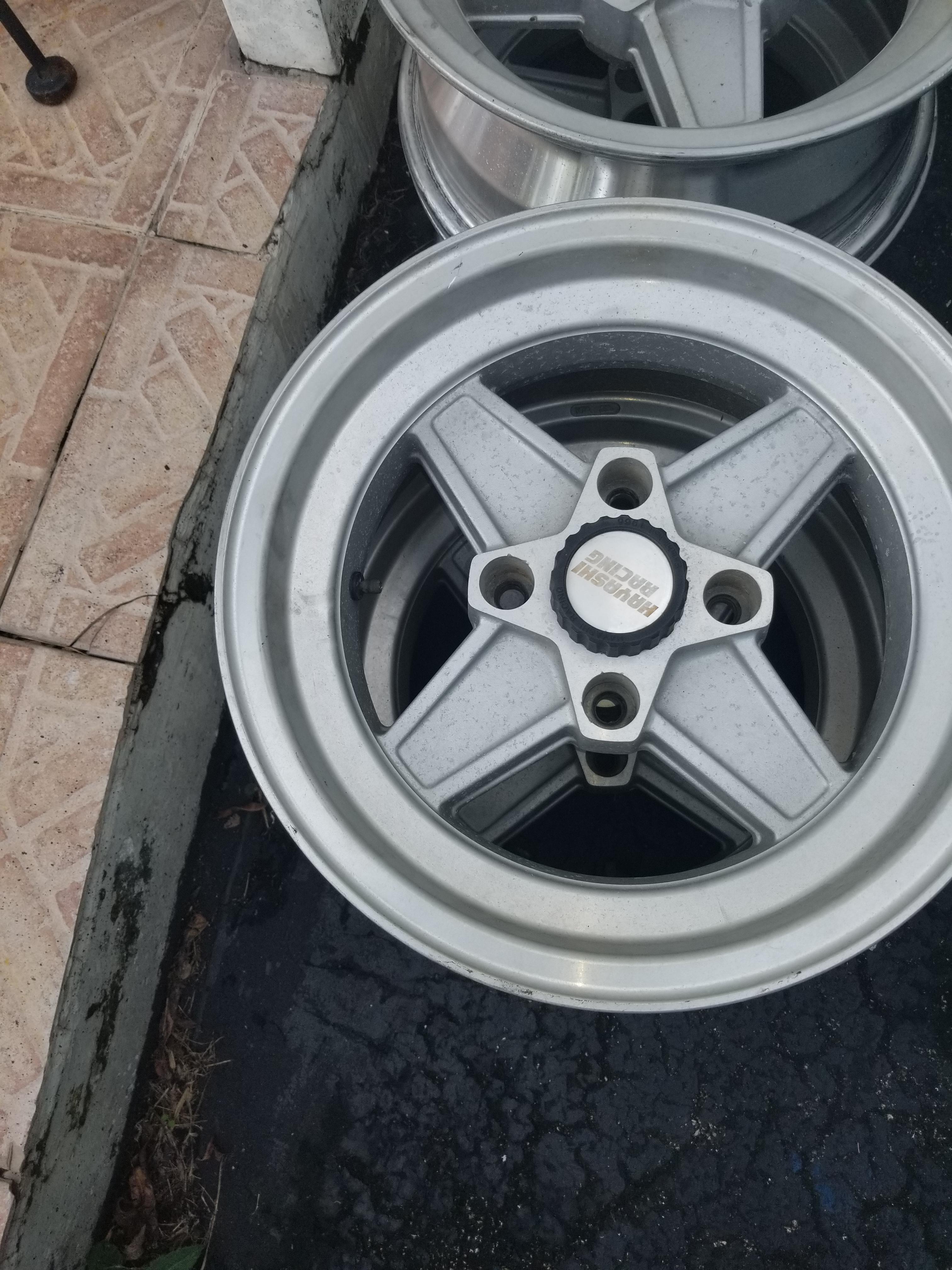

I'm just tired of the hassle. So I'm looking for something in a 50 or even 45 profile 14" tire now for the Hyashis.
Yep.
This is rear wheel drive
