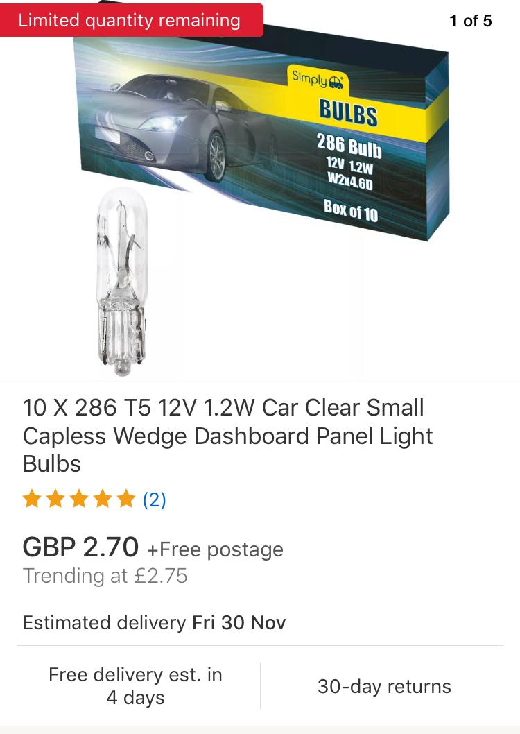

BenP_ep91SR Posted November 26, 2018 Author Posted November 26, 2018 I've looked for standard ones but can only find led? Can you change green plastic caps? Cheers Quote
5T4R7ET N/A Posted November 26, 2018 Posted November 26, 2018 (edited) The plastic caps are just for the colour, you will see what i mean when you get a bulb out there might be more than one size but i cant remember. Im sure someone on here will know i think they are t5 wedge bulbs? Might be a couple of some t10 as well. Cant remember. They are not expensive so just buy a couple just in case, if not needed, keep as spare bulbs for front sidelights Edited November 26, 2018 by 5T4R7ET N/A Quote
Farley V Posted December 1, 2018 Posted December 1, 2018 (edited) The most important thing I can recommend is buying the best quality bulbs for the clock lights i.e. Osram. I had a couple of experiences replacing the clock bulbs with basic brand bulbs and they lasted less than 6 months and then you have to redo it all again. The Osram's I've had in are years old and still good. Edited March 9, 2020 by Farley V Quote
BenP_ep91SR Posted December 1, 2018 Author Posted December 1, 2018 Good job I haven't bought any yet, was going to get lucas ones as the guy who works in parts at my garage would've ordered those. I'll check out the osrams, thanks Quote
Farley V Posted December 9, 2018 Posted December 9, 2018 (edited) Lucas bulbs are good, I have experience with them too. Those or Osram / Philips would be my choice. Not to knock the previous guy. I have tried those simply bulbs before in all sorts of bulb types. H7 h4 501 286 and they are poor. I mean they work for a short time, a few months, but have always gone pop. Edited March 9, 2020 by Farley V Quote
BenP_ep91SR Posted December 9, 2018 Author Posted December 9, 2018 Thanks bud, I've fitted some lucus 501s in there as it was just the Speedo that wasn't illuminating. It's much better now. Had a slight issue getting the cluster out due to the Speedo drive but all good now. Cheers again guys Quote
