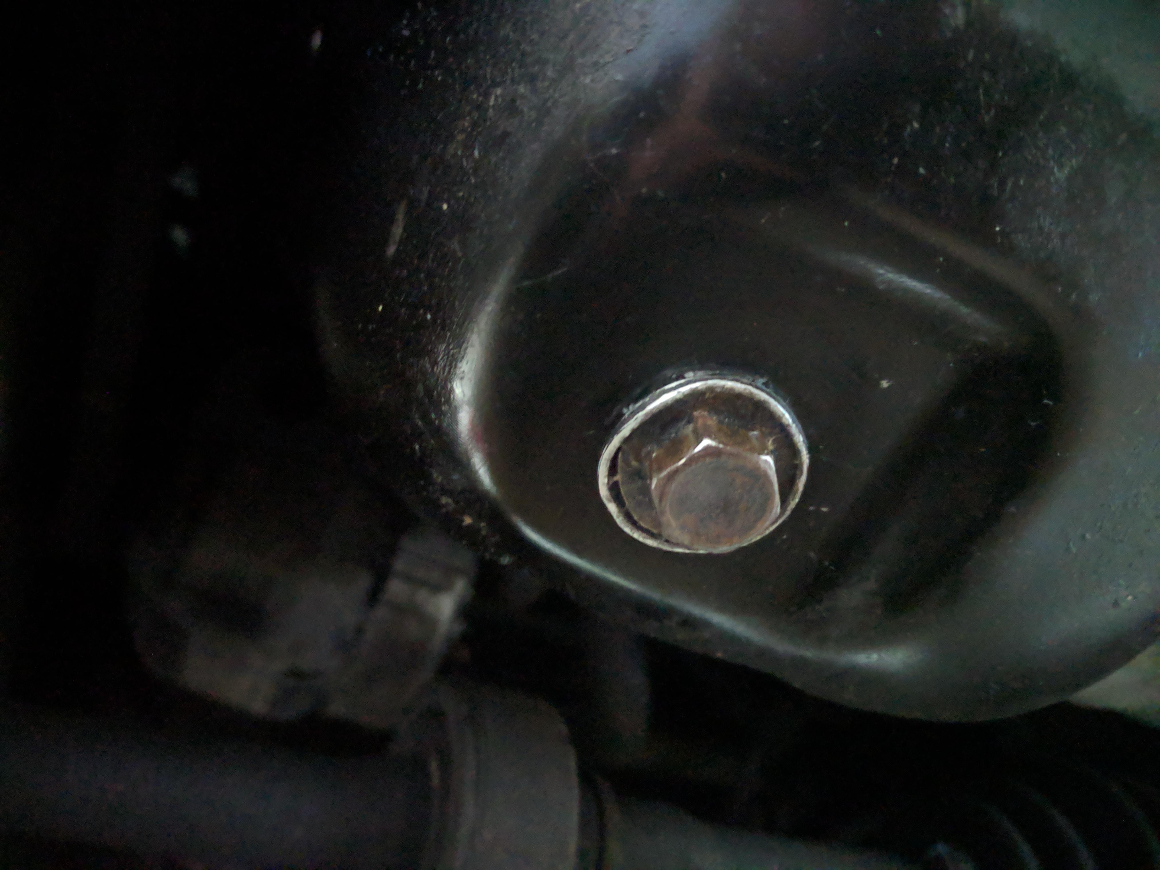

StarletJam Posted January 27, 2019 Posted January 27, 2019 Hi all, I am going to be doing an oil and filter change soon. Does anyone know what sort of washer is currently on my sump plug as shown below. The washer rim portudes around the sump plug. The new copper washer I am going to use is different. I also have the collapsible copper kind too - preference on which is best when I renew? Thanks Quote
T-dog Posted January 28, 2019 Posted January 28, 2019 If you go to your Toyota dealer they are like £1 or come free with a Toyota gen oil filter . They are black fibre washers . Toby Quote
StarletJam Posted February 3, 2019 Author Posted February 3, 2019 On 1/28/2019 at 6:10 PM, T-dog said: If you go to your Toyota dealer they are like £1 or come free with a Toyota gen oil filter . They are black fibre washers . Toby Thanks Toby, can I use the copper washer I have or are the fibre washers considered to be better? I have the below: Quote
T-dog Posted February 3, 2019 Posted February 3, 2019 No a cooper would be fine , but I always go gen parts as I’m weird like that lol Quote
Starlet__SR Posted February 3, 2019 Posted February 3, 2019 The genuine washer is a fibre coated aluminium washer. They work fine. Quote

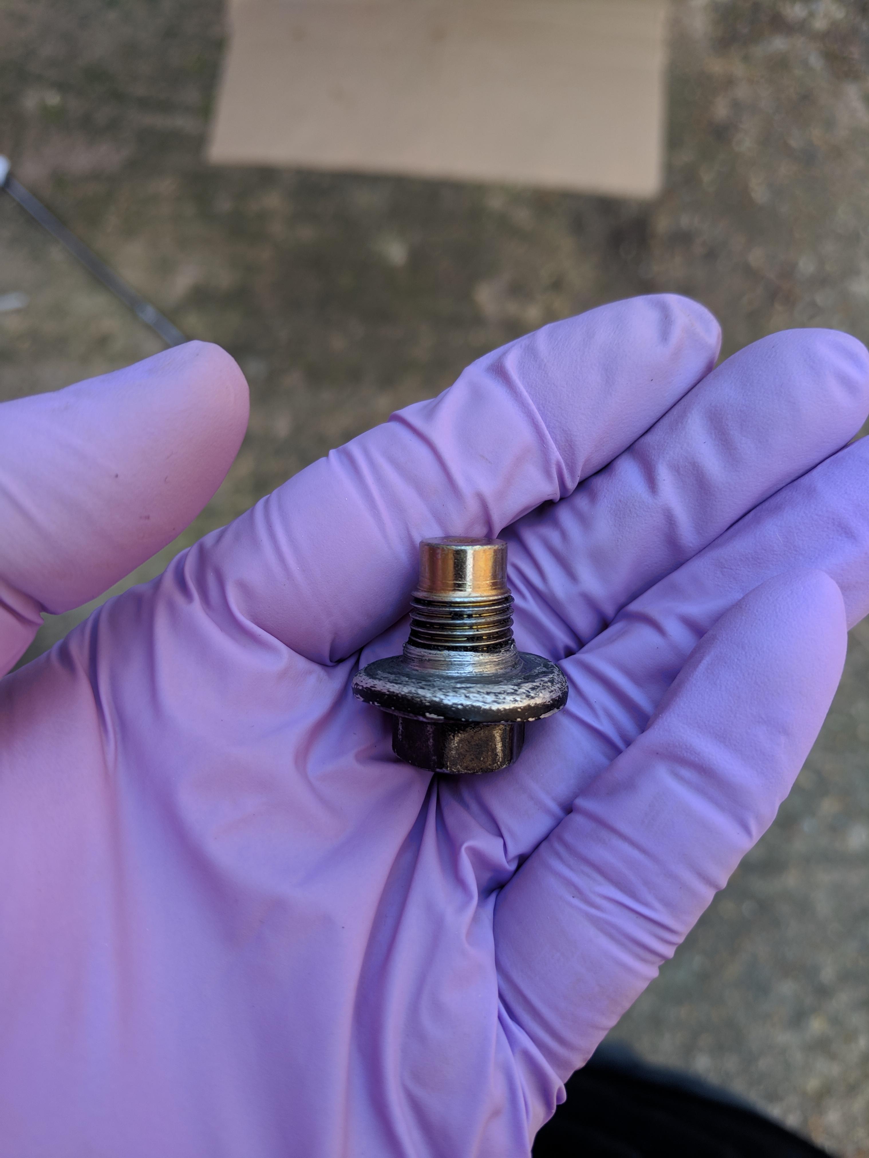

StarletJam Posted April 21, 2019 Author Posted April 21, 2019 Just an update, I finally got round to replacing oil and filter and when I removed the old sump plug this is what I found...bodge job or what. I'm thinking whoever did this threaded the threads in the sump pan which caused the plug to not screw in tightly. By adding this make-shift washer allowed the plug to screw in by not catching the threaded thread. Luckily the new plug had threads all the way to the end so I had no issue ensuring it was tightened properly. Quote
