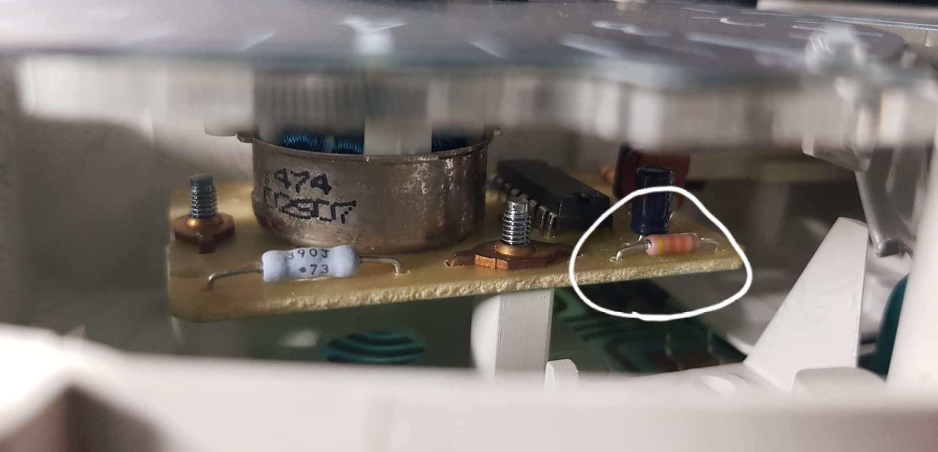

MegstuBMW Posted October 25, 2019 Posted October 25, 2019 Hi, I have 1997 statlet 4efe turbo project, installed megasquirt ecu, full sequential spark and fuel and because of that I removed original distributor internals, car is already tuned.. My problem is original tachometer, I can not make it work. Megasquirt has rpm wire for tacho, it is configured in software, but if I join wires, tacho doesn't work. Maybe someone knows what kind of signal wants original tacho? Quote
MegstuBMW Posted October 25, 2019 Author Posted October 25, 2019 34 minutes ago, RobSR said: Bypass the resistor on the IG- circuit Thank you for replay. Where can I find that resistor? Inside cluster? Quote

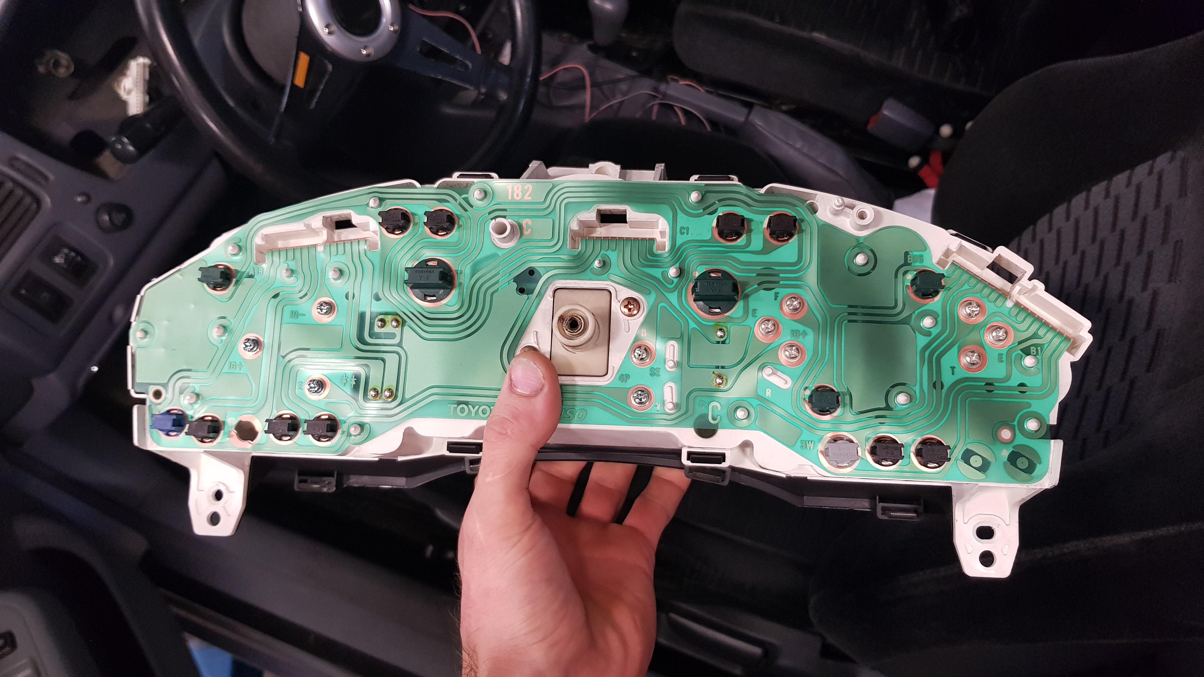

RobSR Posted October 26, 2019 Posted October 26, 2019 Yes that looks correct from memory as I don’t have one in front of me at the moment. You can remove the Tacho assembly and do it on the bench You then join the ecu to the IG- pin on the cluster Quote
MegstuBMW Posted October 26, 2019 Author Posted October 26, 2019 22 minutes ago, RobSR said: Yes that looks correct from memory as I don’t have one in front of me at the moment. You can remove the Tacho assembly and do it on the bench You then join the ecu to the IG- pin on the cluster Ok, I will try this. Thank you so much 🙂 ! Quote
MegstuBMW Posted May 31, 2020 Author Posted May 31, 2020 On 4/25/2020 at 6:48 PM, Ep71T said: Did that work out for you? Yes, just made jumper in place of resistor and it works Quote
